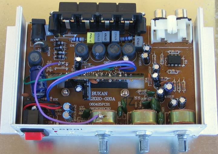

The new board appears to be of a higher quality than the photos posted earlier in this thread.
The old version had the chip sinked to the case while the new version has a heatsink attached to the chip. The new version also appears to have larger resistors (higher power rating), higher quality capacitors in some areas, and is missing some diodes. The opamp has a few small caps (by-pass?) added around it too.
Old version (from page 2 or 3 of this thread):
New version indeed does look better than the old one
My only concern is this generic, crappy op-amp (JRC stuff). This element seems not to be present in the other T-amps (SI, TA 10, AMP etc). Why Lepai design has it?
How do you think, what impact on a sound quality does it have? Is it worth trying to swap it out (possibly to LM4562NA?) or bypass it completely?
