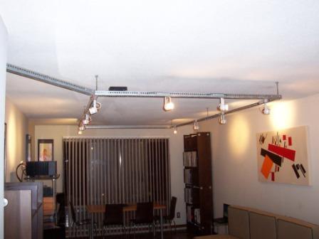

I am really exited about high power LEDs and I wanted to replace my existing halogens with them for quite some time.
What I have right now (see photo) is a system with 10 50W/12V halogen bulbs in SERIES. I have bought an ordinary 12V track lightning at Home Depot and gutted it by removing all inverters and connecting bulbs in series. I am feeding lights with 120AC and everything works perfectly for more then 10 years now. The main reason for removing switching AC inverters was my fear that low quality inverters will interfere with my audio system.
I am not complaining about 0.5KW dissipation, because my audio system dissipates similar amount of heat. :)
I have two questions:
1. Can I connect LEDs in series and drive them with linear constant current source? There is no need for me to drive each LED individually and it should not be difficult to build 40-50V/3A constant current power source.
2. What LED is the best (or approximate) equivalent to the 50W flood (wide angle) halogen? I really like cool (daylight) spectral temperature. I want just a light source LED like you guys showed on the photos, not the ready-made bulb. I hope to design the fixture myself.
Thanks a lot.
