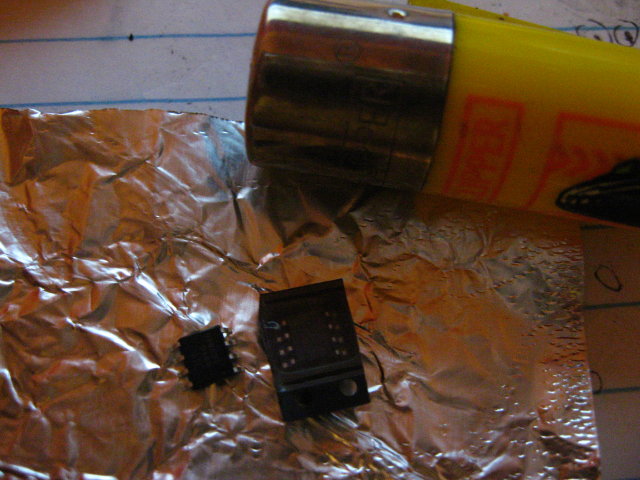

......... The one in the black packageing is the high dissipation one.
Have a look on the manufacturer's site for the datasheet, AN75 application note, and the excel sheet calculator (saves all the math stuff)...
