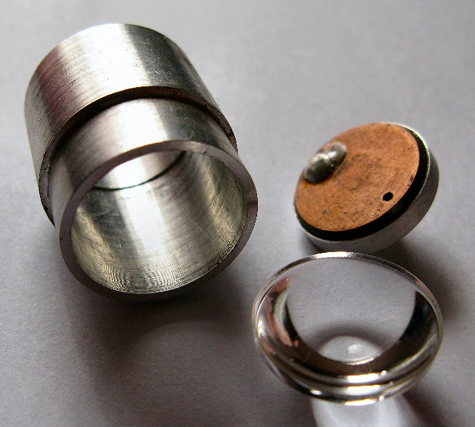

3W led bulb, not wort it, buy some candles.
Oh, I don't know, 3W makes not a bad flashlight.
Some bits I made a couple of years ago for an experimental aspheric lens flashlight with Seoul Semi LEDs:-

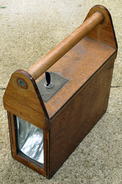

I've been into portable lighting for a while. Here's a lantern I built about 20 years ago. It uses NiCads and a 55W Auto bulb and reflector. With the plain glass it's about as tight a beam you can get short of a laser. There's a second 5W bulb offcentre for spread light. A wall wart inside is used for charging. Still going strong on the original 12 4AH batteries. It's waterproof, chuck it in and it floats handle up. Eventually it'll become worthwhile to build an LED replacement.
