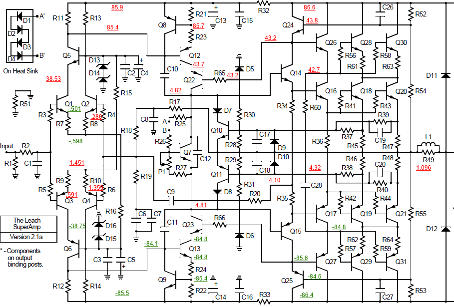

The devices showed up today and I had enough of the other transistors so I replaced all of them. I didn't match anything since I haven't a clue what I did with the circuit I built to test them. It will play a pretty clean signal at the output but there are still some issues. Still seeing about a 10V difference between the collectors of Q12 and Q13. If I check the + side of the circuit I follow a clean signal all the way to the end but the - side has a couple places where I lose it. Seeing about 2V offset on the output. I want to go over all the traces again tomorrow and make sure I don't have any breaks, cold joints or bridges. Once I do that I will post all the voltages and see if we can finally get to bottom of it. Getting real close now.
Oh, I almost forgot. One thing it is doing that is really weird. I am powering it up on a Variac. It will start producing a clean signal at about 30V rails. Stays pretty stable until about 77V. Any higher and it will all of a sudden go to about 66VCD on the output. If I back it down to 75V rails it will stabilize and the output will drop back down to about 2V offset and the signal will come back.

Yes I know 2v is too much. That is why I am still working at it.
No, I don't have any extra boards. I etched these when I first got in the hobby. I doubt I have the equipment and materials to do another.
Check whether NPN is NPN and PNP is PNP
What is the voltage drop across R11 and R12.
Gajanan Phadte
I tried to be very careful as I installed the new devices. I'm pretty sure they are all correct. Voltage drop across R11 is .5V and across R12 is .6V.
Have you checked the voltages across all the output stage resistors?
Thanks for stopping by Andrew. Please continue to help here. I need all the eyes I can get. The output stage is not in the circuit at the present.
I was able to get the board to run at full rails so I took some fresh measurements. Please look at the attachment. Everything looks reasonably close until you get to the collectors of Q12 & Q13 It all kind of falls apart after that. Perhaps one of you can help me understand why there is 43.7V on the collector of Q12 and -84.8V on Q13. I used two different colors to hopefully help distinguish between the + and - readings.

BJT amplifiers work with current.
I require voltage drops across resistors (= current) for all the output stage resistors.
Remember I said you can operate without the final stage if you connect up the open circuit NFB.
Please give me the resistor numbers you need. I will be happy to measure them. Remember, Q18, 19 , 20, 21, 28, 29, 30 & 31 are not hooked up yet. Q7 is shorted and the Emitters from Q16 & Q17 are connected to the output. R61-64 are also not in the circuit.
I checked R52-55. They are all 6.2K and hooked up. For kicks, I lifted the bases on Q24 and Q25. The four resistors now all have the same voltage drop across each.Just looking at your latest voltage readings, it looks like R55 is either open or the wrong value. The lower half output stage is not dividing the voltage properly. The amp may operate this way, but not safely under load.
Here is a question. Could the +4.81V on the collector of Q23 be causing the high voltage on the Q23E/Q13C junction? Q13 collector and emitter are the same. I pulled Q13 and it tests fine.
Q12 has a .3V difference between Emitter and base and a 42V drop at the collector.
Q13 has a .7V difference between emitter and base and no drop at the collector.
I tested the circuit with Q13 removed and I still see almost rail voltage at Q23 collector so it is not coming from the base of Q23 and not from Q13. The base of Q23 actually measures higher than the collector.

Eureka! By Jove, I think I've got it!
I spent today pulling one transistor at a time and powering it up a taking measurements. No matter what I did, I couldn't get rid of the high voltage. Finally I sat with a pointed probe and for the 10th time went around every single trace and scratched a clear path. Well there must have been a tiny little solder bridge somewhere because at last it powered up clean and the two sides balance with each other. Offset at the output is mere 7mv. So I got brave and soldered up the power transistors and brought it up slowly on the Variac. .357V across the 100 ohm safety resistors and 11mv offset.
I hooked up the scope and see a perfect sine wave at the output. So I got brave and hooked up an 8ohm speaker and brought the sine wave generator up slowly. Clear sound but the safety resistor started smoking so I had to back it down.
