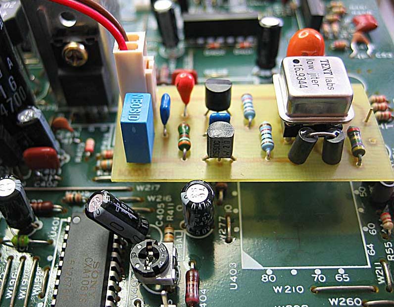

Whatever people say, I use a sufficiently large decoupling cap to achieve the lowest noise I can reach. Certainly not a 1 or 10 uF cap!!
-------------------------------------------------------------------------------Guido Tent said:
I never listened to that one
The indicated 10nV/SqrrtHz at least is way better that what comes out of most other regs, which is what I confirmed
By the way, if I calculate the noise from the datasheet, I come to 63 nV - way off from what Fred achieved

Guido, with your XO clock, you send your customers a Word document (you sent me that doc too) with this on it:
"Cuno Snoeren has designed a good example of such a supply, where all recommendations have found their place. It is shown below."
And...
"To supply this regulator a separate transformer may be used, to obtain maximum performance."
The suggested PSU for your XO clock, present on this doc, is a TL431+BC550.
What gives?

You run too fast
Cuno's circuit is a nice circuit that can be build by many people, it is DIY.
Another issue is what circuit is best in my opinion, and what is best for DIY versus commercial use.
I went over to the RC filtered emitter follower style as it is still easy and offers lower noise compared to Cuno's circuit.

So now all of the sudden Cuno's circuit is nice. And before you were grumping about the 431-based rubbish.......Well, well......

By the time it was a nice circuit. I and others learned in the last 4 years. 431 based circuits can be improved by the way, but will never achieve the low noise level that I like to have for best performance.
You see to ignore that it is offered as a good starting point for the true DIY clock builder - what is wrong with that ?
