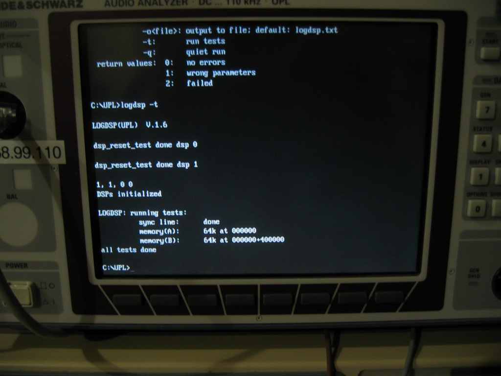

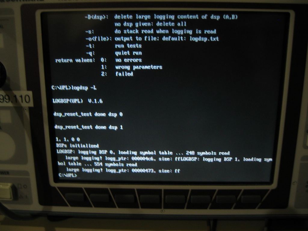

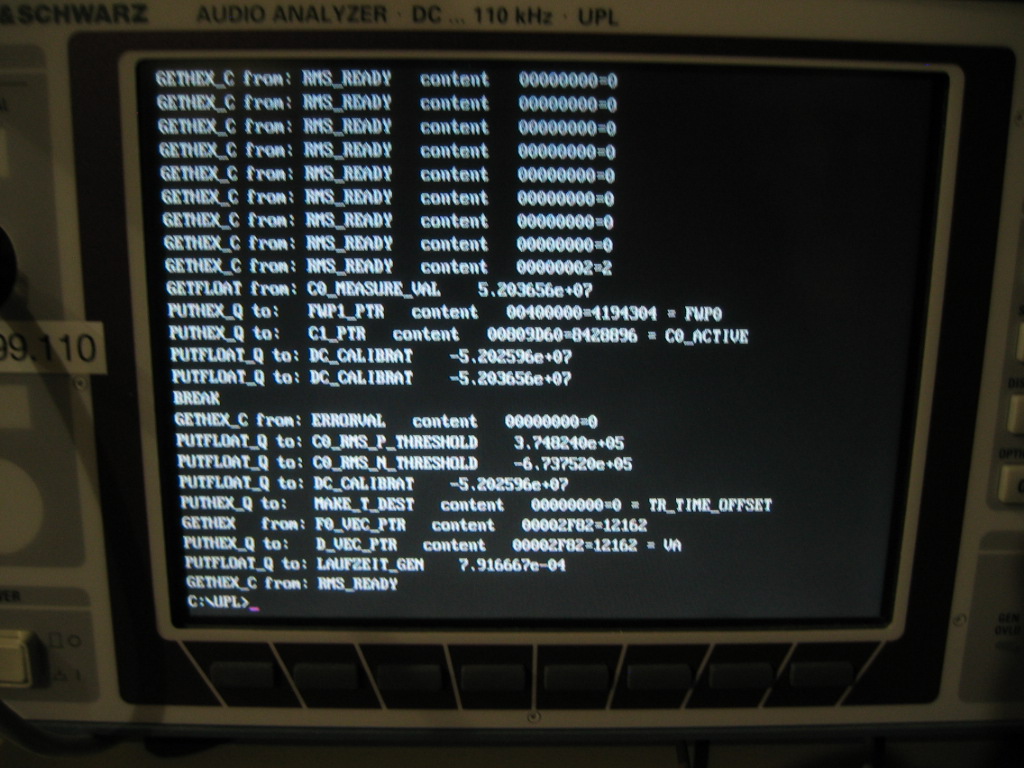

Fortunately my UPL is working ok. However today I tried to find out what kind of diagnostic tools / test programs are available. I found two.
selftest.bas
Not documented but results are self explaining.
logdsp.exe
Readme file says about this one: LOGDSP.EXE: debugtool (R&S use only)
This starts from dos prompt and something can be figured out from programs short help.
I wish success with your fault finding.

Thanks for reminding me about the BASIC diagnostic files. I had completely forgotten how to find them and run them. Had run the diagnostic when I first bought the UPL, but have since forgotten about it. This jogs my memory.
Been dealing with a plumbing emergency all day. Hopefully I can resume productive work tomorrow.
I ran the selftest.bas file today. It got as far as reporting the options installed, and did not proceed any further.
I am hoping that the Analyzer functions are inhibited because of the generator fault and that when I fix the generator section, the Analyzer will also return to operation. If not, then I have two separate failures to deal with.
