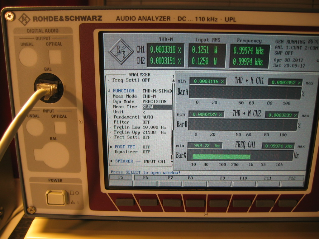

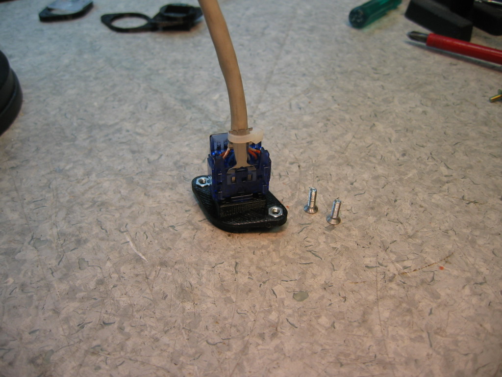

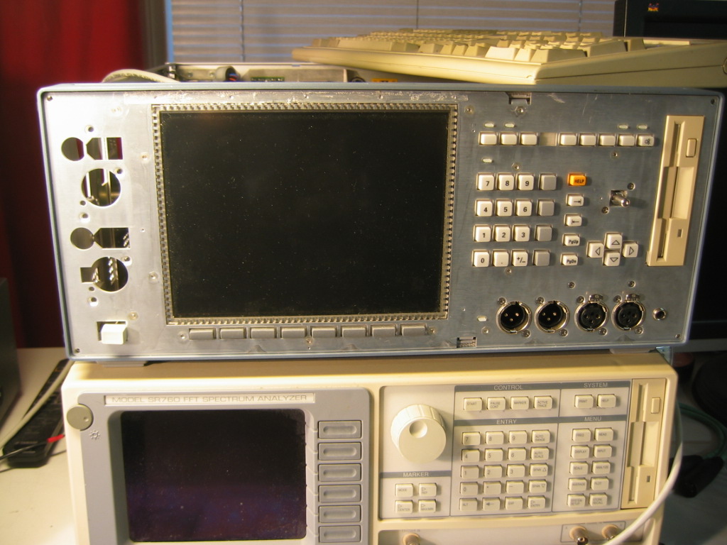

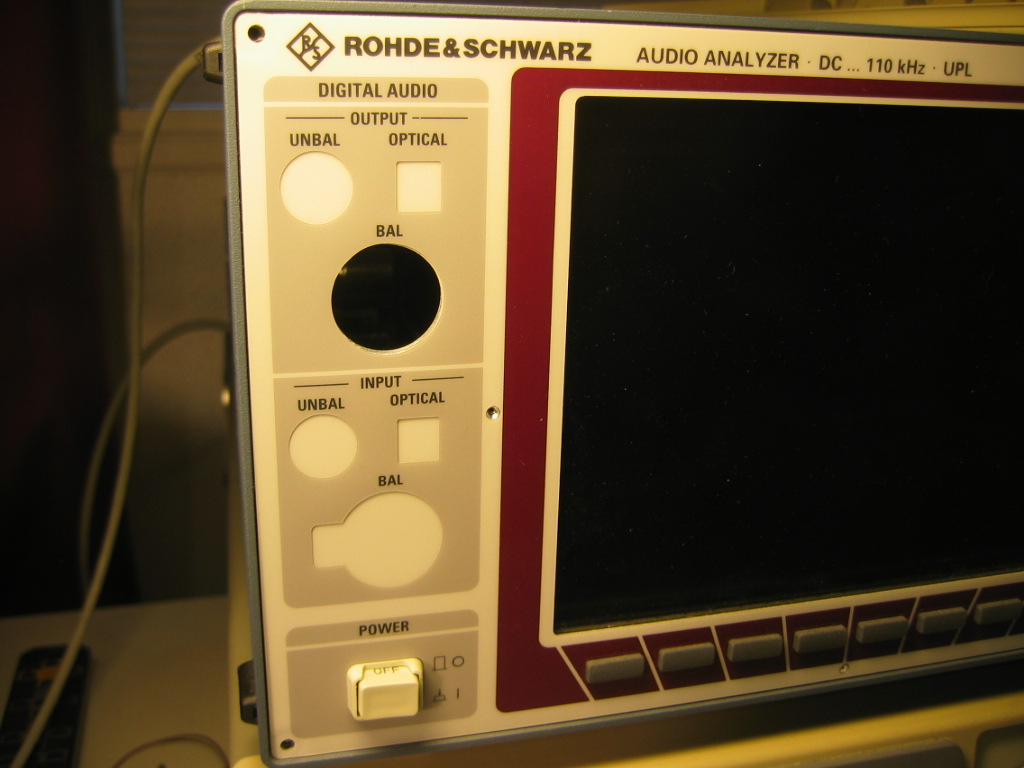

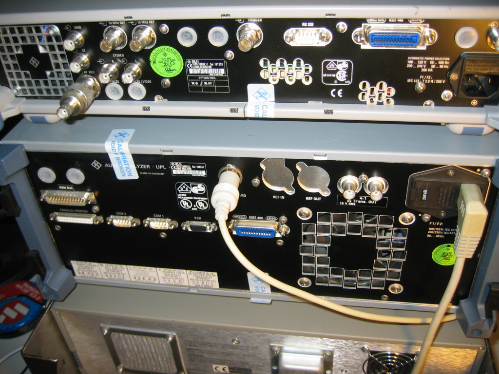

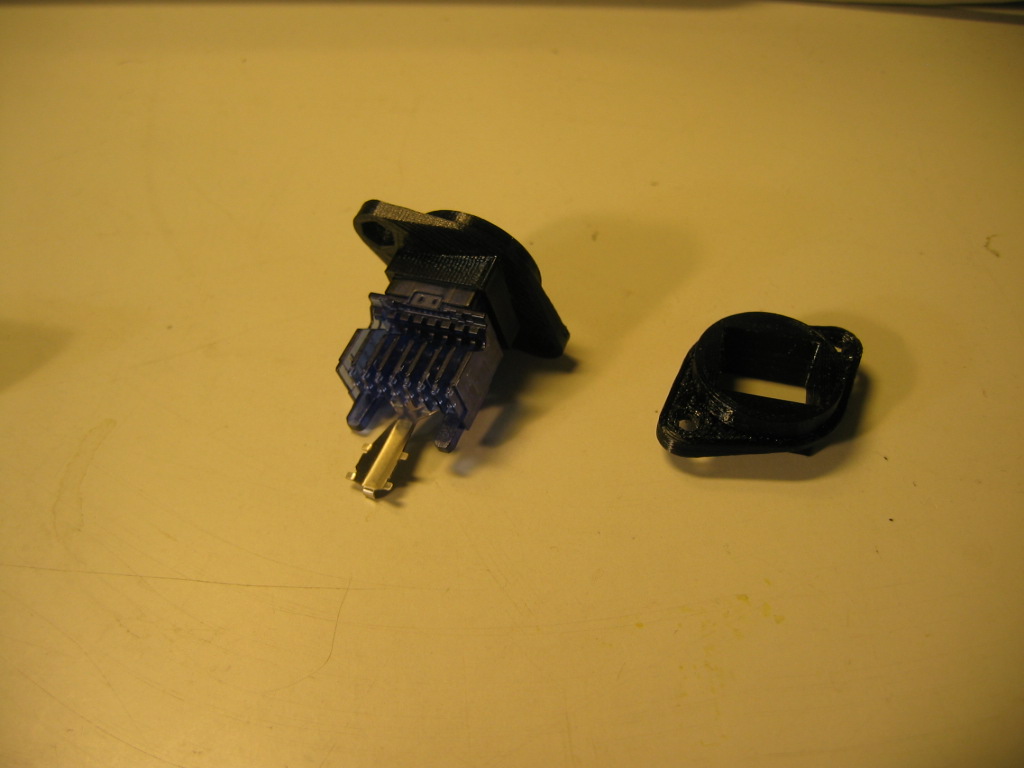

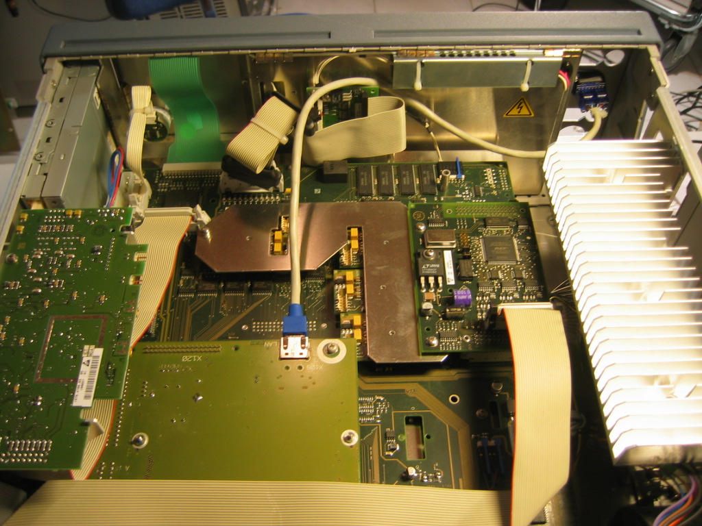

UPL external Ethernet connector
Final step was to implement external connector for the Ethernet. I do not have digital audio option in my box. There are several connector holes reserved for this option covered just with plastic sheet. My brother kindly 3D printed adapter for the RJ45 jack. Better place would have been in the back side but available spare holes are at front side. Have to live with this. Pictures tells rest of the story.
1) Neutrik has RJ45's in that pattern if you need them.
2) There were some ancient DOS multi-tasking proram environments and maybe you can run the network suite as a "terminate and stay resident" "TSR" program. if its really from the dos world it may be possible. Also which version of DOS is it running? Will it run DOS 4.0 multitask or even 8.0? https://en.wikipedia.org/wiki/MS-DOS#Versions .
Really ambitious would be running the analyzer in a dos window on Win 10?
Thank you for the comments.
Of cource I have used them if it have been possible but unfortunately in my UPL all rear panel XLR holes are in use. Ref In/Out may look free but another installed option block them.
Yes I understan what you mean. LAN workstation agents behave jus as you explained. However I wanted to disturb UPL application as little as possible and choose different approach. When UPL is running I do not have any "foreing" software components loaded or running. Packet driver and FTP server can be easily loaded when neded and more important feature is that they also can be unloaded before UPL restart. LAN workstation SW and drivers are more difficult stop and clean from the memory.
This is one way to do the measurement results transfer and UPL HDD maintenance. I am interested to hear experiences about other implementations.
