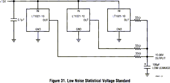

I agree that part of the beneficial effects are probably from reduction of peak charging current. The reverse recovery voltage is a function of the peak forward current of a rectifier. Dividing the charging currents equally between multiple caps seems to me to be a good idea for the standpoint of reliability and in terms of distortion and changing of capacitor ESR with heating. Resistances between the filter caps and a film bypass seem to be a good idea from the standpoint lowering the q of the resonant circuit from inductance of the filter caps and wiring or PCB inductance and the high Q film cap. Capacitor Q in circuit is becoming more important as capacitor ESR for electrolytics approaches a few milliohms. Filter capacitor noise voltages are reduced by averaging in a similar manner to paralleling voltage reference for lowest noise. This looks more like egineering than voodoo to me.To paraphrase the old joke, we know what it is and are merely quibbling over how much.
http://www.evox-rifa.com/europe/electrolytic_life_factors.htm

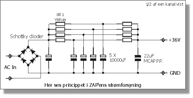

To me looking at the circuit given by Lars is a standard rectifier bridge/capacitor supply feeding each of four capacitors via 0.1 ohm resistors.
The first capacitor is subject to the usual ringing excitations caused by the secondary inductance/capacitance values and diode switching behaviours.
The next stage is four RC shunt (damping/snubber) networks supplied in parallel, and each of these individual RC networks infact has the other three networks as additional RC networks.
The final four resistors and 22uF PP capacitor constitute further high frequency damping of the supply system.
All of these snubbing networks also constitute dampers for energy returning from reactive loads.
The series resistors will of course cause voltage drooping proportional to load current, but the resistor values shown would cause 1V drop at 20 Amperes and not any real issue - correct me if I am wrong.
This constitutes a pretty low, but not infinitely low impedence supply, that should have no ringing components caused by rectifier pulses, nor load variations nor load reflections.
For the sake of eight resistors in addition to the normal capacitance (except divided between five capacitors), this looks to me to be an effective way of building a totally non-resonant supply, and in my experience a 'quiet' supply pays very nice subjective sonic dividends in terms of clearness, control and non-reactiveness and harshnesses.
I have tried a standard supply with a same value capacitor and sub 1 ohm series resistor in parallel to provide damping/snubbing and this gave good result.
I expect Lars' more extensive solution is an exceptionally good one.
Nelson is correct in what he has measured, but this is not looking for supply resonances, and in any case this is probably of much less importance with his class A amplifiers.
Thinking about it, the output stage and speaker load constitute damping for a conventional supply, and this probably is a large part of class A subjective sound.
Eric.

Hi Frank....and Nelson........
I beg to differ that these are not quite the same thing.......
Directly paralleled capacitors do not have external damping between them, and are free to interact according to the parasitic characteristics of each.
This interaction can cause supply/circuit/load resonances that may or may not be present all the time, and may be transiently triggered by supply or circuit or load characteristics/parasitics, or all three.
Nelson is correct in that the first resistors constitute RC rolloff of secondary/rectifier (transient) excitation currents, but there is nothing to damp oscillations between the individual capacitors, and between the capacitors and the circuit and circuit load.
Lars' version pays attention to this, and this is what I am giving due credit for.
