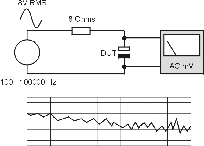

A sweep test like this can give you a good qualitative assessment of a capacitor's sonic performance. Even in just one single capacitor there are large amounts of resonances, also in the audioband. With several caps in parallel, the resonances explode.

(Note the graphic below is drawn for illustrative purposes, not an actual measurement).

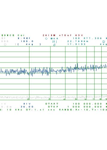

"These curves should speak for themselves."
I guess they will have to with no scales or explanation. I have no idea of what I am looking at. Tell us the test conditions and the range and units of the X and Y graph axis. Volts? dBm? Hz? furlongs per fortnight? What exactly are we looking at.....
Resonance?????
I don't see no stinking resonances.
Next time, try measuring the magnitude AND phase of the DUT, and showing the results in a polar plot.
And it might help to put a DC bias on a polarised cap.
What you claim to be a resonance on your drawing looks like noise, and the plots are not any more convincing. What exactly is is trying to illustrate?

Yes, all caps have a self-resonant frequency, but this does not seem to be what you are trying to porve.

Christer: My remark about 'Interesting Reaction Pattern' is related to the fact that a few guys in here have the habit of changing the subject towards Hamburgers, yellow cars or whatever, when they can't think of something better to say.
My point is that capacitors have resonances, and paralleling capacitors directly will allow these resonances to increase significantly. The resonances are interactions of one capacitors's capacitive part with other's inductive parts, or what i have called Current Woppling. Maybe somebody dislike this word, and certainly some people in here also dislike the effect all together. But it's there, even for the people who are in denial of either its existance or significance.
So presenting evidence that my claim of current woppling is NOT 'mostly crap', as someone in this thread want to impress.

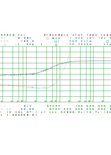

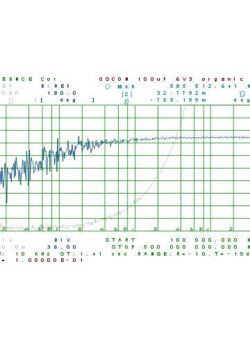

Now to an explanation of the curves:
The BLUE curve is the phase of the capacitor, 0deg. in the bottom, 180 deg. in the top, 36 deg. per div.
The GREY curve is the impedance 0 Ohm at the bottom, 1 Ohm at the top. The frequency span of this measurement is from 100 Hz to 5.000.000 Hz except for the 'normal 470uF cap' it spans in a higher resolution from 100.000 Hz to 1.000.000 Hz i'm sorry i don't have the same freq. span for that one like the other two. But i think the resonances are obvious just the same.
Anybody who is reading this thread can repeat the impedance part of this measurement using the simple setup presented earlier in the thread, and see for himself whether my claims concerning current woppling hold up or not.

I see the series inductance of two of the test caps (at RF frequencies), but other than that, I don't see any "resonances" there, just baseline noise. The "normal" cap shows zip below a megahertz, other than the same pretty random looking baseline noise. Could you explain to me what I'm missing?
Lars Clausen said:SY: Well maybe your 'Random Noise' is not just hiss from the input amplifier. Maybe it reveals that the capacitor has shifting phase response at shifting frequencies. In other words : Resonances.
Lars,
I hate to say it, but that looks like noise to me too. I've measured the impedance of capacitors from audio frequencies, to several gigahertz all kinds. Any time I got a measurement like that it was either due to:
1. The impedance was too low for the meter to accurately measure. (Not paying attention to the dyanmic range of the instrument.)
2. The impedance was too high for the meter to accurately measure. (Not paying attention to the dyanmic range of the instrument.)
3. Bad connection.
4. Noisy signal generator.
Without knowing the makes, models and wiring of all of the instruments/dut in the test then it's hard to gain anything from the caps you posted.
