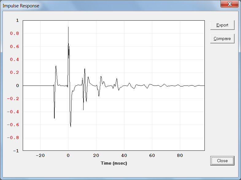

Hi Chris,
You are quite correct.
The attached screenprint shows the impulse response for a three-segment tapped horn with L23 = 344 cm. The initial negative spike (amplitude -0.5) is generated by the rear side of the driver near the horn mouth, and the later large positive spike (amplitude +0.9) is generated by the front side of the driver near the horn throat. As expected from the theory, the delay between the two spikes is 10 msec.
Delay = L23 / c = 3.44 / 344 * 1000 = 10 msec.

David, thanks for your response. It hadn't occurred to me to run an impulse simulation. I'll have a play around and see what can be found.
Cheers
Chris

Again, I'm a bit out of my comfort zone here, I don't spend a lot of time looking at and comparing impulse graphs. So I took some time to do just that.
That's 3 different designs shown with and without a mouth side tap. Each shown as a schematic with the resulting impulse behavior beside it.
Design 1 is the one I've been using here previously.
Design 2 is a popular diy design. (Shown mainly because I found something weird with this one.
Design 3 is the same as #2 but 8x larger and with 8x more drivers.
First note - up until the first really large positive spike (the second positive spike in each case) the impulse response looks very much alike whether there is a mouth side tap or not. Compare the two different (tapped and untapped) results of each design and the impulse response isn't perfectly identical but it is very very close.
The only way I could get an initial positive spike (instead of an initial negative spike) was to show only the line response. As soon as you show the combined response (line and driver combined) with any of the non tapped designs, the impulse has the same shape as the tapped equivalent.
Second note - impulse start times are confusing to me. In design 1 (both tapped and untapped) impulse starts at 0. In design 2 the tapped impulse starts at around -10 but the non tapped impulse starts at 0. In design 3 both the tapped and non tapped impulses start at around -10. This seems weird, maybe I just need to study a bit more about what the impulse is trying to tell me but I'd appreciate an explanation if you have one.
Anyway, disregarding impulse start times, the shape of the impulse graphs (positive vs negative) seems to be the same regardless of whether a line is tapped or not. So the initial negative spike does not seem to be generated by the rear side of the driver by the horn mouth as you said in this quote, since this behavior is also seen in non tapped lines as well.

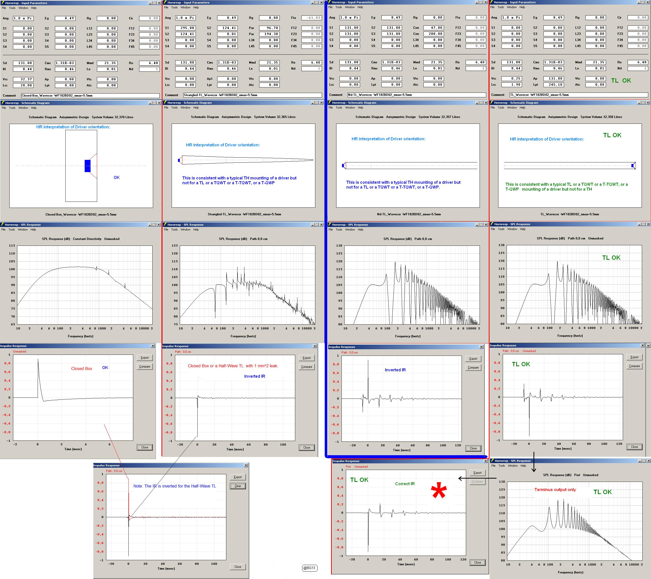

I'm not sure what you are talking about, the driver is always facing the same way. Look at the pics in post 71. In each case (regardless if the line is tapped or not) the impulse always has the same shape, it always starts with a negative spike from the driver and a few ms later you get a positive spike from the mouth. The pics in post 74 show how the driver impulse and the mouth impulse add up. There's a strong negative spike from the driver and then a few ms later a strong positive spike from the mouth.
If you only look at the output from the mouth of an untapped tl then the impulse starts with a positive spike.
If you are trying to say that if you reversed the polarity of the driver and started with a positive spike from the driver then a few ms later you would see a negative spike at the mouth, then I agree with you. But that would be consistent with both tapped and untapped transmission lines. They both work the same way in this regard.
I'm not sure what you are talking about, the driver is always facing the same way. Look at the pics in post 71. In each case (regardless if the line is tapped or not) the impulse always has the same shape, it always starts with a negative spike from the driver and a few ms later you get a positive spike from the mouth. The pics in post 74 show how the driver impulse and the mouth impulse add up. There's a strong negative spike from the driver and then a few ms later a strong positive spike from the mouth...
When measured in the reality: A typical TL do not have a negative onset IR slope. HR turns it upside down thus do not depict the 'IR' reality for 99...% of a TL build when in TH screen mode or in OD mode or in 'Nd' too.
As said before this is not what you normally expect for a typical mounted Driver...
..If you are trying to say that if you reversed the polarity of the driver and started with a positive spike from the driver then a few ms later you would see a negative spike at the mouth, then I agree with you. But that would be consistent with both tapped and untapped transmission lines. They both work the same way in this regard...
Your reversed polarity is bought from HR and is valid within this program for a TH or a FLH. The reference for a speaker Driver with a positive applied voltage results normally in a positive cone displacement, i.e. in a positive spike and as almost 100% of all TL design have the Driver front visible.... a positive spike is expected at first in a plot or measurement.
IMO, If you want to model a Nd TL with a correctly depicted IR: The only way to do this is to use the same input screen as for a Ported BR-box and use Ap1 +Lpt to adjust the length and CSA. A Normal OD-TL doesn't work.
The plot in the submitted picture marked with a Red Astrix is an expected IR if you measure at the terminus of a TL.
b
PS: A TL have no Mouth but a Terminus or a Port thus in reality the IR for a stuffed TL cannot have a 'spiky' onset response from the Terminus/Port side due to the BW restriction, thus the first sound energy to reach a listener is always originating from the front-side of the cone when the Terminus/Port and Driver are equidistant to a listener.
Hi just a guy,
For the purposes of calculating impulse response, Hornresp assumes the convention that the side of the driver diaphragm facing the horn throat moves towards the throat, thus increasing the instantaneous pressure on the throat side. This is why the initial spike is negative for both tapped horns and the combined response of an offset driver horn.
Rest assured, the initial negative spike shown in my tapped horn impulse response example is definitely being generated by the side of the driver diaphragm facing the horn mouth .
Kind regards,
David
