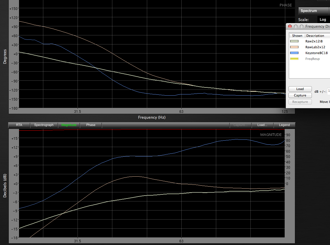

Matching phase between the top cabinets and the subs is very important for good transient response and realistic sound reproduction.I just personally feel that relatively linear phase response, and hence transient response, is one of the most (the most?) important aspects of somewhat realistic sound reproduction. Not going to get that with a tapped horn.
Although a sealed enclosure may have less phase shift over it's pass band than a BR, FLH or TH, all four can be phase aligned at the acoustic crossover point.
When done properly there is surprisingly little difference in the sound of the four different types of cabinets as long as they are equalized the same.
In the chart below, a sealed (IB) 2x12", a ported 2x12" and a TH (Keystone) are compared. From about 35 to 115 Hz the TH actually has the least phase shift of the three.
One class of subs that I have found generally don't sound good are band pass, the phase shift in the upper region is so rapid that it is not possible to get a good phase transition unless they are crossed well below the upper band pass, which leaves only about an octave of coverage left.
So in your example, you're not measuring the phase shifts typically shown in a TH model, or they don't actually exist in reality?
I'm not an expert in this but I believe Danley addressed this years ago. I think he said that when you eq a TH to have flat response it will also have flat phase response. (That's not to say there's no shift, just that it's not spiky.)
Anyway, I don't think the amount of phase shift matters much as long as it matches the phase of the tops at the crossover point. Different crossover types and slopes will give different amounts of phase shift and different designs will have different phase response to start with, so you have to know what you are starting with if you want to get a good blend between the subs and tops. There's nothing wrong with mixing types and slopes of crossover as long as you end up with the frequency and phase response that you need.
The Hornresp models seem accurate as far as phase response, though just as the measured frequency response of cabinets are not as "peaky" as Hornresp predicts, neither is the phase response.So in your example, you're not measuring the phase shifts typically shown in a TH model, or they don't actually exist in reality?
The TH in my example has phase shift and frequency response similar to the DSL TH-118.

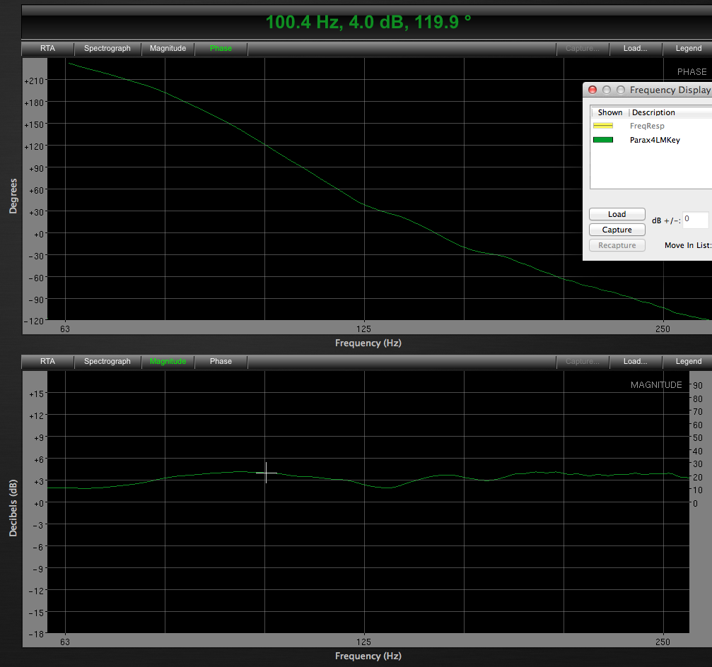

The ragged upper phase and frequency response of a TH makes them unsuitable for high crossover points, but within about a two octave range the phase can be comparably quite flat.
Although the Keystone TH phase response is still reasonably good for another octave higher than where it is crossed over, above 250 Hz it goes through dozens of 360 degree phase rotations.
A BR's upper phase response remains smooth as far as the frequency response does, so can be used over a much wider band width than a TH.
Both TH and FLH require the top cabinets to be delayed to be time and phase aligned, while BR may not require any delay.
The time alignment requirement often leads to "bad sound", as it is easy to get wrong.
Using a 24 dB per octave crossover, the HF rotations of a TH or FLH are of no audible consequence, as can be seen in the phase plot below of a TH time aligned with the top cabinets.
The crossover point is 100 Hz, the phase response of the LF and top cabinets align perfectly there.
Subjectively, there is no lack of "punch" in the crossover region compared to a BR.
