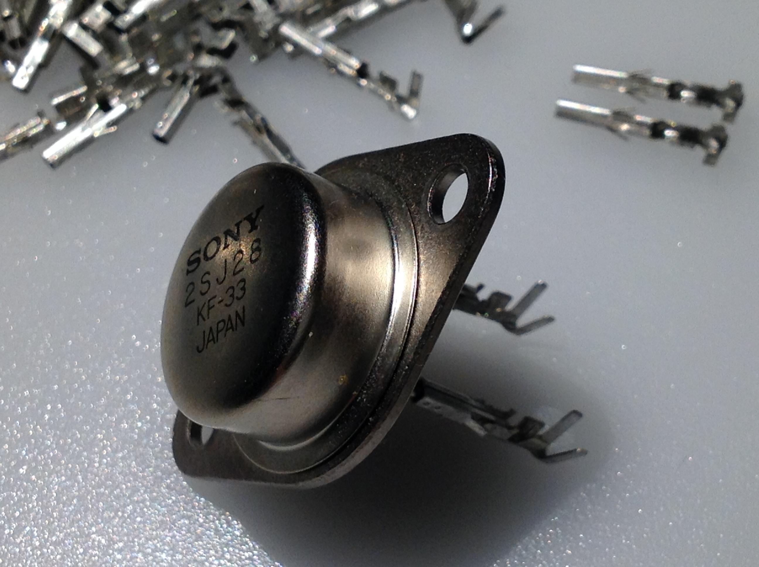

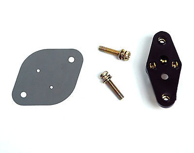

I pulled the attached TO-3 part from a thick salvaged heatsink and
noticed there appears to be extension pins. I want to use the
same on a 2sk82. Would anyone know where I can get these
extension pins?
Thanks,
Dennis

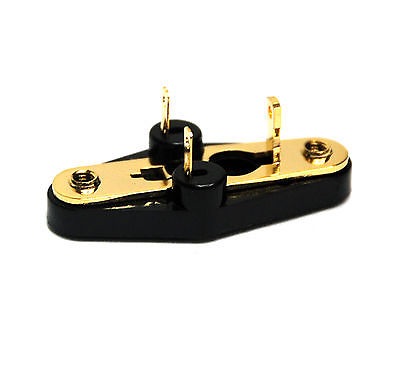

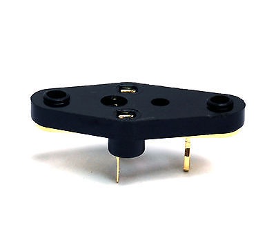

Hi Dennis
You can use TO-3 socket as well
Best regards
http://www.ebay.com/itm/10sets-Bake...aa162f0&pid=100005&rk=1&rkt=3&sd=130328755206
Hi Christophe,
Thanks. In my case, the heatsink I want to use is quite thick and the
pins on the To-3 part doesn't quite extend pass the base plate.
Dennis
Hi Dennis
Good news !
I have lot of special for TO-3 transistors extensions by 10 mm = 0,393 inch more.
It's what you need ? Very easy to solder btw.
How many pieces ? If you interested simply PM me.
Christophe

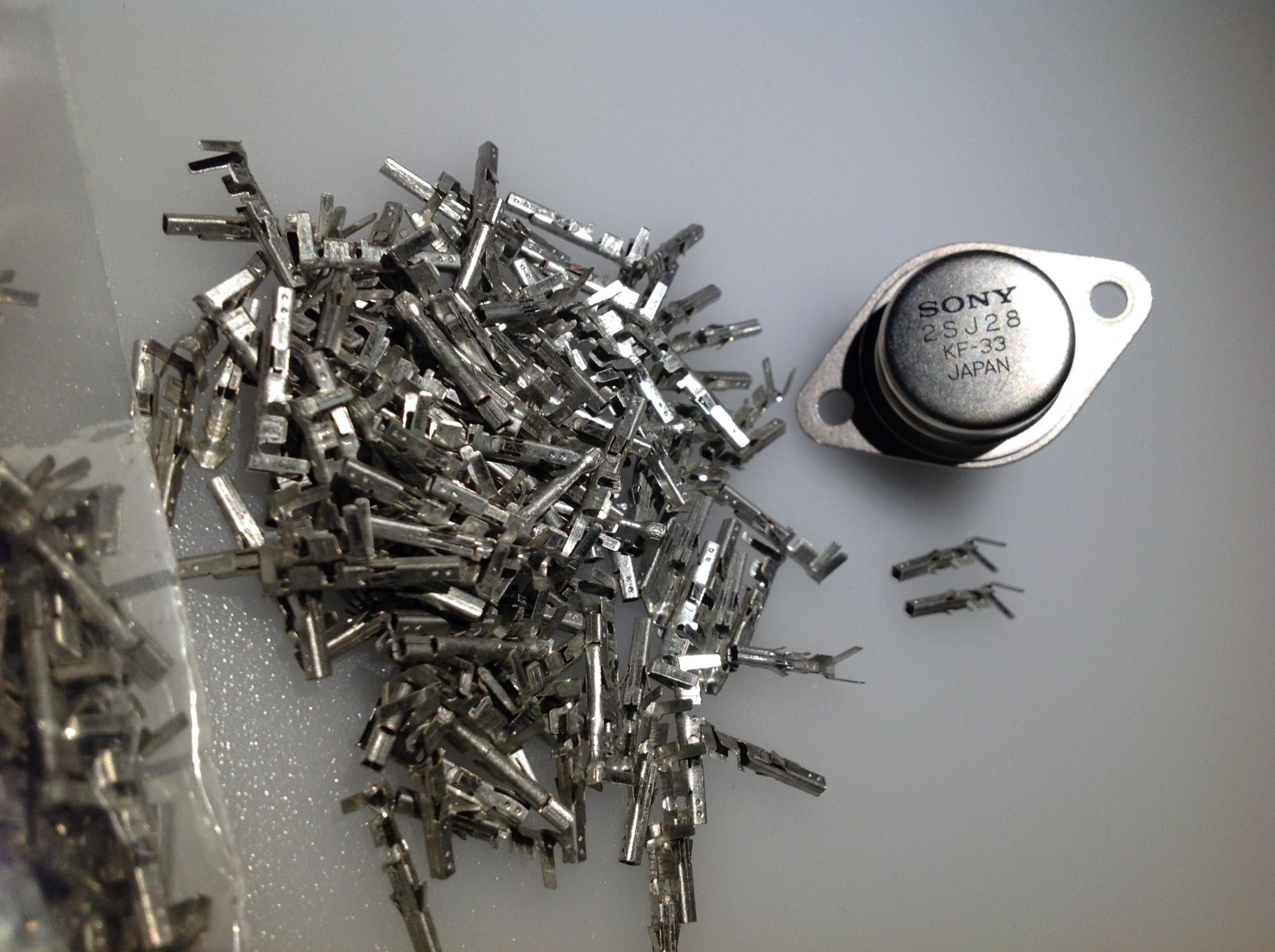

They are not from the socket.Those sure look like they came from a TO-3 socket...
oops! never mind...
Don't use pins extension if you use TO-3 socket...
Best regards

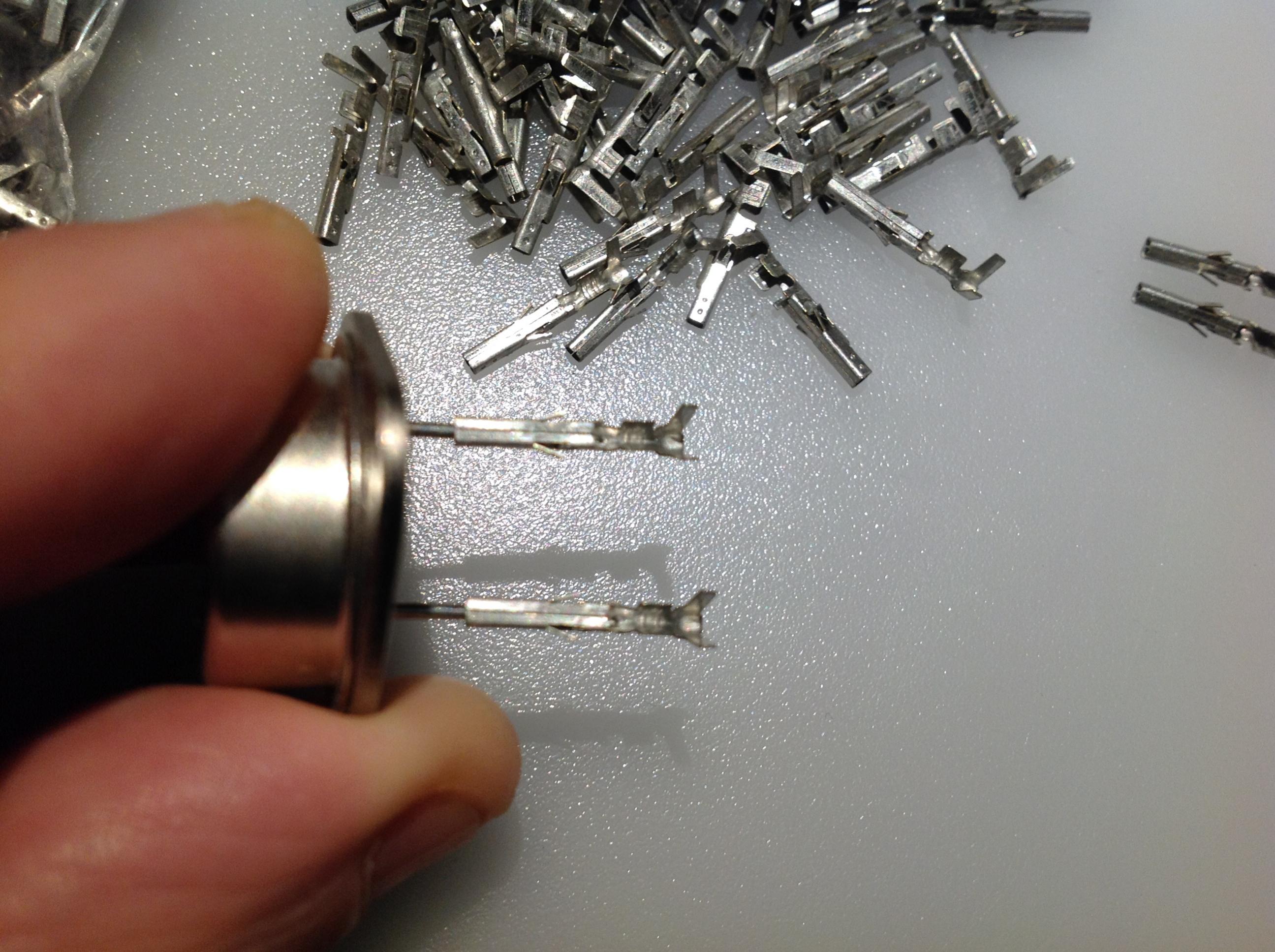

Hi Christophe,
Are those Molex connector pins?
Thanks,
Dennis
Hi Dennis
Visibly yes is Molex connectors inside part.
Like you see on my photos they can do the job
but other solutions are better or equal.
Connectors i ready have on my table without buy " that one's "
Greetings
The story is i bought them like a part of big box of new old stock components without knowing his utility.
Always guessing they was made for TO-3

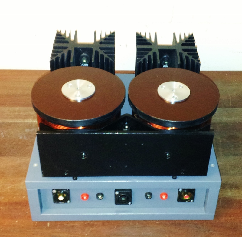

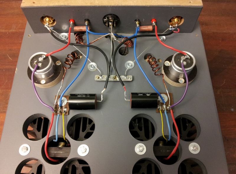

Today i am one very unhappy diy man.
After conversion of my 2sk82 L'amp from fixed bias to self bias (as per post 2355), the left channel SIT died after about 3 hours operation.
I have no clue of what could have gone wrong. Both SITs had dialled in close to each other with bias voltages of -6.2 and -6.5 V (1.59 amps 1.66 amps).
I have no spare 2sk82 KD33 left. I had bought an extra pair from Acronman, but used it for LuminAria (who would have thought that Michel would come up with another design for these SITs?)
If one of you is ready to sell a pair of KD33 types, please let me know.

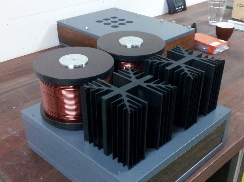

The pictures show L'amp and LuminAria in the back and the simple inside of L'amp.
Power supply is external (cLCrC)
From your photos and 2355 schematic the cap should be at source not the drain plus yours source resistor to ground is missing or its next to sit?
You are totally right. How could i get that cap connection wrong? But it wouldn't explain the failure of the SIT.
As for the resistors, they are big 50 watters hidden between the two heatsinks at the back.
Many thanks for your help.
Yes, the cap needs to be at the junction of the source and source resistor. Do you have a schematic sketch of how you connected everything? It's a little hard to tell what the sit connections are in the photo.
Many thanks for your reply. I did use the schematic of post 2355 but made the mistake you mentioned of connecting the cap to the drain. I shall change that asap and see what the remaining SIT shall say.
