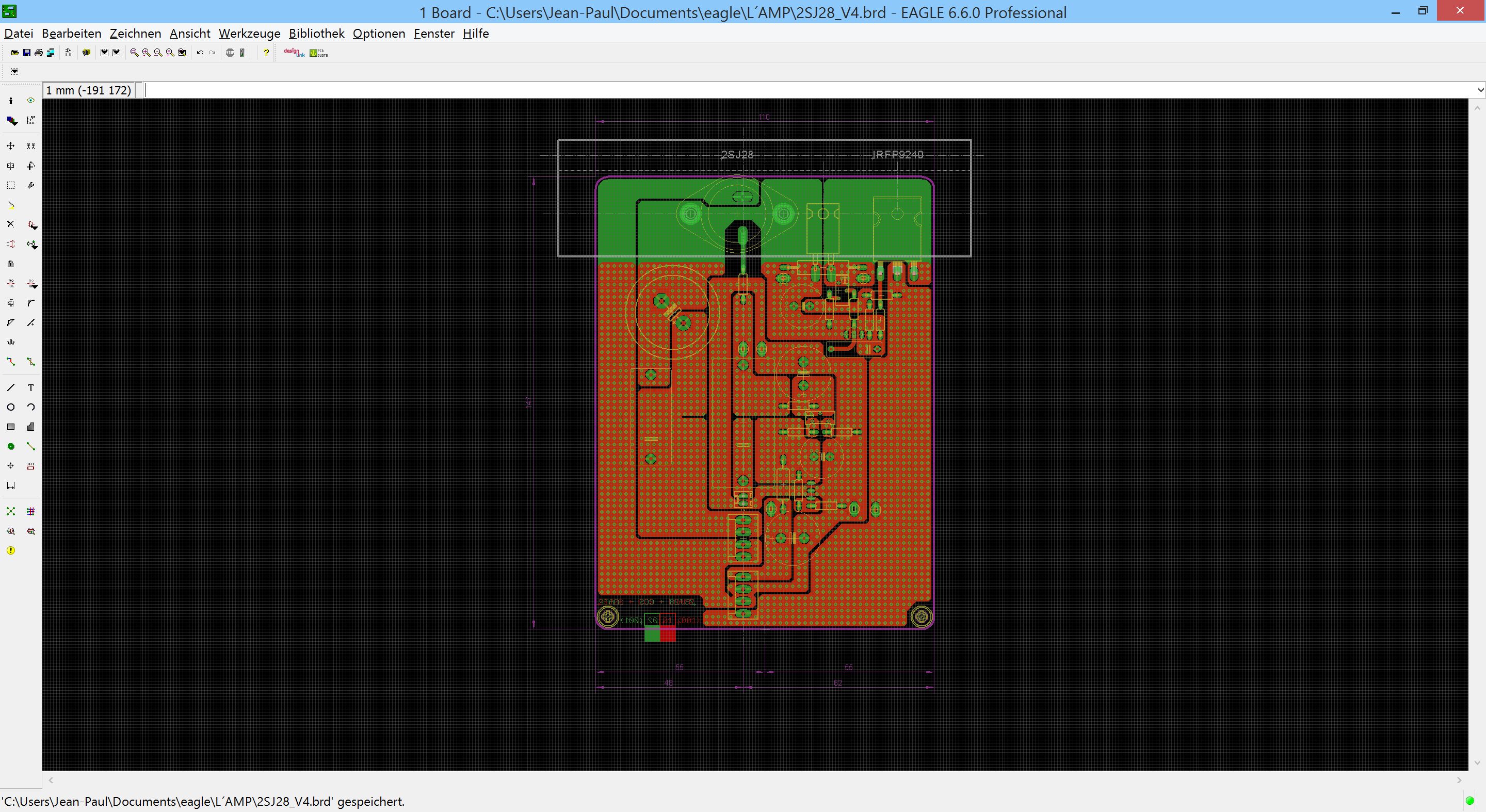

Please report until the beginning of next week if more PCB needed!
I think I will go with this design...
Hi Jps1964
More distance between transistors on heat sink give better heat dissipation and longer service life.
Fancy special aluminium connecteur good for audio ?
Classic copper wire soldered to pcb are the best imo.
Great work anyway congratulation but you need make real prototype with soldered components before pcb's make in serie.
Some of builds details are not included in software.
Try & see
Have fun

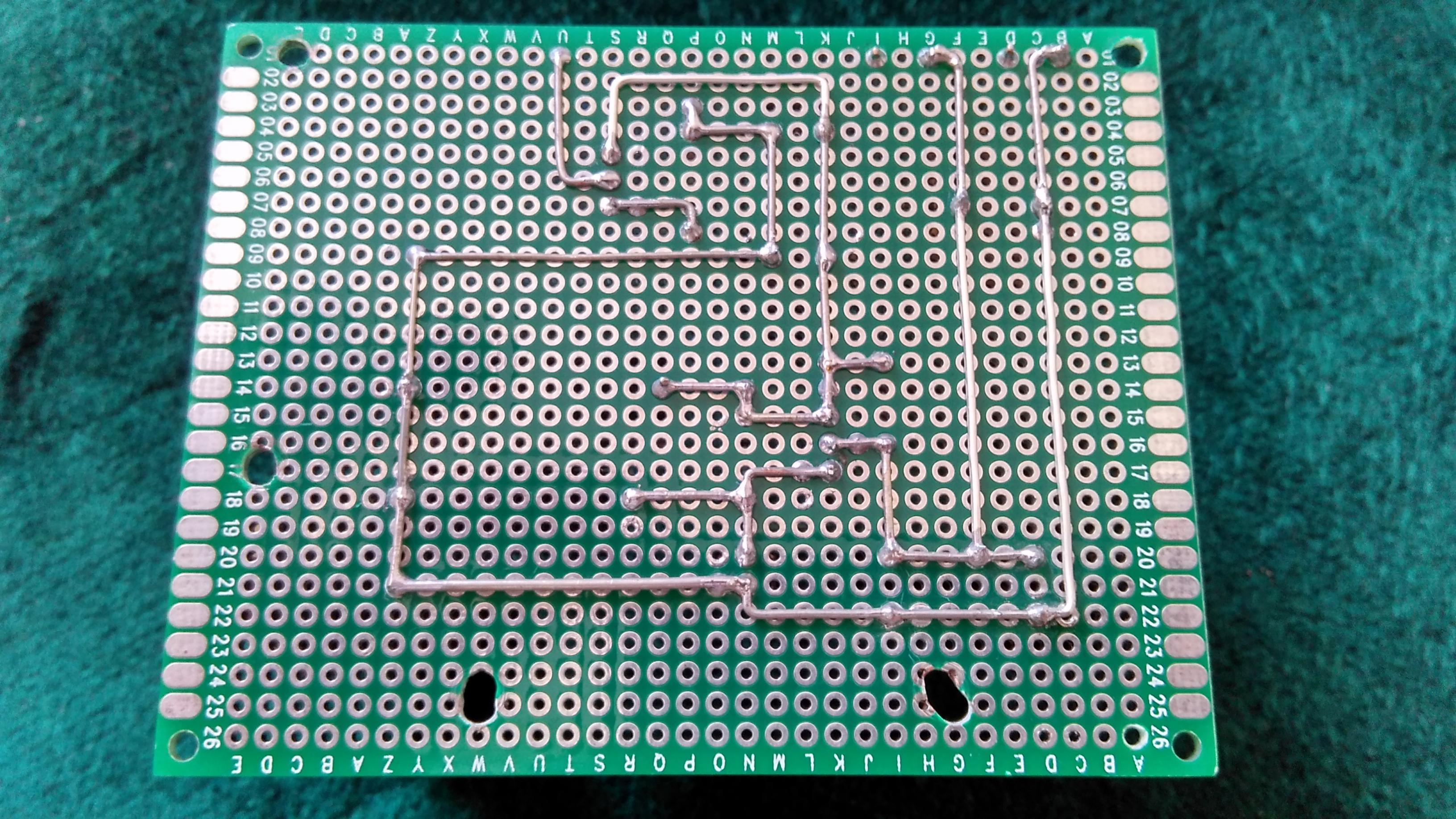

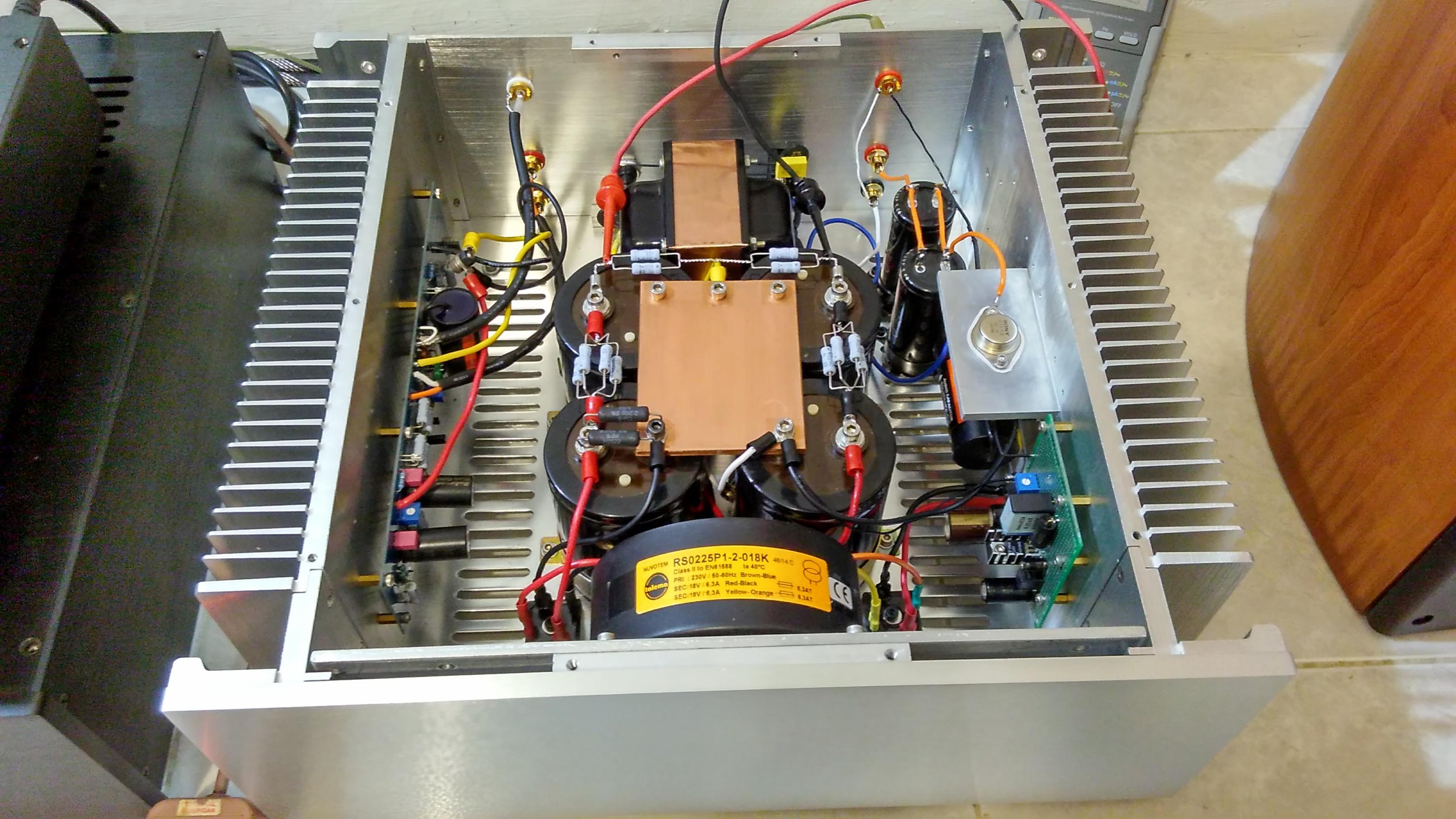

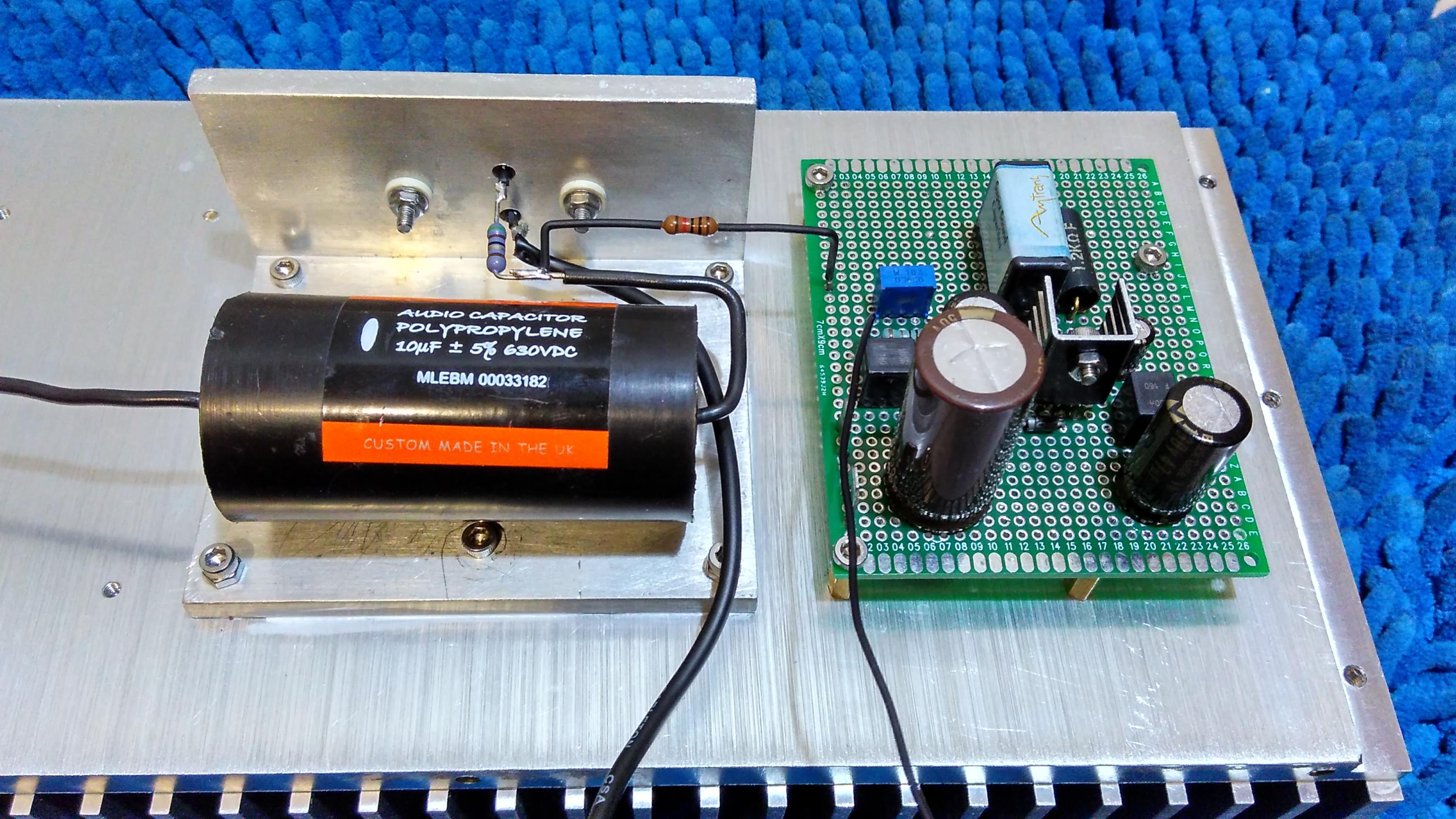

started to make bias supply this morning on perf board, use all my voodoo parts that i have for bias supply. my configuration:
* B+ supply : 68mF - 0R1 - 68mF - 1R - 68mF - 0R1 - 68mF - 300mH 3A M6 core
* B+ after choke ~ 21V
* Voltage drop on 1R ~ 2V so it's as designed as it should be ~ 2A
* temperature on SIT case 32°C, on L-plate 33°C, on heatsink 32°C
* speaker 4ohm 88dB
and again i have no issue :D no thump, noise or hum. music plays beautifully, however this is only one channel completed, another one maybe tomorrow or next week.
with AlephJ stereo, i usually set my dcb1 potensio to 12 o'clock, now with SIT single channel i set to 3 o'clock. I still have extra headroom
well it's time to sleep while listening my audiophile collection with SIT L'amp. Thanks to Uncle Mike for this great design :)

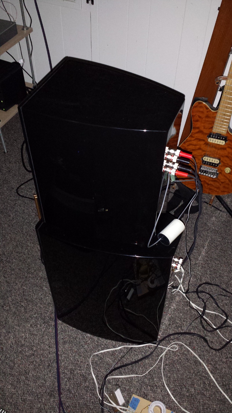

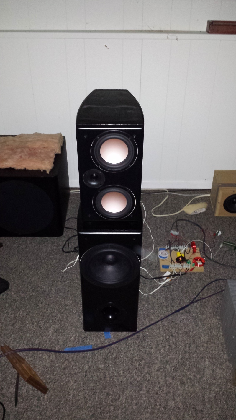

How low does the midrange go in frequency (xover point)?
What is sensitivity of driver?
How loud do you listen to music?
The sub is 89.5 db, mids together are 90, tweeter is 95.
So it's about a 90 db limiting factor.
Was going to use the mids down to 10hz to 125 hz to keep the sub section non-directional. At the moment using 6 db 300hz crossover point because I was limited by parts on hand. It sounds ok at 300.
I don't listen at very high levels. Probably don't break 1 watt output.
The sub section will use a F5t and it has plenty of gain.
Would probably need to cut it back.
Also have am F6 for mids if needed. Would like to use the SIT amps for their qualities in the mids and highs.

started to make bias supply this morning on perf board, use all my voodoo parts ....and again i have no issue :D no thump, noise or hum. music plays beautifully, ...mwell it's time to sleep while listening my audiophile collection with SIT L'amp. Thanks to Uncle Mike for this great design :)
@ Gadut
Joy of first sit :note:
Congratulations for electronic hooby passionate work of DIY Champion :Olympic:
Simple beauty this perf board with wire tracks hmmm excellent that the spirit :)
Yeah always cool projects from Uncle Mike.
Thanks Gentlemans :house:
If you keep the crossover point above 200Hz you definitely won't have issues.
Feel free to experiment going lower in frequency. Once you start noticing problems just increase the crossover point higher in frequency.
