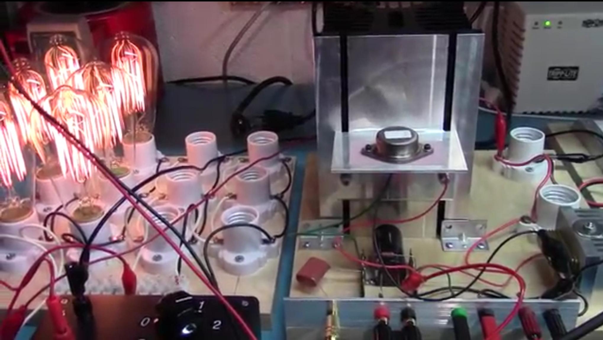

Can the L'amp chock loaded and CCS version survive a 4 ohm load?
4 ohm midrange with choke loaded and 4 ohm tweeter with CCS version.
Why not? dont need to worry about 4 Ohm. especially it's not a woofer, midrange and tweeter wil have lower load.

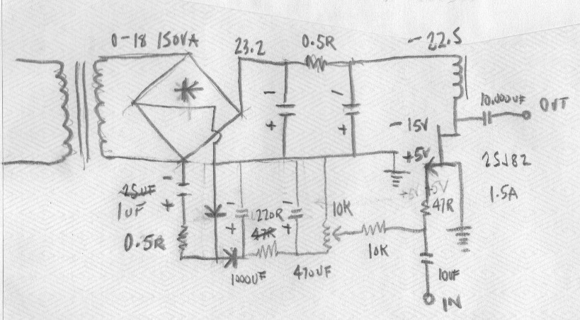

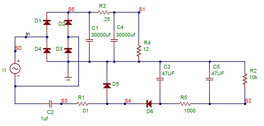

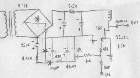

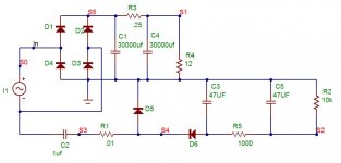

Hello Fellow SIT amp builders.
I have finished up my Inductor L'amp
But i need more bias voltage to reduce some current.
I have used the attached power supply except I have a 0.33 Resistor at R1
My PT is 0-18 so have about 7V at C2 and it passes 2.5AC at S3
Do I try a larger cap to get more voltage at this point?
Thank you guys very much

Ok Ive got only juuust enough with a 20Uf C2 and 180R R5 , would like a bit more
Ive only 1 20uf C2 plastic cap on hand, Tried a crossover bipolar and big buzzz.
So If i put larger electro in there on the secondary leg, do i put + towards it? bit of a dumb question im sorry
ohh by the way I have a + bias network and a - HT for PNP sit

Theses symptoms are usually caused by reverse polarity on a polarized cap, or excessive ripple current through the cap?
My guess is there is an error in connection or a wrong polarity diode connection? After a coffee, I might be able to follow that schemo but it's to early now...
