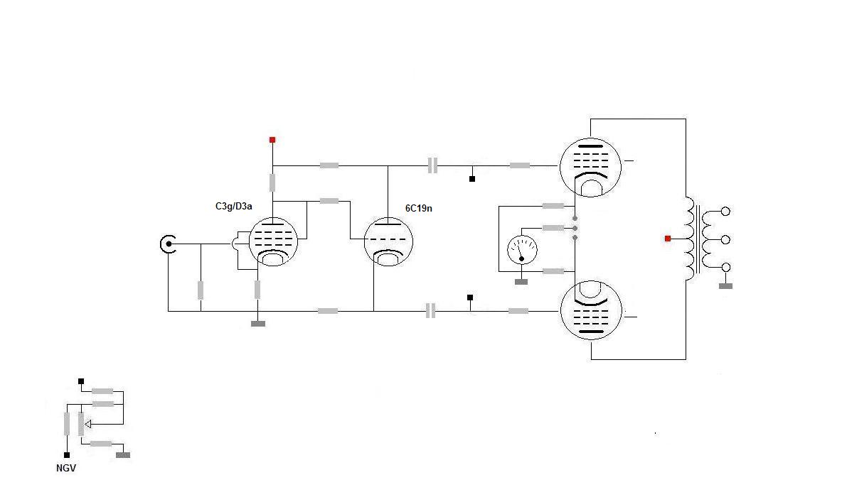

To get anywhere with this tube the g1 needs to be driven by a low impedance source
richy
6C19n(6S19p) is supposed to be a good low impedance driver
I thought it would be a good one to do this
but maybe not good enough
would it be a good idea to have seperate supply to screen grids
connected through chokes, instead of resistor

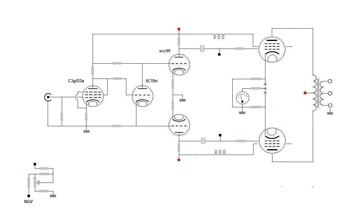

Ex-Moderator R.I.P.
Joined 2005
By Jove, I think he's got it! :D YES!
wow, Kevin, was that you, trying to teach me how to layout a negative bias adjust...:rolleyes:
cheers
edit...
well, you know how it is when not doing this stuff for a couple of years, and forgetting how to
and since Im not doing tube stuff 'every day', Im not sure I want to mess with negative bias
thinking of looking at it in 10 years from now, and not having clew about where or what ... :eek:
