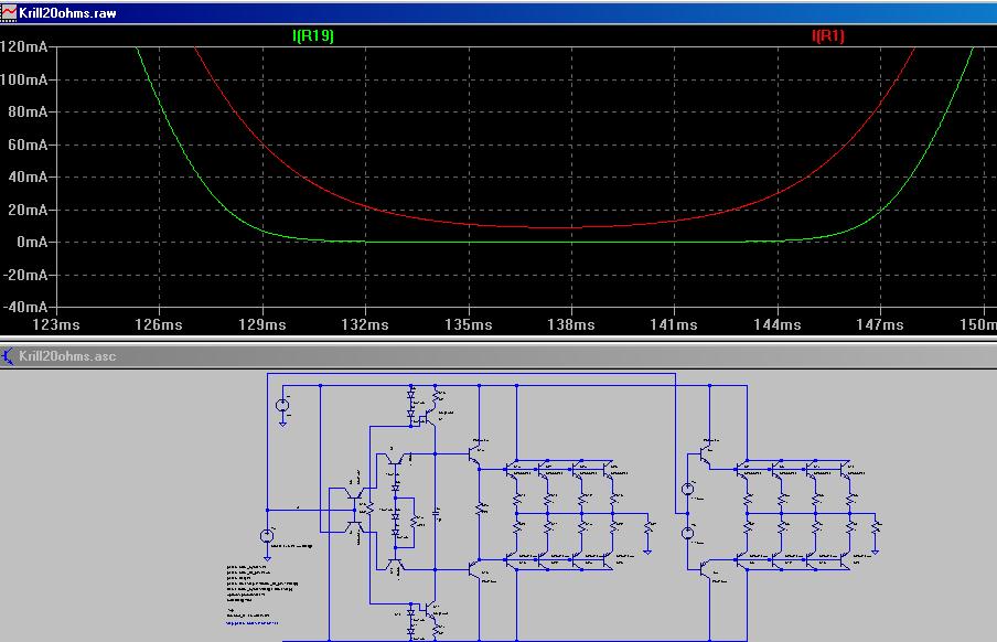

Anyway, I did a simulation of exactly the situation you just described, stepping the driver emitter resistor from 220 Ohms to 1e12 Ohms. That's done with the statement:
.step param Rdrv list 220 1e12
The graph is attached below, along with the exact simulation file used to produce it. Anyone interested can run the results and see for themselves. It clearly shows the absence of driver emitter resistor is what causes the soft switching.
Well said Andy.
And attached below is a my previous 4-transistor pair Krill simulation, but this time with a 20 ohms bias resistor for the driver stage.
It is also worth pointing out that a 220 ohm biasing resistor is far to small for any power output stage anyway - that will only bias the drivers with 6mA or so, which is far too low to achieve an adequately fast switch off of the output devices that is necessary for the lowest possible distortion. D.Self even recommends bypassing this resistor with a large cap to further speed up the switching.
Anyway, getting back to the attaced simulation; in the first attached picture the green trace shows the ballast resistor current for the complete Krill output stage which has been modified with a 20 ohm bias resistor for driver transistors.
The red trace, for comparison, shows the ballast resistor current of the non-krill output stage with ideal voltage source bias and no bias resistor for the drivers.

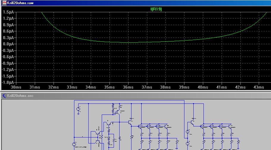

The green trace of the second attached screen shot shows the Krill output stage ballast resistor current on a much smaller scale to show that it does indeed switch completely when the drivers are adequately biased.
The current drops down to about 80nA - which is just leakage or junction capacitance current (in a seperate sim I found that, under DC operating conditions with comparable supply rails, the output transistor model generates an off collector leakage current of about 90nA).
And as before, the complete LTspice simulation file is attached for anyone to download and run for themselves

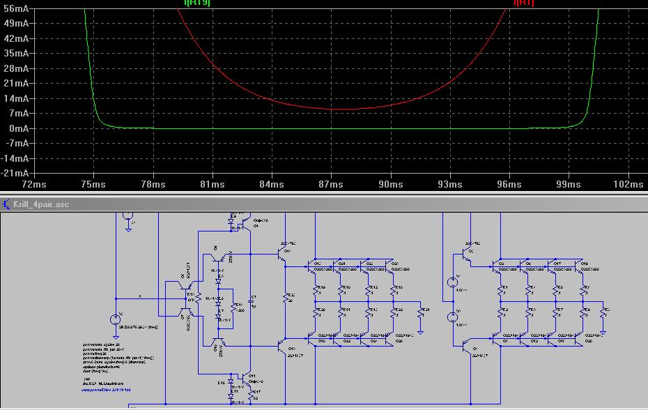

Oh, an just for good measure here is the operation of the 4-transistor pair output stage with a 220 ohm biasing resistor. The switching is much less abrupt, but it is still well and truely enough to make the krill circuit switch.
