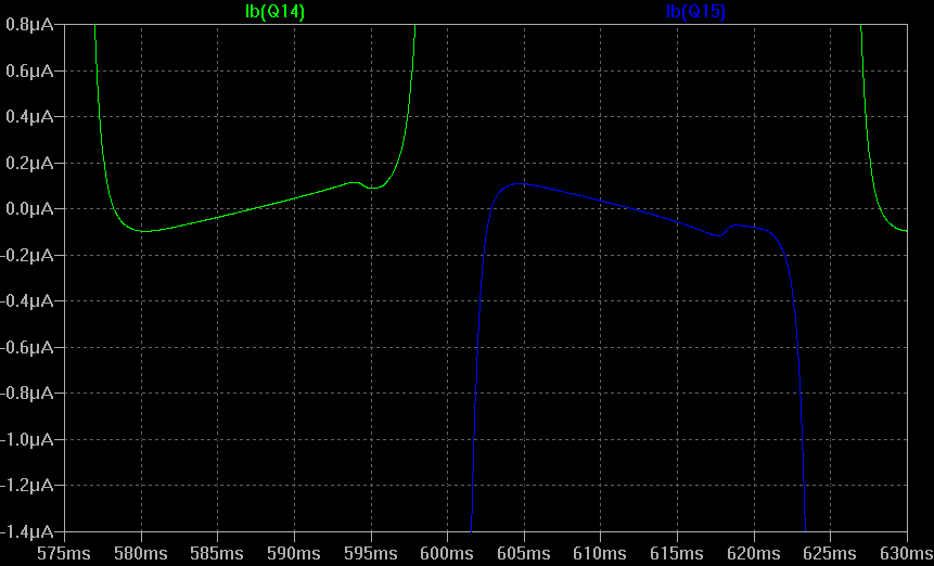

About the Krill,

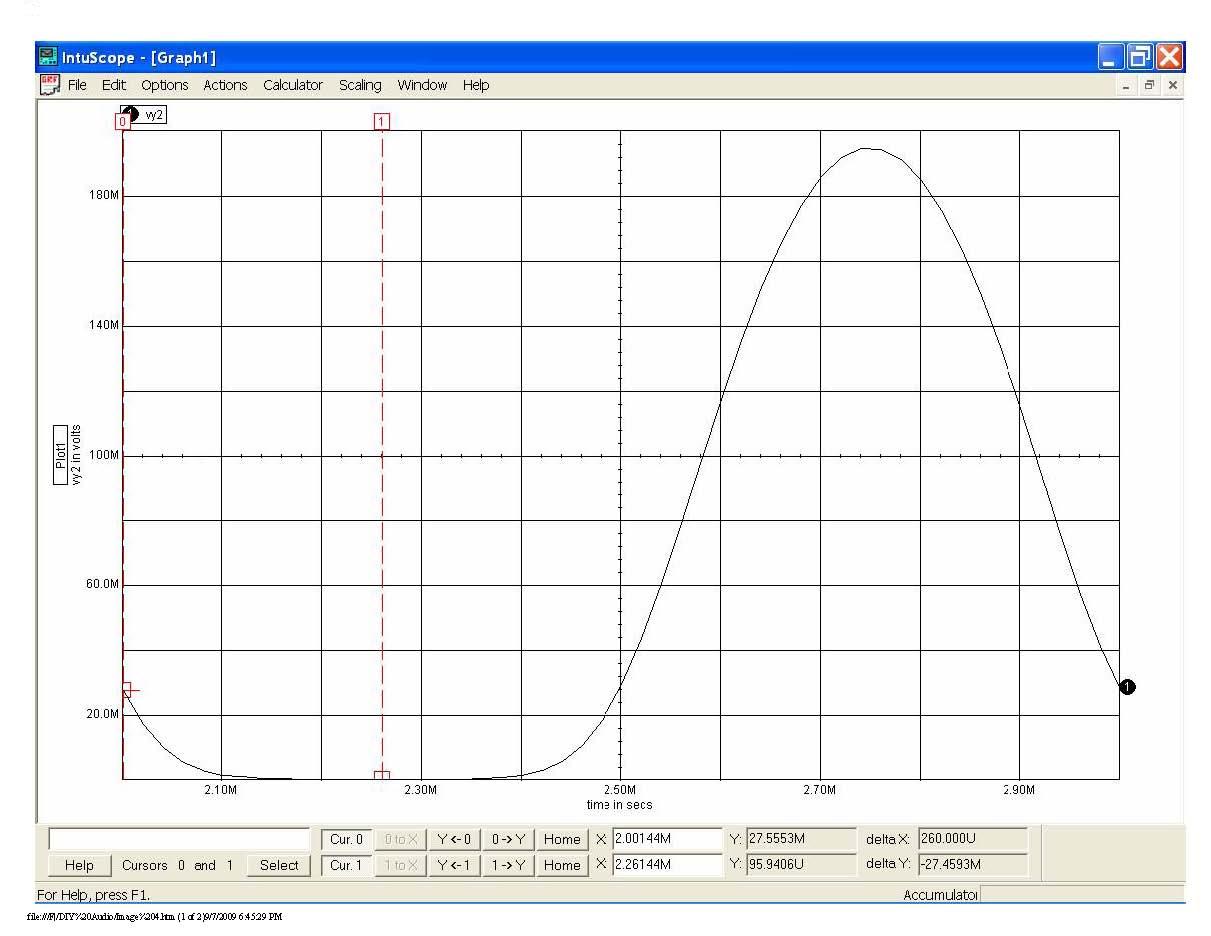

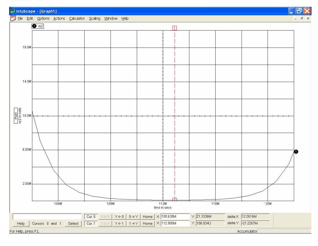

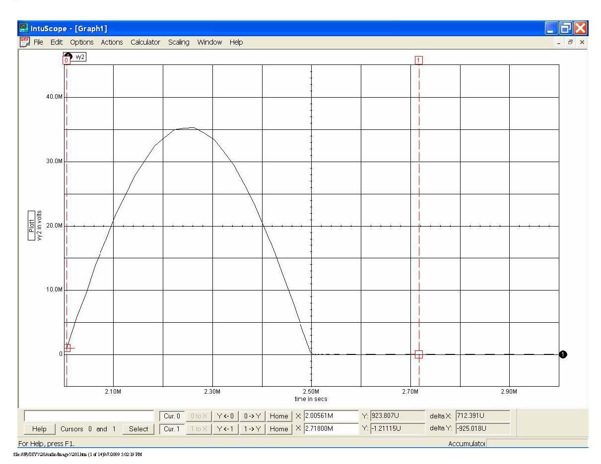

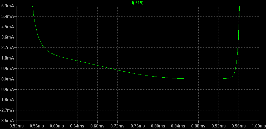

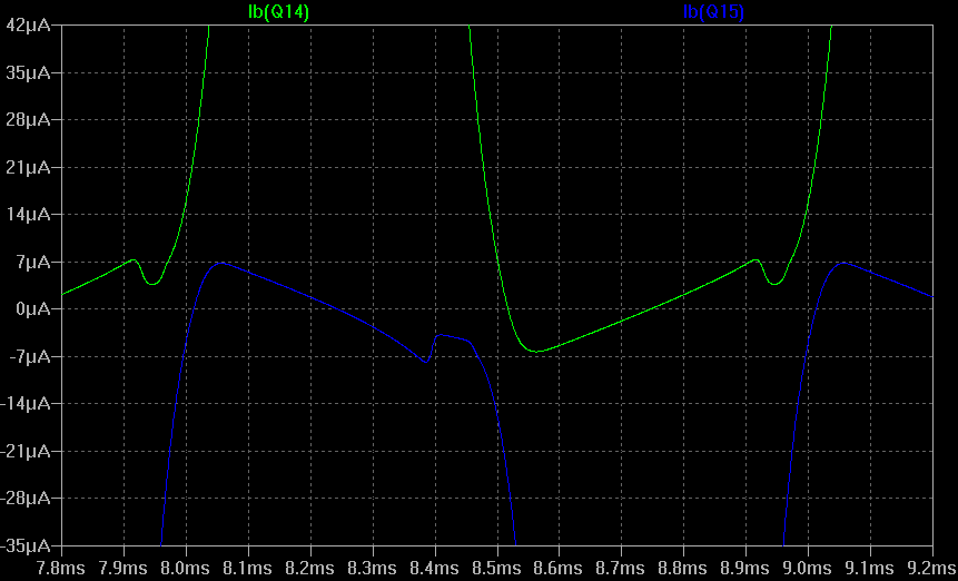

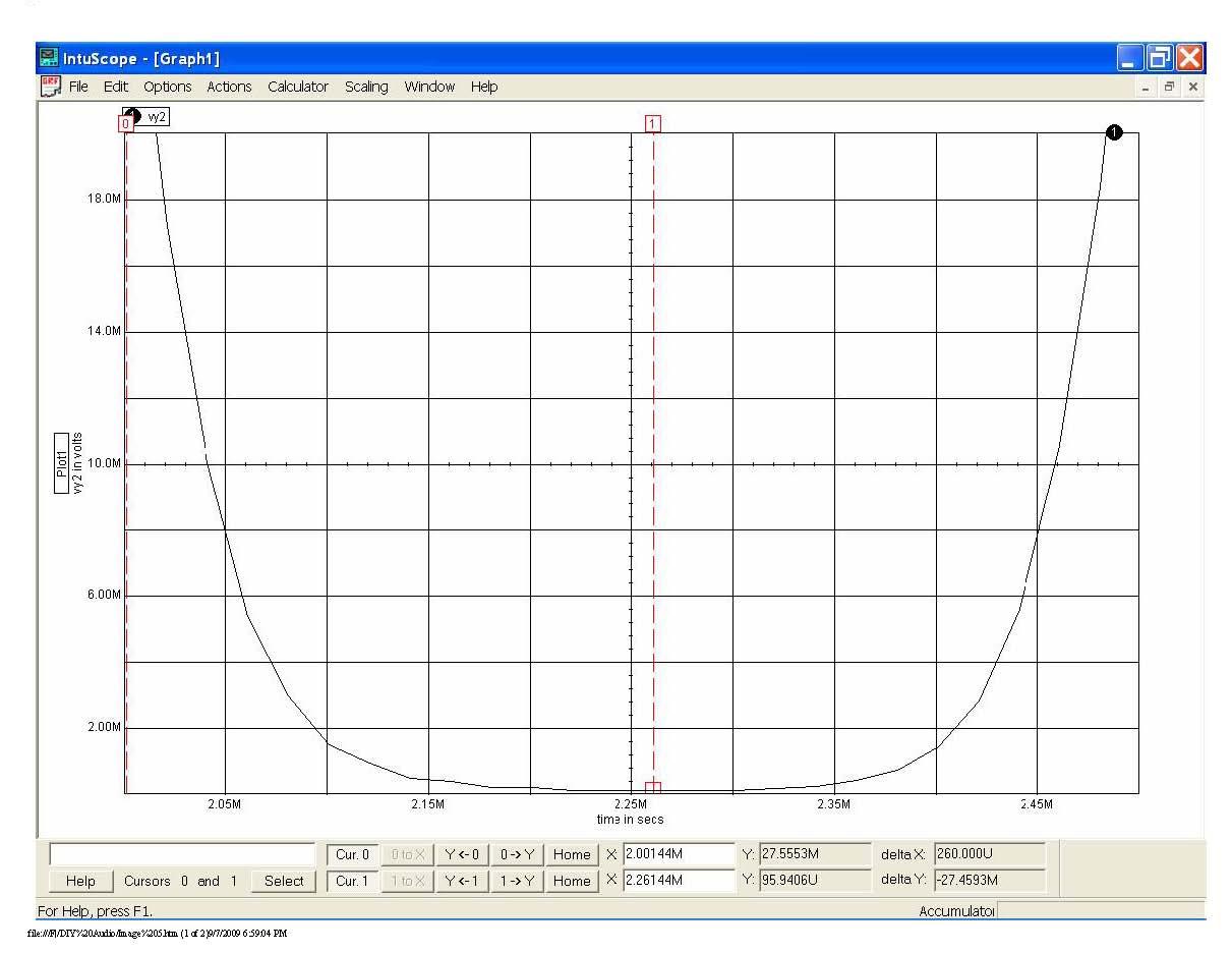

I have been looking at it from the side view so far and what came to my mind from the very beginning is one can use diodes at the inputs of the driver/OP which will also prevent the base charge to be sucked out, the OP stage can only be pulled on through the diode but not off.
Actually a circuit that is supposed to work according to the non-switching off scheme should not show any significant rise in cross conduction current by rise of working frequency, eg. that is there is an intelligence designed into the circuit to keep the cross conduction fairly constant within its working frequency which in this case is the audio band and for different loads (hence higher load means more base charge), can this circuit show such a consistency say from 20 Hz to 20 kHz and, different and reactive loads??
