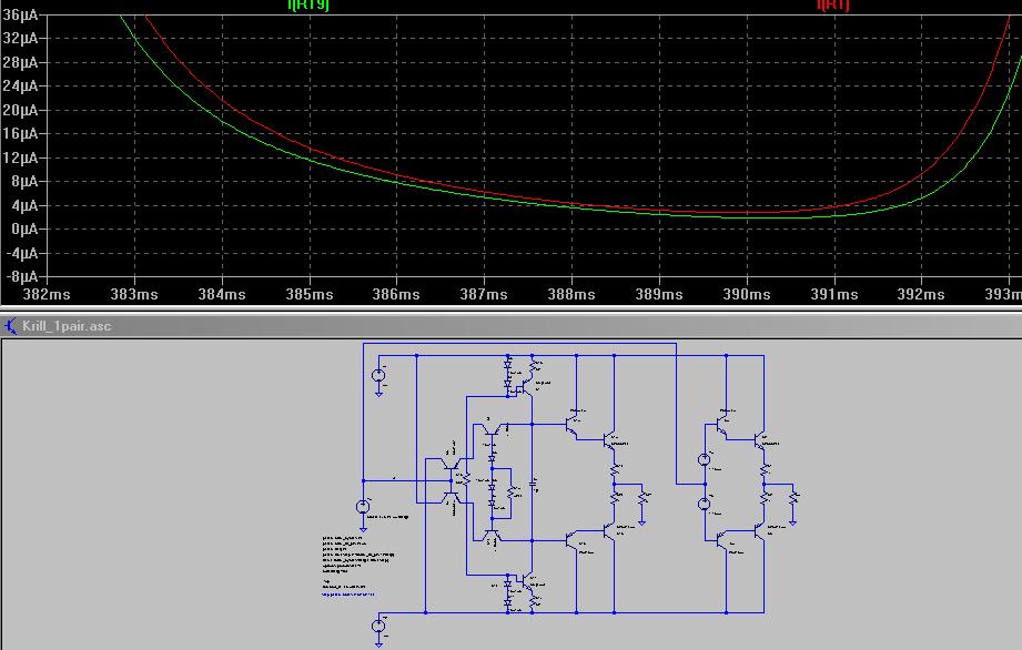

As Andy pointed out above, renaming Rbias makes absolutely no difference – LTspice ain’t broke.
As for the behaviour of this circuit, I’m afraid it was adequately outlined way back in post 7 on the very first page of this needlessly protracted thread. Any “non switching” behaviour demonstrated under certain operating conditions is entirely due to the lack of a biasing resistor for the (consequently current starved) driver transistors and has absolutely nothing to do with the Krill biasing circuit.
It has been explained why the biasing circuit can’t work as claimed over and over and over and over again but ignored. I even made it quite clear in my (also ignored) post #79 how you can check for this fact for yourself. On this I do not particularly care to waste any more time.
As for the recent claims I have replicated your simulation results from posts 138 and 140 and attached the results below. I have not only replicated your “non-switching” results with the Krill biasing scheme, but also with the same output stage biased with an ideal voltage source instead - reiterating the point I made way back in post 8 in response to post 7.
The first picture is a screen shot of this simulation. The green trace shows the ballast resistor current for the complete Krill output stage, the red trace shows the ballast resistor current for the output stage with the ideal voltage source bias. Both stages have the same quiescent current.
As can be seen, both output stages behave virtually identically. However, current this low doesn’t matter much anyway – a uA or two is really nothing as far as a power output stage goes and this can be well and truly considered “off” – such a small current won’t do anything to mitigate any output stage non-linearity. The attached file entitled Krill_1pair.asc is the LTspice simulation file.

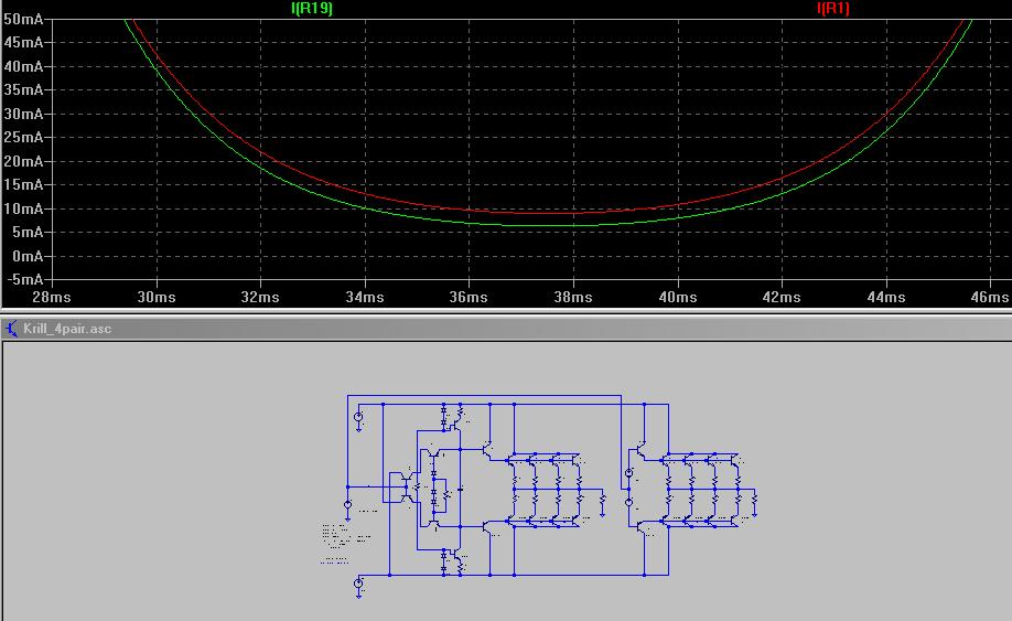

That didn't take as long as I had expected. The attached file is the same schematic I posted in post 127. All resistor values are the same as in my posted schematic. I used the models that Andy included with the file he posted. The results are somewhat different from what I get with my sim program, but seem to be in my favor.
What you have done here is to exacerbate the cross-conduction issue by quadrupling (four pairs of output devices) the load capacitance presented to the current-starved driver stage. Since the stored charge is now four times as great the output devices in fact take so long to turn off that, even at 20Hz, the current never has a chance to drop below several mA.
This is nothing extraordinary and has absolutely nothing to do with the (claimed) operation of the Krill biasing circuit, but is entirely due to the lack of a biasing resistor for the driver transistors.
Want proof? The second picture is a screen shot of the simulation for the Krill output stage with four parallel transistor pairs, run in tandem with the same output stage biased with an ideal voltage source. As before, the quiescent current is identical in both cases. The green trace shows a ballast resistor current for the complete Krill circuit and the red trace shows a ballast resistor current for the output stage with ideal voltage source bias.
The attached file entitled Krill_4pair.asc is the LTspice simulation file.
As before, the behaviour in terms of minimum current is virtually identical and also as before, the ideally biased output stage actually performs slightly better in this regard – the current plateaus at a higher minimum for the non-Krill version.
In conclusion the “minimum current” behaviour shown in posts 138 and 140 is in fact just cross-conduction ultimately caused by a current starved driver stage.
The Krill biasing circuit does not operate as claimed or any differently from a standard biasing circuit as far as output device switching is concerned (for reasons already explained ad nauseam).

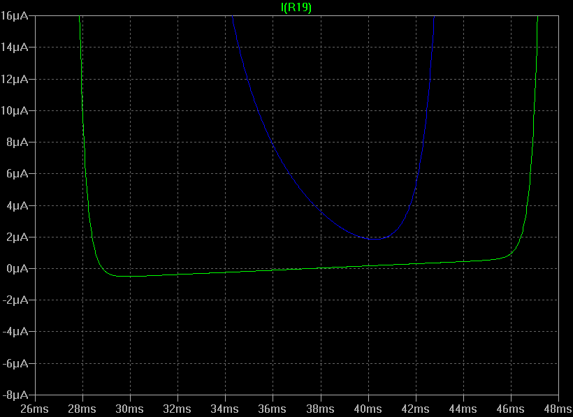

Anyway, I did a simulation of exactly the situation you just described, stepping the driver emitter resistor from 220 Ohms to 1e12 Ohms. That's done with the statement:
.step param Rdrv list 220 1e12
The graph is attached below, along with the exact simulation file used to produce it. Anyone interested can run the results and see for themselves. It clearly shows the absence of driver emitter resistor is what causes the soft switching.
