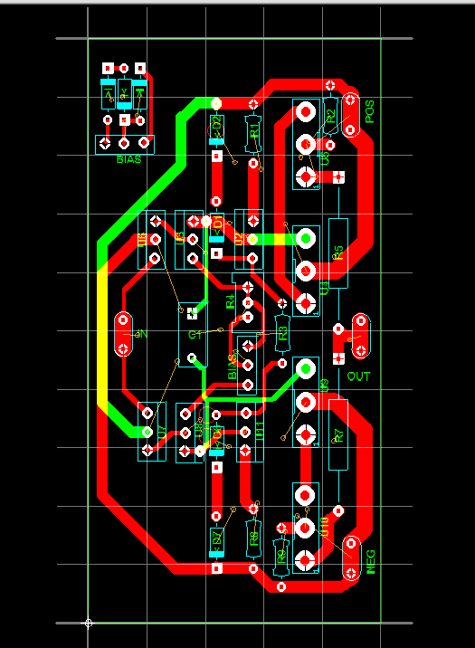

Too late. I like doing everything on a real board, not the mess I had slung together before. I went ahead and did a quick layout of the output stage (board shown on the previous page).
This was just a learning experience - I have 150 - 200watts amps and amp deigns already.
Hi Steve,
Don't take it the wrong way - not meant as a slight on you. If it's a free design, board layout should be readily available. If it's not available, that's fine. Some references (photos) would be helpful for those of us that are willing to put a little effort.
It's not like many here are able (or willing) to make their own boards, so no threat to the boards you are selling. I don't buy boards (only one exception) so I'm not your market.
MJL21193 said:Hi Steve,
Should be? What's your theory on this??
Who is responsible for this?
You might want to post this request for a layout over in the builder's thread??
Also the output stage is fairly simple, so is there really a need for a layout for just the output stage?
MLJ, if you bothered to actually read the thread(?), Steve is not "in the market" to sell boards. Talking like this, because you have obviously not read much of the thread, is somewhat irritating and obnoxious. If you have/had read the thread, then you'd be simply rude and deliberately nasty.
Your complaints are not appropriate.
Most of the response I have received has been from people that made their own boards. Many here are both willing and able.
There have been photos posted of bare boards and boards in the process of being stuffed. There have been photos of completed boards including one of the inside of one of my 100W amps. Every piece of information I have available to me at this time has been made available to anyone that has asked. I found print copies of the boards I have and have made those available. They show front and back copper and stuffing guide. I have provided a schematic and a BOM WITH the Mouser and Digi-Key part numbers. How much more do you want for free?
