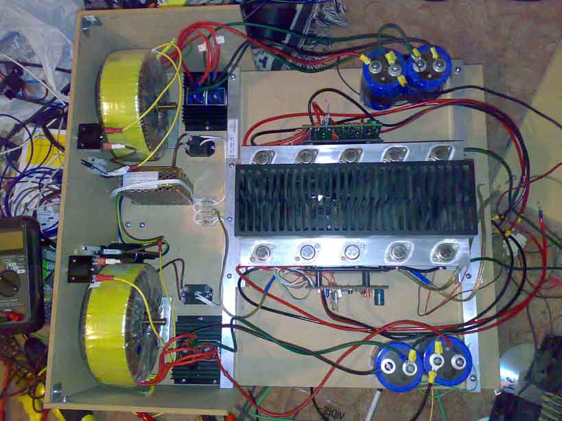

So now that i've (finally, after well over a year!!) got to 'finishing' the amp.... here's an update:
The box in the middle left is a 12v switchmode PSU for the fans and the relays. Both toroids are always plugged into the mains, but the 12v circuit switches relays (20amp 240v) which turn on the toroids. It is setup this way as my current amp has a low current 240v outlet that switches on when the preamp does, which is perfect!! I'm going to have a regulated circuit (it's tiny) to run the fans, i've got to put that in still (and build it), but it will allow me to switch voltages as I please (it'll be mostly set and forget hopefully!)... I'm now on the prowl for quieter fans, as the current ones are panaflow and they are fairly noisy IMHO! The timber will be changed to alloy once 'templates' are made :) The side panels will likely be timber...
Just be careful since quiter often means less airflow. I bought a virtualy noiceless fan and it manages to keep one channel below 60 degrees celcius for about 2min.:bigeyes:
Now I'm trying to decide if I am to use a 230V papstfan I bought from Steve at Apexjr instead or buy a more efficient 12V one and still use the fancontroll.
BTW
When measuring the temperature, I placed the sensor on the aluminium-mounting-thingie right next to one of the outputtransistors. This should get me a reading close to the temp of the transistors.
