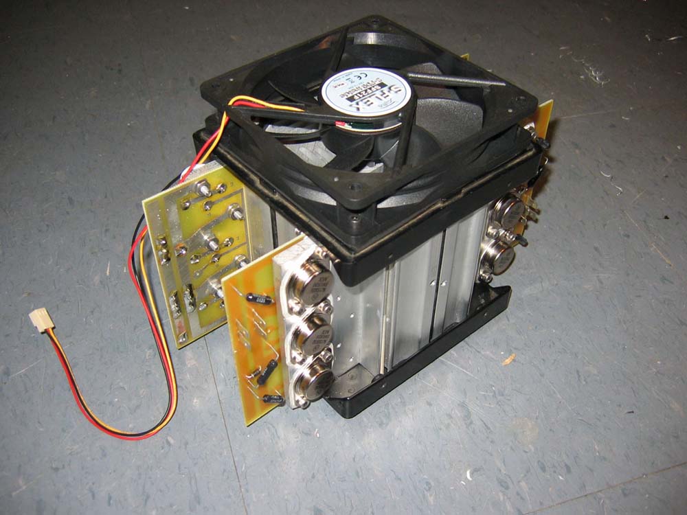

fan mounting/ rubber
My lower fan is mounted on soft rubber grommets that I split in half with a utility knife, so they are kind of like shoulder washers, the bolts that mount the fan never actually touch the fan they only touch the rubber. And the fan touches no metal, it only touches rubber.
At the time I thought this would help make it quieter (less vibration noise), and since it requires major disassembly to change this fan around I did not want to have to mess with it in the future. I thought that the rubber under the fan would also advantageously space the fan from the grill holes a small amount to make it quieter still (less vent hole noise).
However, you then have to choose how hard to mount the fan, because you are really going to squish that rubber if you mount it very securely. My guess is that too tight and you lose the advantages of the soft rubber, too lose and your mounting bolts are going to eventually come off.
If you look at the pic you see the fan and the rubber that is being squished (follow the red arrows). The vertical heat sink mounts onto the white nylon standoffs.
You also see the fan vent holes which according to ununamious consent in this thread are too small and too few. Yes, had I done better venting I'm sure it would be even quieter than using rubber. I just was tired of drilling holes in the bottom plate and wanted to assemble the amp. sorry. There are actually additional holes under the tiny fan but I got tired and did not want to drill them all over the place.... After a year of construction I wanted the amp to be built.

Did I understand correctly and your tunnelsink is mounted on this fan? In that case I'm in the clear since I had one large hole in the same size as the on on the top drilled/cut in the bottom below my sink. A diameter of approx 120mm.
Hi KmJ,
I don't think your overheating problem is lack of airflow.
I think you still have an amplifier error.
Turn your bias current (Iq) right down to near zero (maximum resistance in the lower leg of the Vbe multiplier).
Insert a light bulb in series with the mains live supply lead.
Turn on and tell us what the light bulb is doing. Flash? dim? bright? off?
I suggest you work with just one channel at a time. Disconnect the channel from the transformer until the other is sorted and insulate the disconnected leads.
