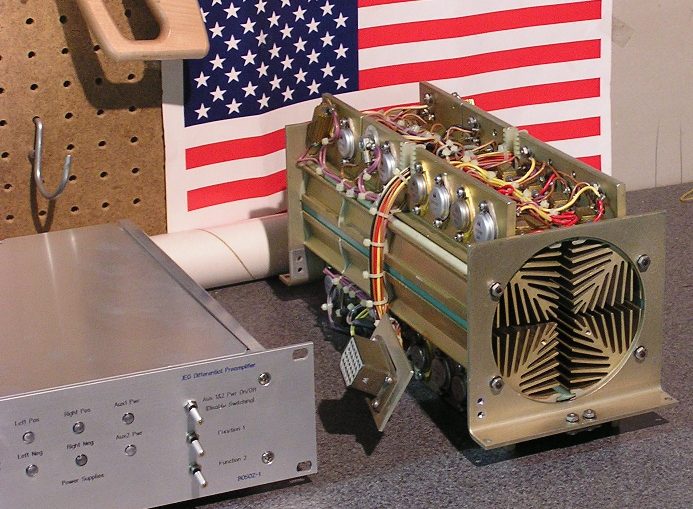

getting started with heatsinks
My Mystery Amplifier should get me 1/2 way there, well at least as far as heat sinking goes.
Its big enough I suppose for an 8 channel KSA-50, but I'll probably use extra output devices on each channel and use half of it, saving the other half for something else.
I'm going to be using MJE15030/31's as drivers from memory... I'm swimming in parts here, they are here somewhere....
I'm going for 4 pairs of outputs per channel, possibly depending on where it sits in the SOA, i might make it 6, i *think* the driver pairs and circuits will "support" it as such, i may need another pair of drivers - the KSA-100 had 2 pairs of drivers however only had 4 outputs, which makes me wonder a little....
