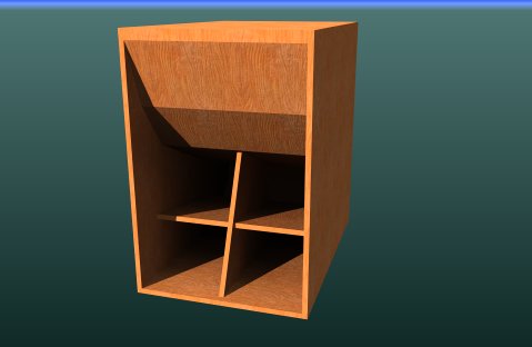

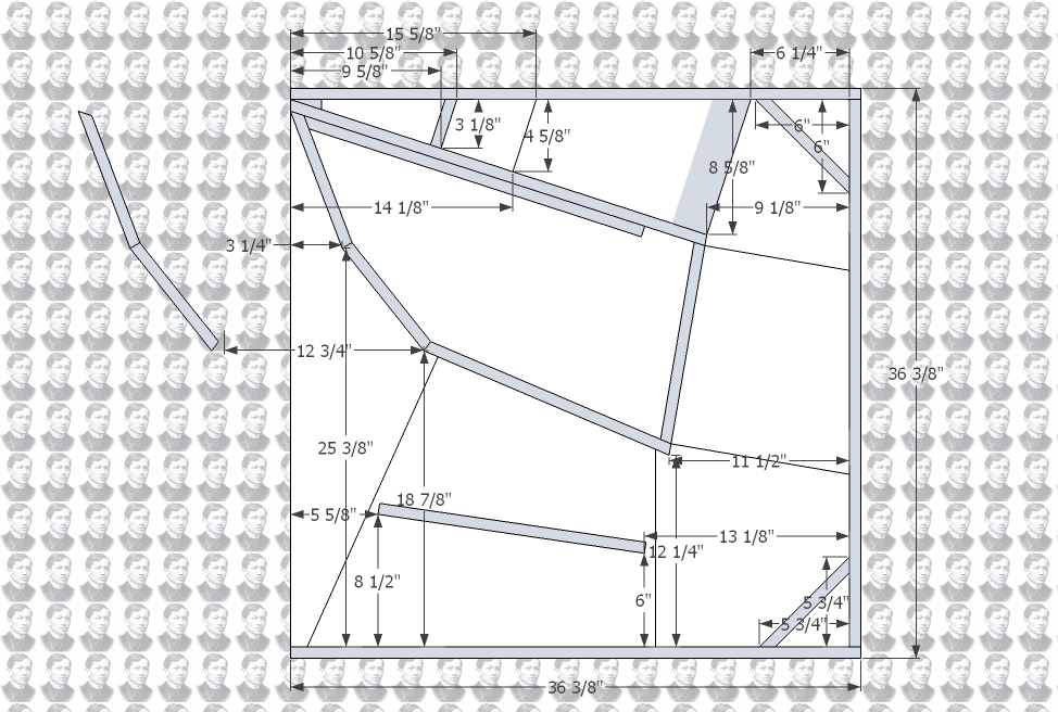

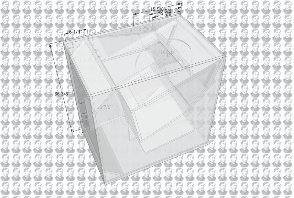

el-36 plan link
Cerwin Vega

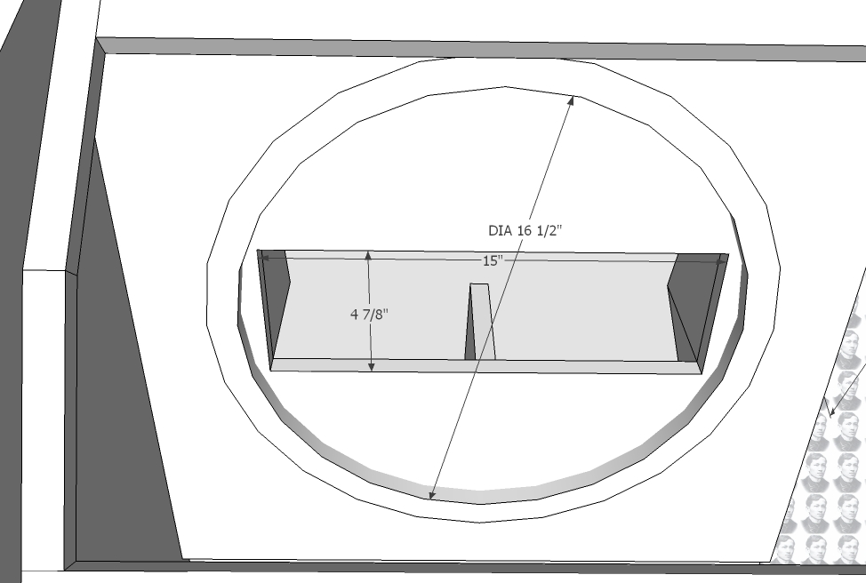

sir i'm after the top view, i want to see the displacement area. . . thanks
l-36
SL36
this is all i got sirsir i'm after the top view, i want to see the displacement area. . . thanks
SL36
@ jojo
thanks sir jojo, i think i have to remodel the speaker displacement of my EL-36. it is widely open as is the circle. cause it doesn't throw the bass as i was expected. the box is already jumping but the sounds is just around of it. and i don't feel the bass punching especially in the front. thanks again.
