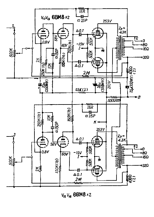

if you have a design in mind in line with the Sansui 500 circuit that you mentioned, it would be great if you could post a link.
I have looked at the original Sansui 500 circuit and it looks waaaaaaay too complicated for me. You'd be answering questions from the afterlife on that one.
Once you boil it down to the actual Amplifier circuit, it's simple, see attached.... You can substitute ECC83 and EL84's, adjust output transformer primary, the actual ECL82(6BM8) is also more than nice and you could use a generic EL34 PP Transformer.

OK-- as always, I gotta couple of questions:
In looking at the 6BM8, it appears to my stupid, stupid eyes that its a dual tube with one site being a triode and one being a pentode. If that's the case, would I only need two tubes per channel for this design with the triode being the phase splitter and the pentode being the output tube?
Also, since I've never worked with a PP before, I need to ask if the pentode stage is triode strapped-- it appears that it is, but you know how I think, so I'm probably wrong.
Furthermore, in addition, too, also, as well, I got more dumb ones for ya. There's like some funny-lookin' symbol thingee hangin' out in space above the 253V label over the bottom output pentode and I have no idea what this is. My first instinct is to bomb it and install a new regime, but I thought I'd ask first in case its important. So, WHADDIZZAT?!?
Bonus round:
It looks like there's a 500K input pot (see, I can do learnding!), so could this be driven from a preamp by just using a 500K resistor in its place? Oh-- and I'd like to know what the output power is and if this could drive a pair of Fostex FE-103s (~89 - 90dB SPL). I have some 206Es, which are plenty sensitive for SETs, so should be no problem with the PP, but I may wind up donating this to a tube audio-challenged friend.
And... one more...
Can I use one PSU for both channels here or would you strongly recommend two PSUs?
Yes.
I don't think so - see Jaap's schematic earlier in the thread. That's a triode strapped pentode. I'd suggest you try ultralinear connection for something different, and a little more power (but you know what going after power gets you, don't you Kofi?).
Yes. Shunted to ground.
It depends on whether you want a pair of dual mono amps or a single stereo one. One supply is cheaper and should work fine, especially if you're donating it to a friend. It's good enough for 'em.
Kofi
The amp in that schematic is pentode connected. Don't know what that thingee is, but the schematic looks complete without it. I'd go ahead and bomb it. Btw, if you build something like this, you might as well get opt's with UL taps. Then, when you feel that things are slowing down on the conflict front and you're bored, you can compare UL, triode connection, and pentode connection. Also, Kuei said, you can use ECC83 and EL84. One more tube socket is required, but the total number of connections is almost the same. Just one extra heater connection.
