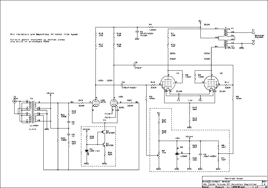

frank de grove posted a complete PP 2A3 in this forum... it goes to around 7 wpc
angela instruments also has a PP 2A3 with 6SN7 driver/splitter.
thorsten's comment on the EL84 supports most of my friends who's into vintage gear that the EL84 is hard to beat (subjectively) in sonics. i was thinking of making a Dynaco ST-35 clone myself.

Try both and see what you prefer. A p-p EL84 amp will be cheap, easy, and probably pretty good. To put it in perspective, the cost of my entire EL84 p-p amp was less than a single 300B tube.
Good information. The EL-84 does sound intriguing, but I'm thinking that the sound may be more clinical than the SET. Maybe what I'm noticing is the coloration of the SET?

Konnichiwa,
Define your aims. Do you want to:
1) Try cheaply "Push-Pull" sound to see if you like it (proceed to EL84PP)
2) Get an "Edge of the Art" high power PP Amplifier to drive these horrible powersinks masquerading as "High End Loudspeaker" (proceed to multiple parallel push-pull KT88, don't cheap out, 4pair Monoblocks are the job)
3) Get the best possible sound within a limited budget for your fairly sensitive speakers (proceed to 300B SE and build the Amp with a certain amount of universality in mind, methinks the DRD/Monkey with a D3a driver is probably best for that)
4) Something else I have not thought off
Sayonara
Sayonara
