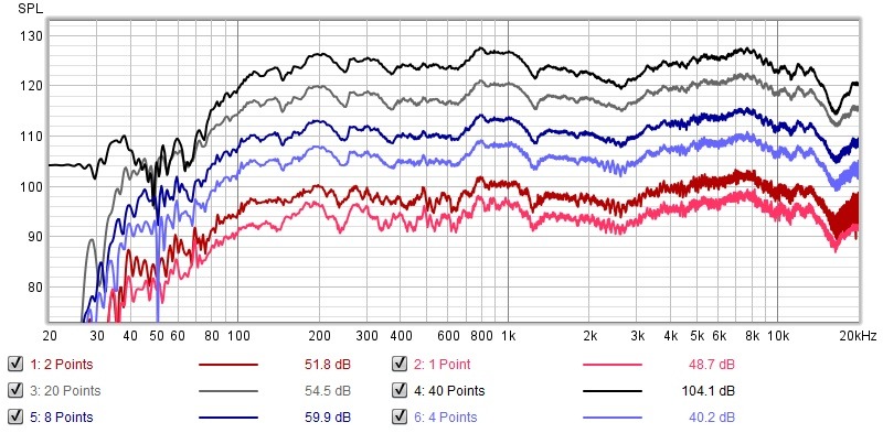

I used the data I collected last night to try and get an idea of how many measurement points are needed to get acceptable results. Again, the measurement points were taken at approximately 0.8" intervals between 37" and 71" away from a Behringer B2030P, but this time only selected IR's were summed together.
In descending order, black is all 40 points; gray is 20 points (just the odd numbered IR's); dark blue is 8 points (just the numbered IR's that end in 5); light blue is 4 points (just the numbered IR's that end in a 0); dark red is two points (just IR #1 and #40); light red is one point (IR #1).
I am very surprised just how passable even just 4 measurement points is.
Note that for this method to lessen the effects of the ground reflection, distance of microphone spacing from the speaker is imperative. So taking 60 IR's over a span of 3" won't get you anywhere (at least not below 1-2kHz).

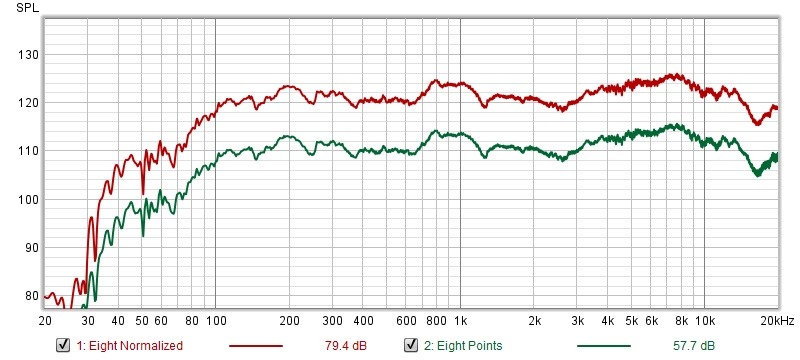

4dB is a lot on a linear scale. I'd adjust the amplitudes, not to a maximum, but so that the average over a about 10 - 20 ms. was equal and then add them up.
That may be asking more out of my available tools than they can provide. :)
I probably didn't do it the way you were suggesting, but this is the result I got:

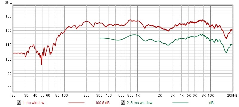

I only don't really agree with the idea that your whole measurement will be garbage by bigger time windows.
(you said short, but I think you mean bigger time-gate)
Nope, I meant short. Bigger IR windows are great. Best I can get is a 3-ish millisecond IR window when I measure in my house (green line), compare that to a 500 millisecond IR window (red). My point was that as window length decreases, so does lower frequency detail.
Oh yes, but that's a fundamental and intrinsic part of a time window
In this case I don't see any major differences, especially not ones that could not be see in any of those other measurements.

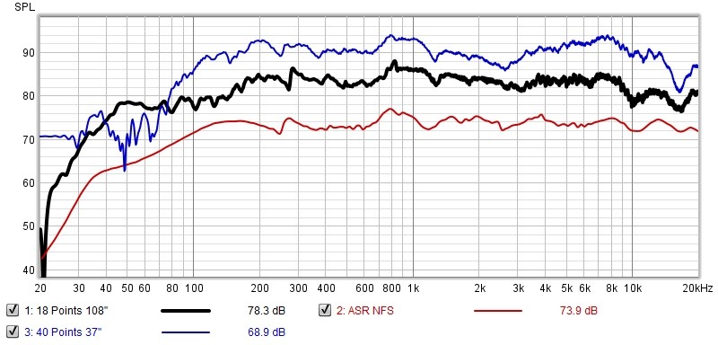

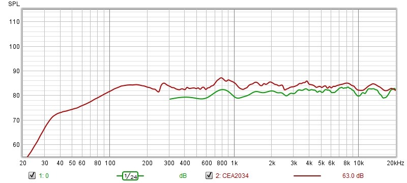

Another test with a lower elevation (about 43" rather than 84") and a greater total distance for the measurement points per Gedlee's suggestion. Using the calibrated microphone this time too! Although it might need to be recalibrated...
A different B2030P from my collection was used this time also. 18 points were taken at 6" intervals from 36" away from the speaker out to 144". And as before, no smoothing or windowing was applied. The black line is today's measurement; blue is yesterday's; red is ASR's.
Reactions: 1 user
It is good that you are trying different ideas. But using one loudspeaker is a wise idea as it will be the only constant to allow comparisons. Your loudspeaker not measuring precisely the same as Amir's is in no way a problem. Even in the factory not all brand new bouncing baby loudspeakers measure the same. You need serious quality control to accomplish this and Behringer is not know for this level of QC. I have worked on factory assembly lines as the measurement checker. And been in other factories that claimed to be doing QC is is farcical. Error windows large enough to fly a 747 through. But they passed QC! Tight QC starts with every driver being measured, then the system and then the final assembly. And keeping a tight 1 to 1.5 plus or minus standard. What I see in the differences between your measurements and Amir's is a reasonable deviation between samples. Possibly a lack of lower frequency resolution. But this may be a function of the math behind the Klippel measurements and curve fitting (Perhaps smoothing) versus actual measured points. Every method of measurement uses some smoothing. It is in the nature of the math that areas are defined as beneficial or not and displayed or rejected.
