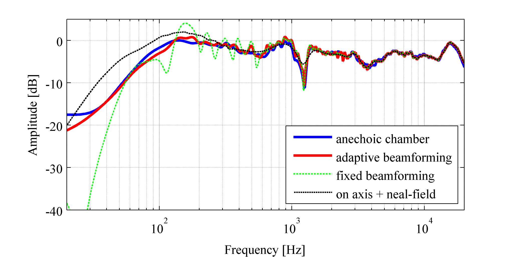

I thought I'd share an update to this project:
With thanks to a suggestion by user NTK over at Audio Science Review, I tried an experiment tonight (the technique is detailed here and here, and conceptually very similar to this). The method is to sum multiple impulse responses from along an axis radiating from the speaker under test, the idea is that randomly differing reflections will be smoothed out but the desired response from the loudspeaker will remain. However, previous examples of this technique have been performed in rooms, so a minimum of six reflective surfaces and modal behavior of the room are needing to be overcome. This experiment was to see how the technique would fair outside with only a reflection from the ground to contend with.
It was a quick and dirty experiment in my back yard, so road construction, neighborhood and bird noises are in there. Plus I didn't want to run the measurement sweeps too loud since it was after 8:00PM... and I wasn't super careful with mic placement. So this ain't laboratory grade. Nevertheless, I think the results are still significant. The process was to sum 40 individually taken IR's in Audacity and export that sum as a .WAV file for import into REW. The measurements themselves were taken on roughly the tweeter axis of a Behringer B2030P starting at 37" away from the speaker and ending at 71" away. The speaker and microphone were about 7' above the ground. Below are the results with no smoothing or IR windowing. The black line is the processed data; the gray line is a single one of those measurements used in the process for comparison; the red line is a Behringer B2030P measured by Amirm at Audio Science Review on his Klippel NFS; the green line is another one of my 2030P's measured several years ago in my living room just to emphasize the difference. Again, no IR window or smoothing has been applied to any of this data.
As another comparison, in the linked paper by Daniel Krol, where this experiment was inspired, 100 measurement points and algorithmic processing were used to get the following in comparison between anechoic and this quasi anechoic in room measurement method:
More investigation needs to be made to refine the process, and to see just how few data points are needed to get useful data, but it is a promising technique for DIY'ers to get a better look at what a speaker is doing below 1kHz... even if it's not a Near Field Scanner on a shoestring.

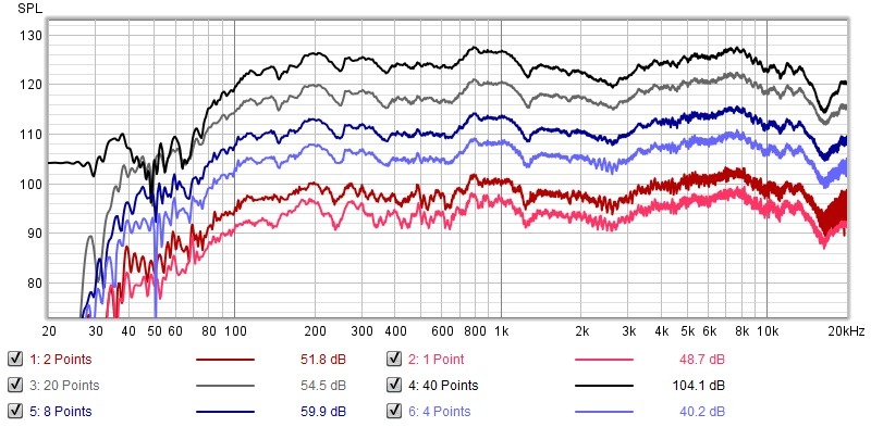

Another update:
I used the data I collected last night to try and get an idea of how many measurement points are needed to get acceptable results. Again, the measurement points were taken at approximately 0.8" intervals between 37" and 71" away from a Behringer B2030P, but this time only selected IR's were summed together.
In descending order, black is all 40 points; gray is 20 points (just the odd numbered IR's); dark blue is 8 points (just the numbered IR's that end in 5); light blue is 4 points (just the numbered IR's that end in a 0); dark red is two points (just IR #1 and #40); light red is one point (IR #1).
I am very surprised just how passable even just 4 measurement points is.
Note that for this method to lessen the effects of the ground reflection, distance of microphone spacing from the speaker is imperative. So taking 60 IR's over a span of 3" won't get you anywhere (at least not below 1-2kHz).

How do you adjust for the level differences in the impulses? Just normalize every IR to have a peak value of 1.0?
I didn't, actually. I had been thinking of normalizing the IR's like that when I exported them from REW, but for my initial experiment I just exported them as is. There was only about 4dB of level difference between the closest and farthest measurements.
4dB is a lot on a linear scale. I'd adjust the amplitudes, not to a maximum, but so that the average over a about 10 - 20 ms. was equal and then add them up.
