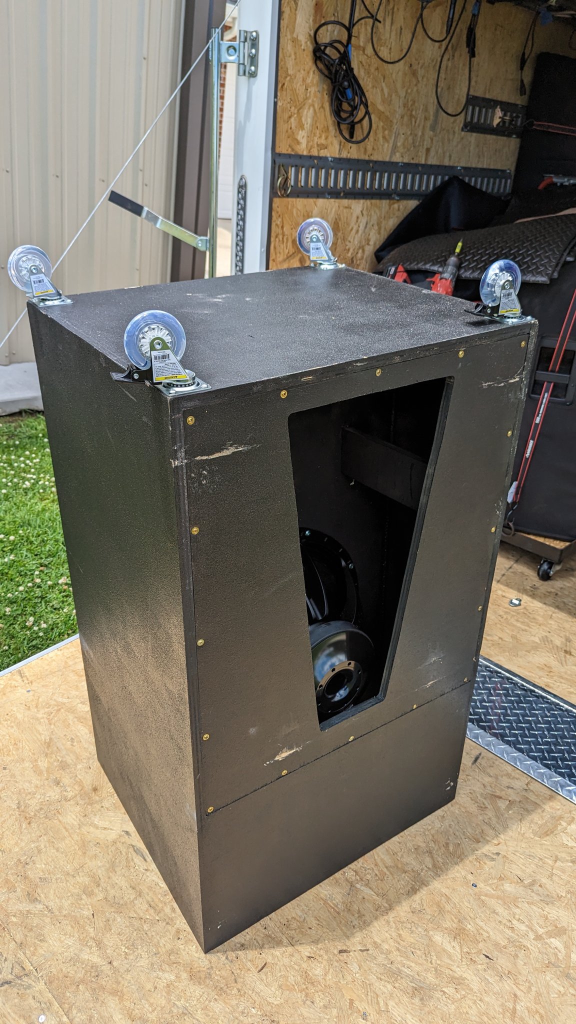

Today I did a thing.... Installed wheels on the bottom of my keystones. I bought some $4.99 casters from harbor freight and installed them as close to the outer edges as I could. I plan on locking the casters facing out to get as much of a big footprint as I can. I'm not doing any outside shows where it's going to have any wind blowing, and normally there's nobody anywhere near my speakers, So I feel pretty safe with it. I'll be adding some small handles on each side this week and I'll post that update.

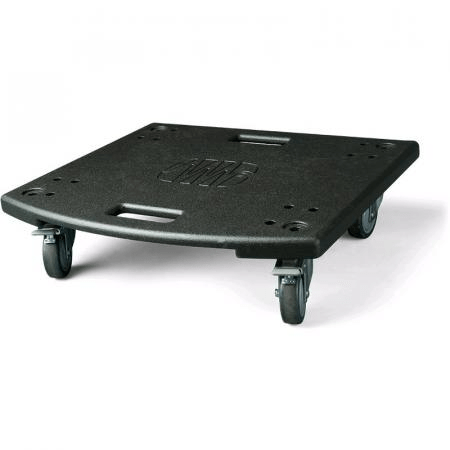

yeah you need to spend more on wheels this brand seems OK in the UK: https://www.penn-elcom.com/default.asp?MC=01120101&LG=EN
although IMO any caster can sometimes be annoying so I prefer wheel boards.
like this, sometimes there are latches to hold the sub in place but they are not really needed. You can also only make a few boards and then take them back and forth as you unload. If your using a van a van ramp is also a good idea, tail lifts are very heavy which eat into load capacity for keeping under 3.5T in the UK.
