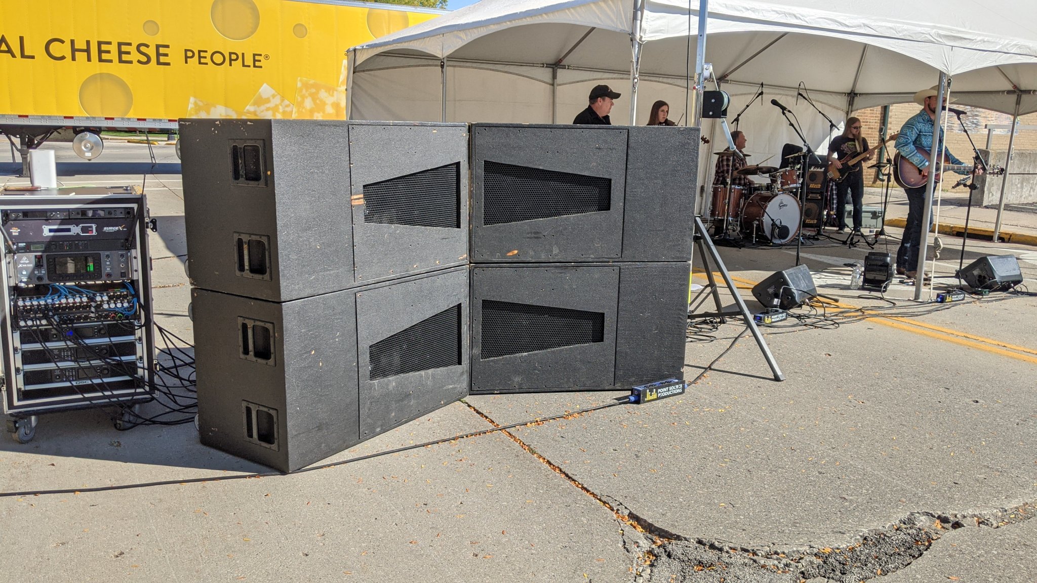

So I've got a few gigs under my belt with the 4 keystones and I'm now curious about different ways of setting them up. I ran one gig with them setup in 2 separate stacks and had issues with a power alley that was to be expected. The last gig, we ran all 4 in a row at the front and they sounded great but I'm a little bass fiend and I always crave more! Now the question I have is in regards to a picture I saw a little while ago where someone stacked 4 keystones on their side in a v formation. To my understanding (limited) the keystones need to be upright as they benefit from the ground plane effect but if I ran them in a wedge formation upright, would there be a noticeable increase in spl at the cost of dispersion? Would Running them like this with ply over the top of them to create a large horn be beneficial at all? Unfortunately I don't have the space to set them up and play with them bar just before gigs and things are normally a bit mental on that front!
@watafu I have done four stacked in a V. You may have seen my pic on the DSL Users Group page on Facebook.
I would say that you don't lose ground coupling anymore than you would stacking double-18's. Mouth-to-mouth in this configuration, there's an insane amount of bass available. Turning the boxes into a V creates an even larger horn with more gain and directivity. This setup gave me head-to-toe bass.
I regularly run all four laying down. Usually the center two mouth to mouth and then the outer two with the mouths inward. I feel that gives the most even response. I've also done pairs of mouths. No huge difference, except that in smaller rooms there's a larger center of less bass in the middle when you're up close. That can be good or bad depending on the gig. I have a lot of fans that like to get close to the band where they're not hearing the main speakers anyways, so having that pocket can be advantageous to not blow them away.
That being said, these feel like they go past the first few meters of people before they really kick in, like most tapped horns.
Perfect answer, I think for the gigs we run which is mainly EDM in a long narrow room the wedge formation might be exactly what I'm looking for! I think I'll definitely look into trying this out for the next gig. While I definitely don't think we where lacking in bass at the last one, it's always a bonus if we can gain a little more with physical alignment and take the strain off of the amps and drivers a little. How are you strapping your cabs that way? I figure you could ratchet the pairs of cabs and I don't think they would want to walk about too much but it's always a concern mid gig!
