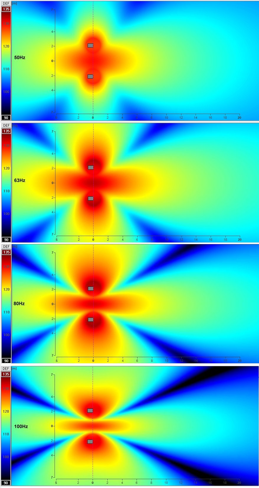

Easy to model - ASSUMING the setup is outside with no reflective boundaries (ie walls) nearby.
Here's 2 subs at your suggested 4.2m spacing at 50, 63, 80 & 100Hz.
As the interactions are wavelength dependant, we can see that once we are an octave above the target frequency, the main lobe of the coverage pattern is ~half as wide and the side lobes are substantially larger.
HTH,
David.

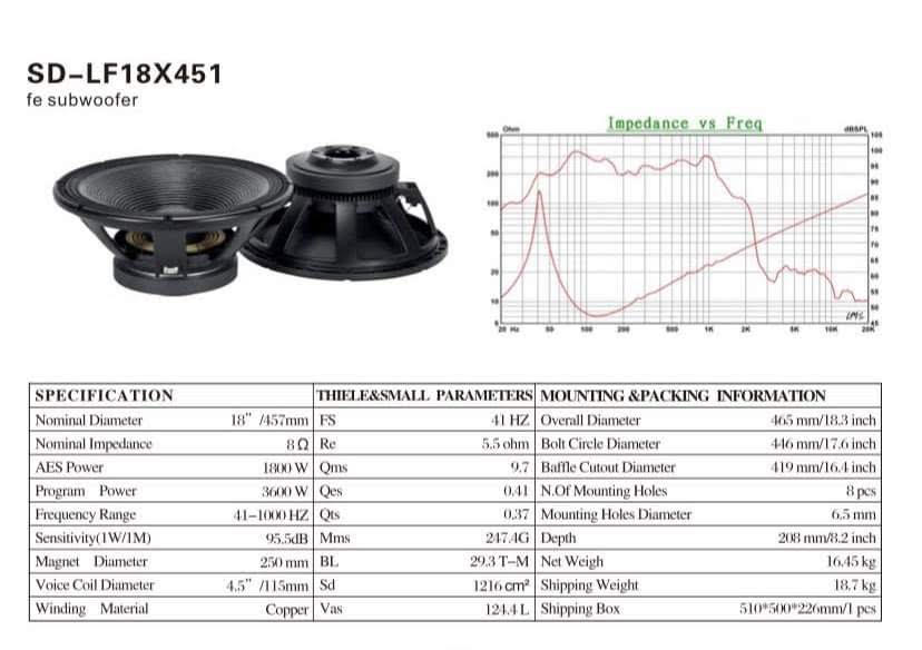

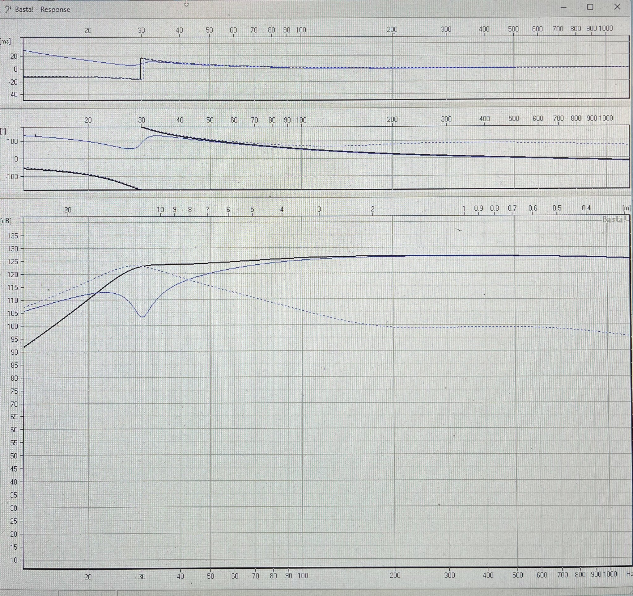

I have some chinese Lase 18" drivers. they are a rcf lf18x451 clone. Currently I have them loaded into reflex cabs tuned to 30hz but the output that low just does not seem to be there. I don`t have a way to measure them but I think I saw in the past @weltersys is in deland fl which is about 20 min away from me. I am hoping he can help me measure these or discuss if they would work good in the keystone to get me down low. I have attached the Basta prediction with the drivers advertised T/S. I have heard that drivers do not go well below Fs and also Heard that it does not matter, Please HELP!
Hope you can measure the real T/S parameters, there is a device that cost around 150 that can help. Don't remember the name but you can measure the real T/S of a given driver...just a side note ,even brand name drivers sometimes deviate more than the adequate from the published specs, I guess the Chinese drivers QC is not that much tight so no wonder you don't have low end in your enclosure

Output drops considerably when a cabinet is tuned as low as 30Hz- the Keystone Fb is around 36Hz.
If you really want to get down to 30Hz with efficiency, the cabinet has to be big.
The LASE LF18-3600 18" has a 4" voice coil, the RCF LF18x451 has a 4.5" voice coil, so without going much further we can assume the TS parameters won't be the same.
If you have valid TS parameters for the LASE 18", you could plug them into Hornresp and see how it compares to other drivers.
