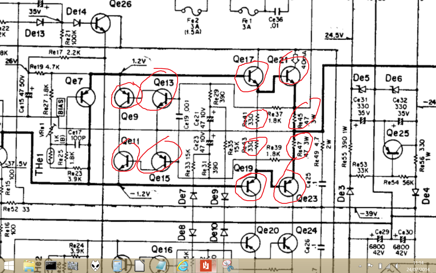

whilst attempting to adjust the bias on this amp, my probe slipped and i shorted the Qe23 side of Re47 to the Qe19 side of Re43. this introduced an immediate hum, and amp now draws excessive current. i immediately shut down the amp. thinking that i may have stressed the smoothing caps Ce29 and Ce30, i replaced them (not cheap-GAK!), but still have the same hum and current draw.
any suggestions you guys might offer would be greatly appreciated.

Not the caps... you will have blown one or more output transistors and possibly the drivers as well. Check all the low value resistors around the output stage for damage too.
(Its a dead easy repair if done methodically but you will need suitable (alternate) replacements and please please please :) use a bulb tester to prevent damage)

All these need checking. Tbh I would automatically replace the outputs and drivers (the four on the right). The other transistors may/may not have suffered but they cost buttons.
You won't get the originals, you'll have to fit alternatives. The physical style of the outputs determines what will be suitable, the others its less important.
But you really need to do some basic checks first just to confirm what has happened.

Shorted transistors in many possible areas such is the Vbe multiplier , driver or output area is the cause of excessive current
In no case i think that an open resistor will cause excessive current draw
I am sorry to say that if you have blown the outputs you are doomed since these are totally unobtainable
In this case choosing replacements will cause mounting issues and the choice of replacements is a very tricky story since this amp is already marginal and poor choice of even good transistors will end up to catastrophic oscillation .
If outputs and drivers are to be replaced both bias scheme and compensation needs to be replaced with other values
You got your self a real trouble ...
Nobody please rushes in to suggest 1943-5200 or MJE 15030 for drivers and outputs been tested a million times and not working properly there ...
Been there a million times

I can see the output transistors being a problem because they are physically an old obsolete type looking at the picture in the manual. That means you need to be sure you can physically mount a replacement on the heatsink successfully using a single nut/bolt together with the correct insulating kit for the replacements. Its all easy stuff, just something to be aware of.

Looking at the transistors on this and I think I would go for TIP41C and TIP42C for the outputs and probably MJE340 and MJE350 for the drivers.
Look at the TIP 41C attached. You need to be able to mount that on the heatsink. It would need the appropriate insulating kit too (mica/silicon washer and bush).

It will not work
VAs has not enough current to drive MJe 340 or even BD 139 or 140
Bias will be altered like hell and will not work unless modified
Cob is different compensation also needs to be altered
Plus that TIP series is waaaaaaaaay slower than the originals resulting a degrade in the total quality of the amplifier ...
Load resistors for both drivers and outputs will need to be replaced and the all thing will end up to a mess
I can suggest an already tested set of semis if you like that is more "drop in "
1) outputs can be C4467 A1694 one drill per transistor and one insulator and its done the physical size of the trs and the pcb pads will fit with no probs The specific transistors have been outsiders which means that are real performers from sanken and seems that these can easily be found dirt cheap and original
2) drivers should be 2Sb560 2SD438 small and very easy to drive also possible to obtain also given as replacements in some other Kenwood similar models ( by Kenwood)
3) Bias will be fine like that and if not altering Re 27 will bring bias in a reasonable adjustable level
4) in some models i have seen some oscillation with this modification and cured it increasing miller cap on the VAS Ce 11 from 22pf to 33
Been trying with Mje150xx series for outputs as these seem to be almost capable to handle the current but it was impossible to drive them the circuit goes to oscillation
Been trying to place 1943 5200 impossible to drive then went to BD 139-140 for drive then impossible to be driven from VAs + oscillation while in all cases bias went to hell
Circuit is too thin and delicate and needs transistors that are easily driven
