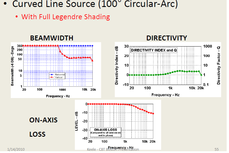

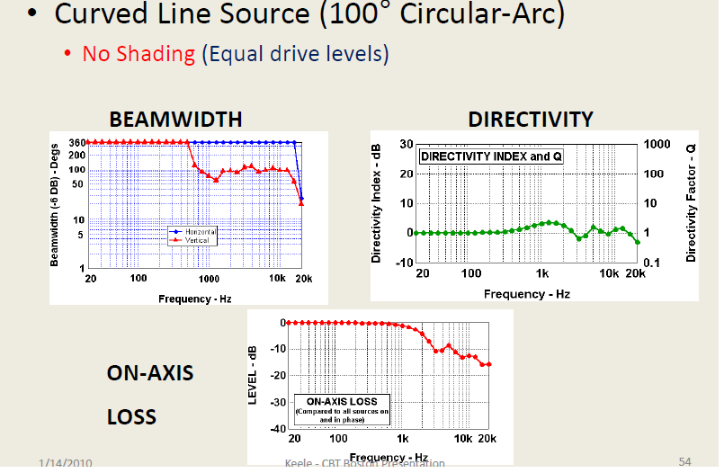

Hi Pano, I know that shading is important. An if you ask Don, surely he will tell you its important. But I am not so sure how very important it is.
People are listening to straight line arrays, some are using power tapering, some are not. Which ones are right?
You see, the whole concept of array is already an compromise. Sometimes we have to make right compromises, sometimes not. When it comes to the shading in Keele's CBT, I am not so sure its absolutely necassary. See, the curved shape is already doing great job! Please compare the two pictures attached (I hope it works, I coppied them from Dons lecture).
As you can see, there is not that much difference in directivity and beamwidth. Its much smooter in shaded, but its not that different.

Now to continue the discussion, for me there are cons and pros for Legendre Shading. Offcourse Don will tell you its essential, he is probably perfectionist. But to me the added complexity is a drawback. I have heard his CBT array at RMAF this year, I talked to him. My concern with shading is that those poor little fullrangers at the bottom of array, those 0 dB ones are working hardest, you can see them moving!, yet those ones on the top are barely working. And all that added complexity in the wireing of the crossover.
And the benefit? I admit, nearly ideal directivity index. Well, nothing is ideal, and believe me, the listening room will brink way more irregularities than Legendre shading or not. Having all sharing the same power gives me way more room for power handling, I guess.
My opinion.

Yes, but a valid one, I think. It's an interesting question. Keele's charts certainly show improvements with the shading, but it isn't night and day.
I also saw those poor little drivers down at the bottom working real hard and smelled the hot resistors!
Considering the killer price you got on the drivers, you might end up spending as much on the shading resistors. Of course I really want you to try it and report your findings on the differences, but I'm not buying the resistors nor doing all the wiring, am I? :p

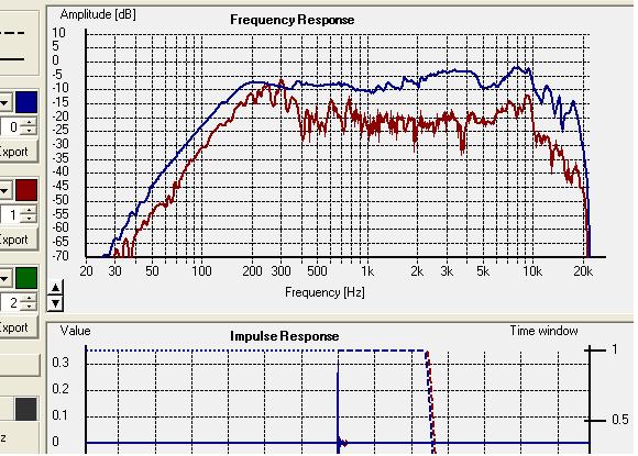

i thing that much more interesting overlay is this
this is 1ft infront of the cbt array, again, no eq, in the middle of array, directly in on axis, (blue) than 20 degrees of axis (magenta), and 45 degree (green) of axis...
i thing it nicely shows cbt behaviour
(i took more angles, 5, 10, 30...but the measurement just fits righ in beween shown)

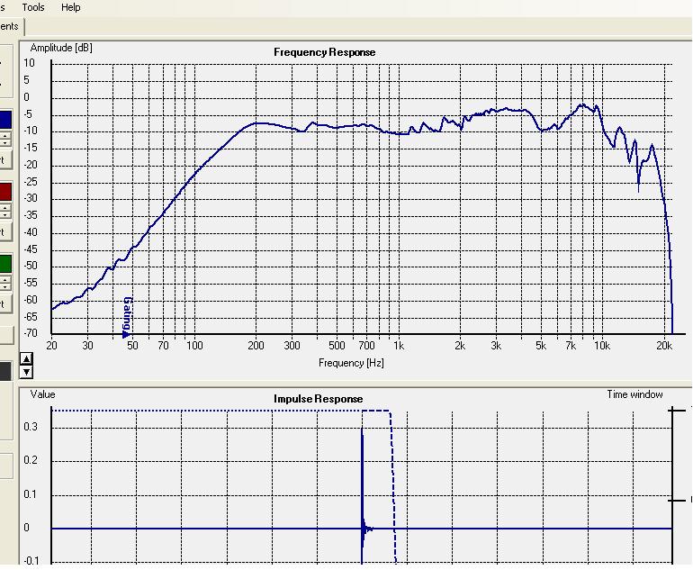

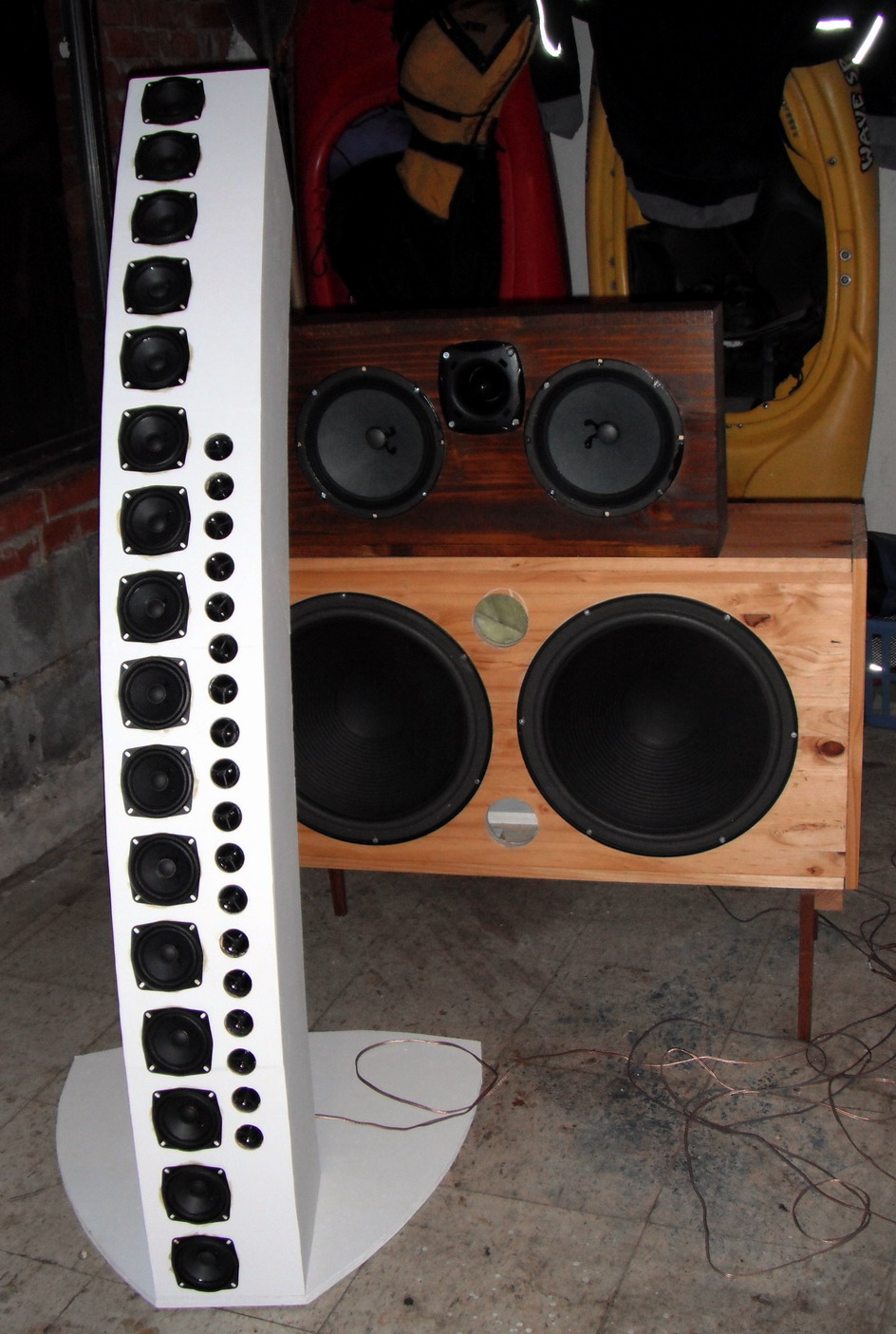

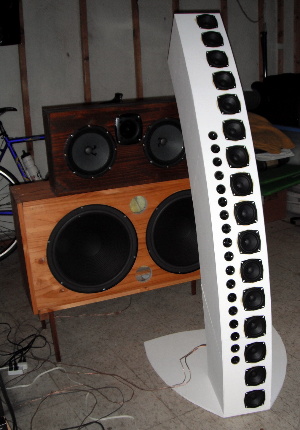

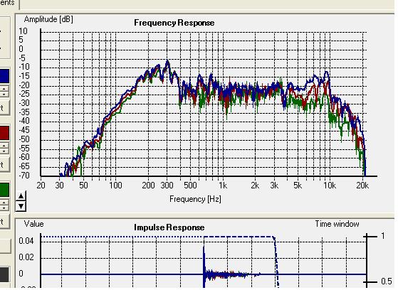

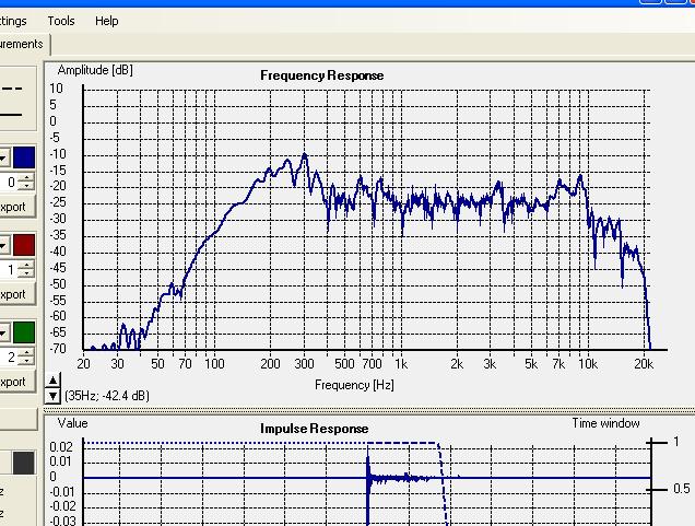

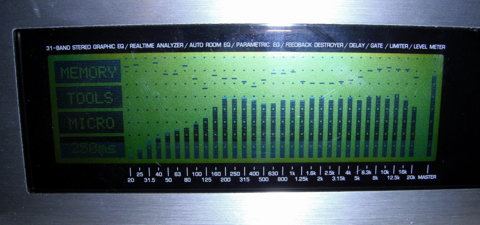

since the 3" auras rolled of after 10k, I had to put tweeters on those
I added 18 tweeters, wired as 16 ohm to match midranges
crossover is single cap only
attached are two pictures for those who are interested
also the fr response with tweeters (no sub attached, just an array)
measures well, sounds good

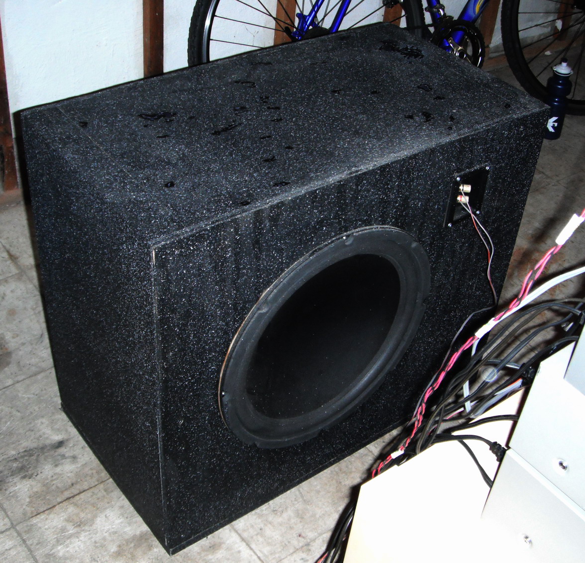

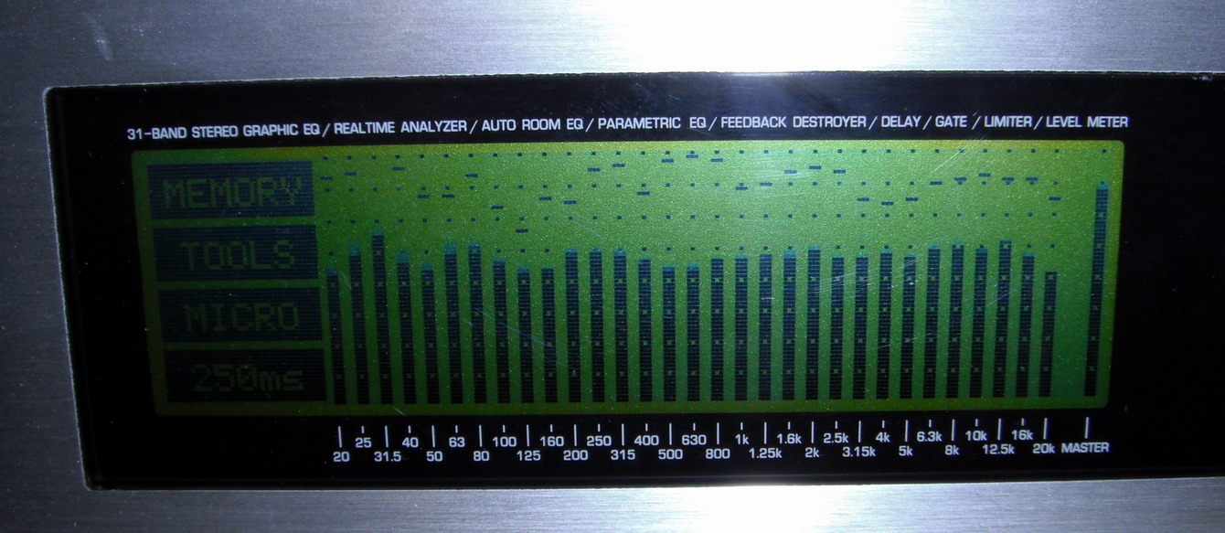

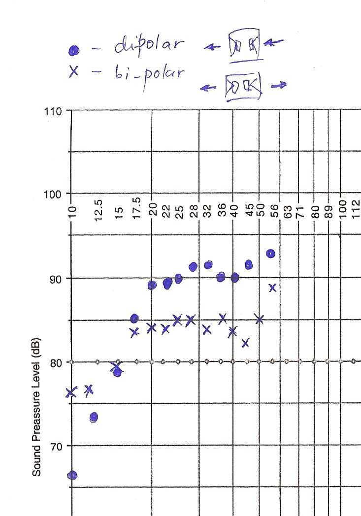

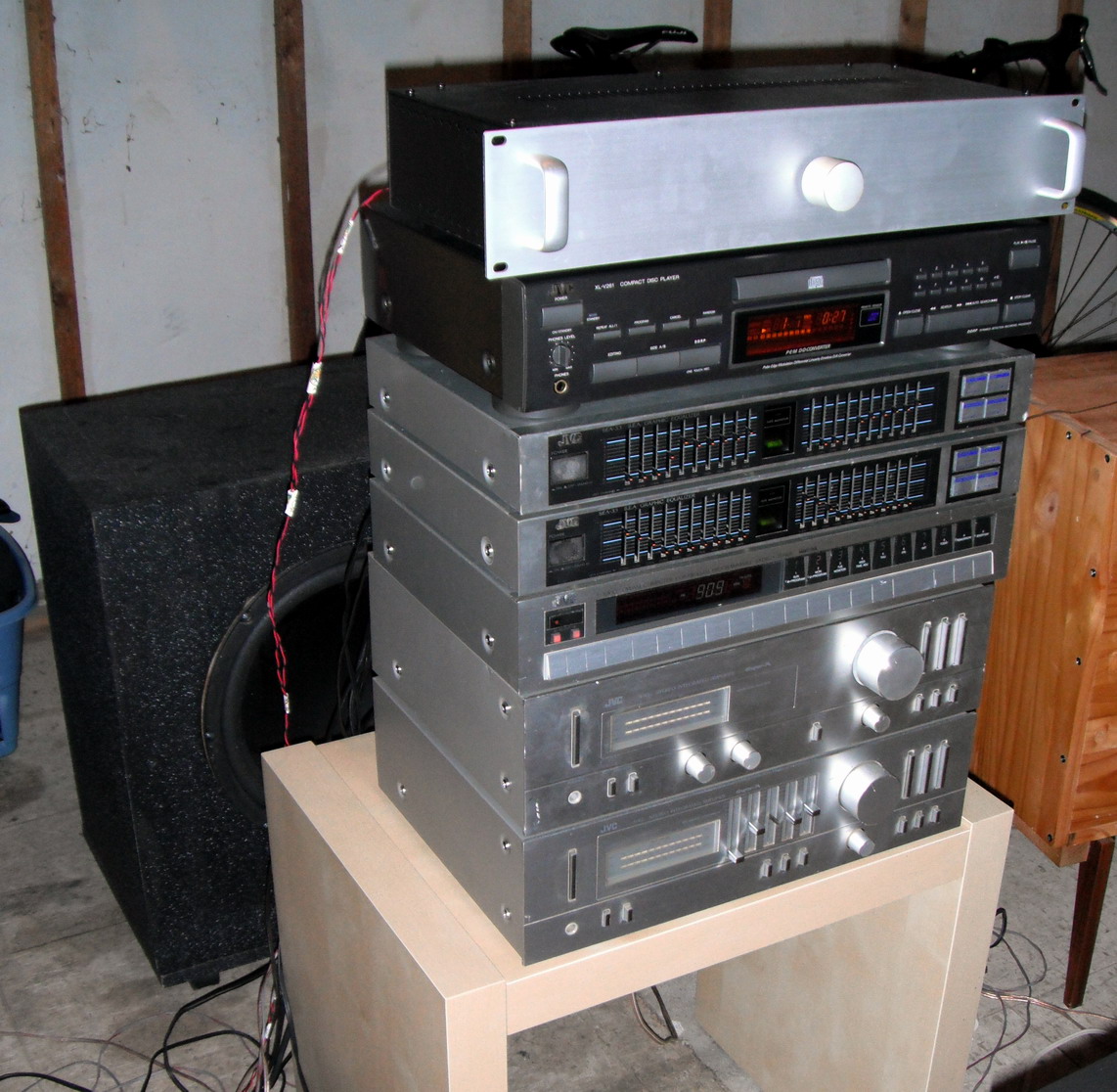

now, when I was adjusting the subwoofer level, something strange happened...
(this is old ugly sub which I use as stand mostly, but this time I had to put electronics off the sub, since it was shaking the cd player quite a bit
its a closed box of unknown volume, pretty big, with two 15" woofers
yes, there are two woofers, one on each side
the woofers are BOSS unknown model)
anyway, long story short, I tested the subwoofers configured as dipol or bipol
simply by switching the polarity on one woofer
subwoofer sounded much better in di-polar configuration, the bass was cleaner, deeper...
so I wanted to verify what I was hearing, so I did more detailed measurement
what measurement showed was that not only there was no cancelation or loss in di-polar woofers arrangement, there was gain ~5-6 dB!
I recommend to experiment with di-polar subwoofers, it seems to me that when woofers are not fighting against each other, creating big ups and downs in preasure inside the box, they move more air in the room
that's what my measument shows anyway, and I am sure many will not believe
I have no special theory about it, just that in di-polar arrangement the membranes move in unisono, so they move more freely, when in bi-polar configuration one is preventing the other to move

Thank you for the RTA readings,
I'm still breaking in my box of NS3-16's, 31 of them completed and will start building the new bezels in two weeks. Such is the slow progress in the winter as I have an affinity to breaking in speakers when the temps drop below freezing.
After listening to my 2-way line arrays, I've come to the conclusion that in the upper treble range, they hit a "wall" and the output of the line hit's it max at the higher frequencies and any additional drivers adds sound output to lower frequencies.
My wild guess is by using 21 drivers, the output should increase below 2KHz but not above it, maybe smooth the response even flatter? I'm crossing the NS3's at 400 and 6,000 Hz to woofer and tweeter lines so on paper--it is looking better all the time.
Thanks again for the results--I'll have mine in about a month and hope I can get close to your readings.
