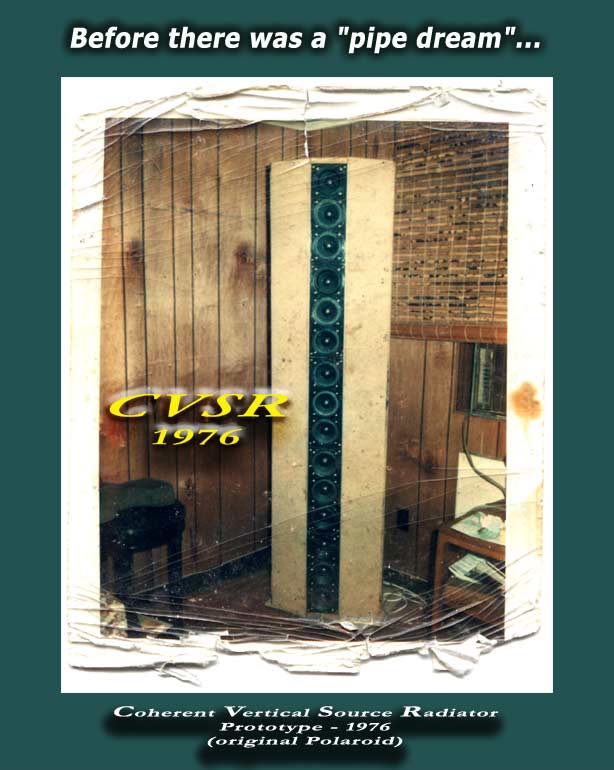

Here's a pix of an array built in ~1976.
A Peerless 5 1/4" driver - tweeter set up not shown.
