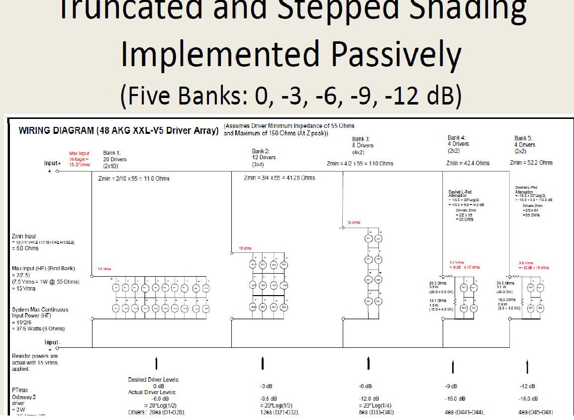

keele line array, bad start...

Seriously, when I first saw a picture of Don Keele's array, I thought he had finally flipped his wig. However, I received a private e-mail from someone I hold in very high regard, that he had been there and listened to them. He stated that they're the real deal, sounded very nice and that I should read Keele's paper.
Regarding focused arrays, I believe that it solves many of the intrinsic problems that plague vertical arrays. If properly designed, they can eliminate comb filtering, as well as the timing (or phase issues) attending the disparate distances from the drivers to the listening position that vertical arrays present without elaborate measures being taken.
Adason is correct in saying that the listening spot is narrow, at least vertically. But it does seem to provide the taunt intensity of a lucid, phase coherent presentation, with what I believe is a sense of unlimited scale that one often associates with highly efficient horns.
Speakers are so subject an individual's taste, that I wouldn't argue with what anyone doesn't like. It may depend on how they're designed, what drivers are used, crossover frequency and a whole host of issues that are found in any design.
Mine were crossed over at 450 Hz (1st order high-pass/2nd order low-pass series). I flatter myself (perhaps with insufficient cause) that the low crossover frequency, coupled with a series crossover and the very extended range of the drivers used in the array, combine in such a way as to offer sonic rewards. For critical listening sessions by one's self, or with a couple of people seated within the sweet spot, they seem to be quite nice. They are not, however, going to sound as good anywhere else in the room and I wouldn't recommend them as a "Social" or party speaker.

Well I was there at Dayton with Don Keele and his array. I saw the array and some prototype panels.
For the type of array, it either has to be curved, or the drivers delayed - period.
From what I saw, the curve is not the hard part. The baffle face was done in thin MDF then bent to fit the curved sides. With all those holes, the baffle face was quite floppy. The baffle had been made by CNC for all the holes and the driver insets.
The curve gives the drivers their delay. A resistor network shades them for amplitude. They were shaded in groups of 4, IIRC, not each driver.
Again, I don't think the curve what be that hard. Make a big pivot for a router or Rotocut and off you go with the sides. The tedious part would be all the driver holes. Not so bad if you don't countersink them - just a hole saw. I say go for it! It's the best array I've ever heard.

that's what I need to hear, thanks bear!

I was about to built it, but I do not have any fancy tools, so was wondering how critical the shape is. Some folks here say its very critical and that my result will be worse than normal array.

Just want to let you guys know, that those 3" 16 ohm fullrange drivers are sounding really nice. I just slapped 4 of them on cartoon box, wired them all in parallel for 4 ohms and they are sounding mighty nice. They go pretty deep, and with little lift in the treble sound balanced. Nice. I am looking forward to the project now.
