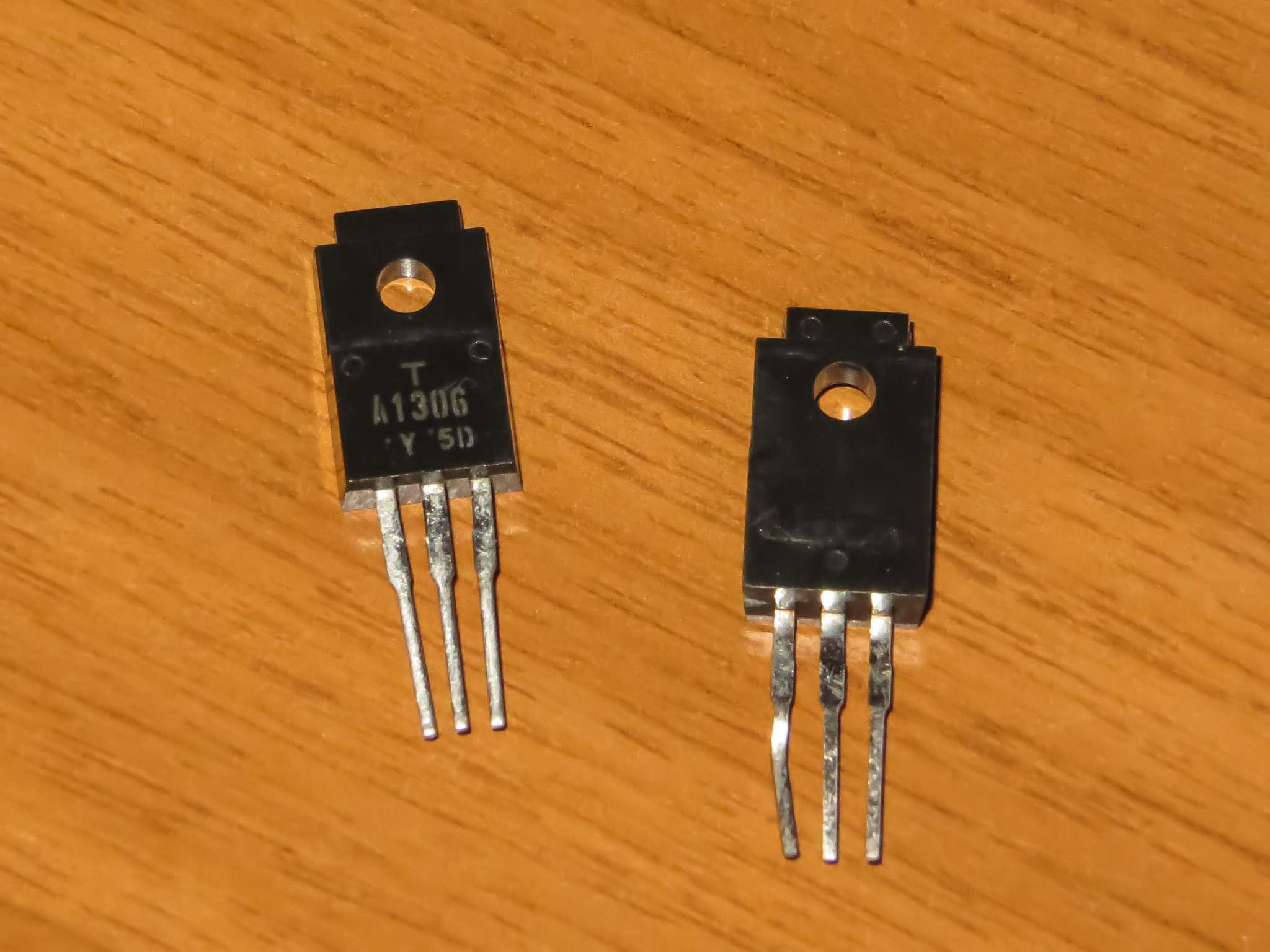

I dont know if the 2sa1306 in my possesion are originals so i'll post a picture for reference.

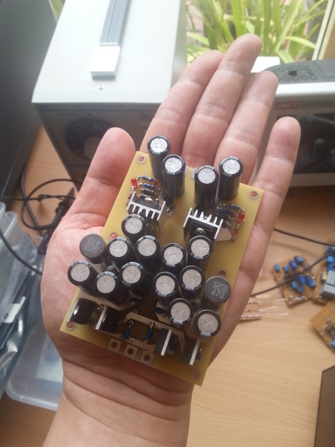

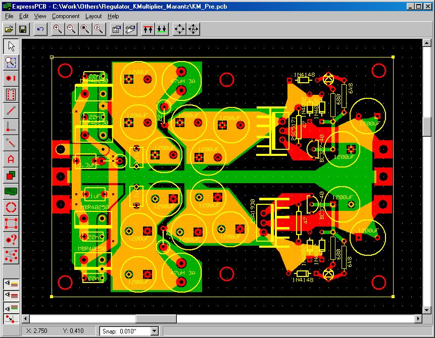

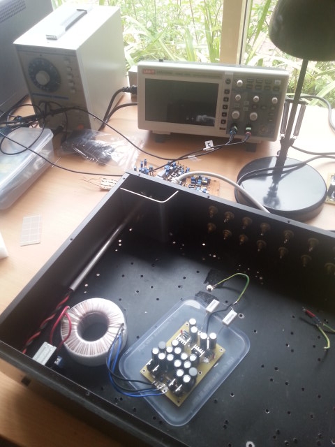

Finally I have built and tested it on the ExpressPCB manufactured PCB.
First it was a catastrophic failure - the rectifier diodes on the PCB drawing (the one I published earlier) have the polarity swapped. All of the newly bought 16 x Panasonic FR (argubly the best of the best) capacitors 25V/1200uF went to heaven. I trashed the whole board and kept only the ceramic capacitors, inductors and ferrite beads, and the rectifier diodes.
Now it is working fine on a new board. I have turned it on and off a few times and there has been no smoke. With the way I tuned it using 1 x 1N4148 and 6k8 resistor, the voltage drop is about 1.3V, which is possibly the lowest voltage drop achievable with the KM. I can't see any ripples at the output with my 100MHz digital oscilloscope, only noise at the noise floor. Measurements matched the specification / LTSpice simulations.
For purpose of testing, I used 680R at the output which drew 25mA current only. The voltage at the first C of the CLRC after the recifier bridge was at 18.3VDC from my multimeter. The red LED was brightly lighted at turned on, and fade away within 4 seconds. The voltage at the output was initially at 16.5VDC a few seconds after turned on, and slowly reaches at 17VDC after about a minute.
The PCB does not have silk screen layer so soldering is slightly less convenient. It was the first time I tried ExpressPCB and did not know the default gap between the ground / power plane and component pads was rather small so soldering is once again requires much care. I used a magnifier to examine the board to be sure it has no shorts after the built. This is a lesson I have learnt. I won't be using ExpressPCB from this point on as I have bought Sprint Layout 6 for future printed circuit board work. Though I have to confess ExpressPCB is probably the easist to use.
Bill
