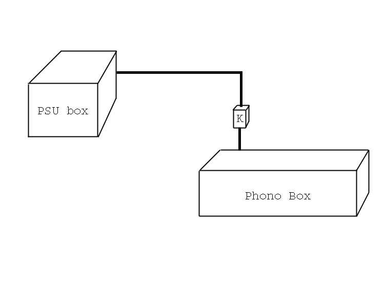

OK, since builds differ here is what I would propose then. An independent KM made as an in-line add on wherever there is a raw PSU umbilical. In a mini box, metallic and grounded if possible. Using in/out connectors too. That way comparisons are made easier or overall system synergy can be checked and modified in no pain.
That is what I did.
That is why I can easily plug it between the several psu's and amps.
