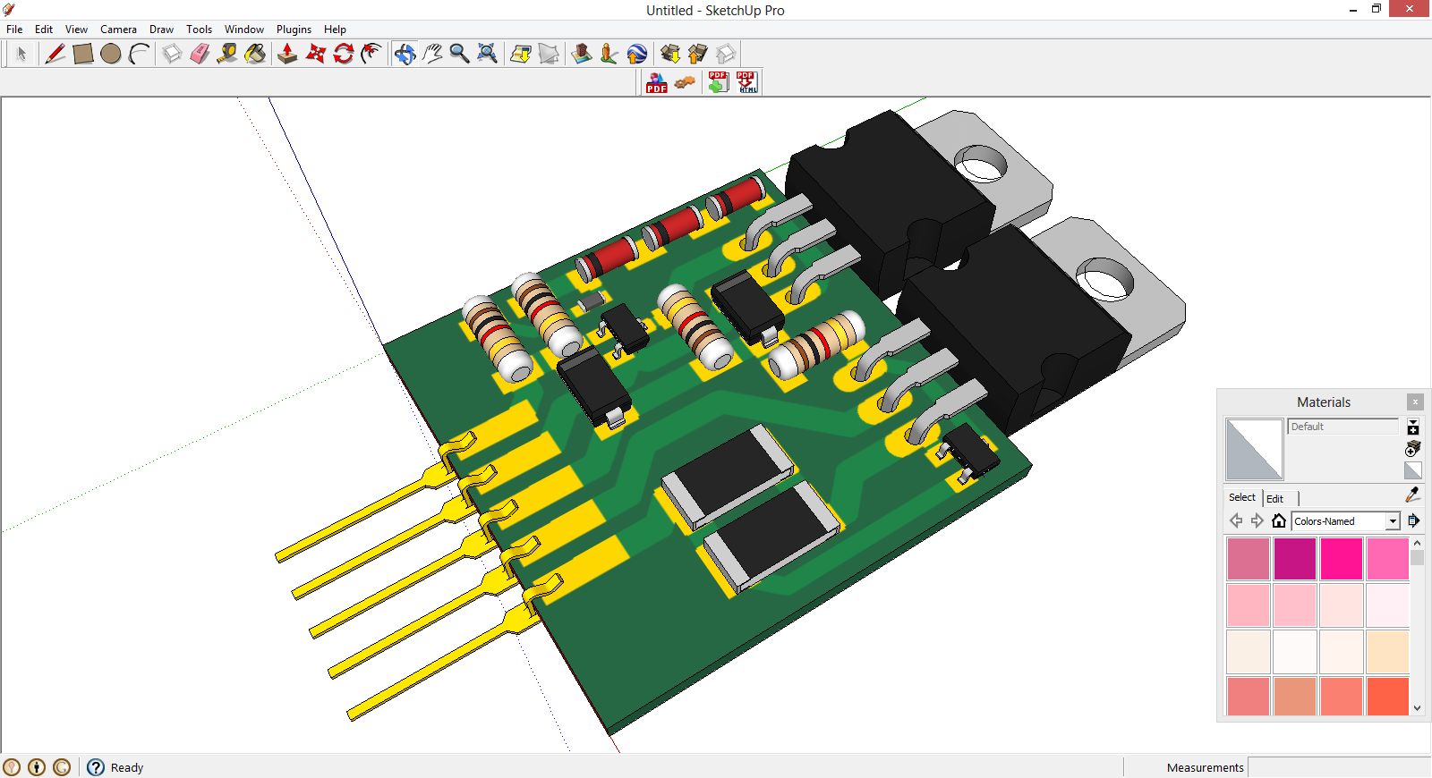

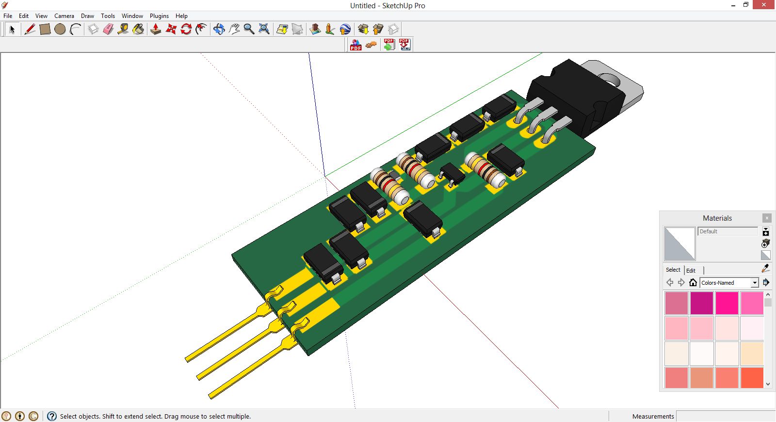

Keantoken's CFP cap multiplier
... and for the last publishing...
Nice. It's tall enough to not fit in many places though. I wonder if it could be shortened? I like the idea of replacing 3-terminal regulators with it. :)
However for that I'd make it zener regulated so people don't try to use them in a circuit that needs a constant voltage.
I would add decoupling to the input and output, because we don't know what it would be plugged into.
like regulators, decoupling caps are to place externally and the user choose the capacitor value and type (to ground).
The PCB fits on a Fischer Elektronik SK104.
Direct Heated Tubes needs a constant voltage (300B +5VDC) done by, rectifiers, caps, pre-regulator +5VDC+1.8VDC, caps, and K-Multiplier to achieve the needed +5VDC for the first pole of the heather; connect the current sink (2SC5171 + BC817-40 + 1k0 to +6.8VDC + 0.6V/1.2A = 0.5R@2W/1%/2512 resistor) on the second pole ... in french, le tour est joué!
There is here a Rob Coleman DHT thread...
For bias current, it's diminishing returns after 100mA, and I'd set it low at 25mA so it's not wasting 1/4 of its power out of the box. At 25mA the emitter resistor for the current sink will dissipate only 17mW, so don't need large resistors here. Add some vias for users to solder in their own sink preference?
If the current sink feed resistor is 56k it will work up to 100V (resistor will be hot though, how hot should we let resistors get for longevity?).
