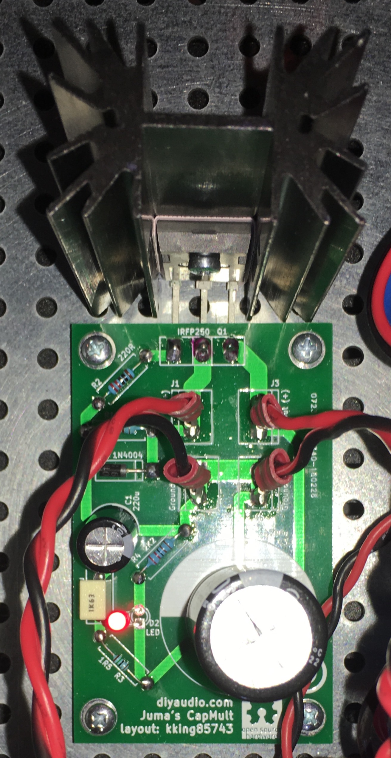

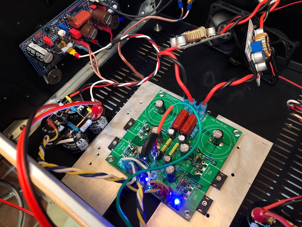

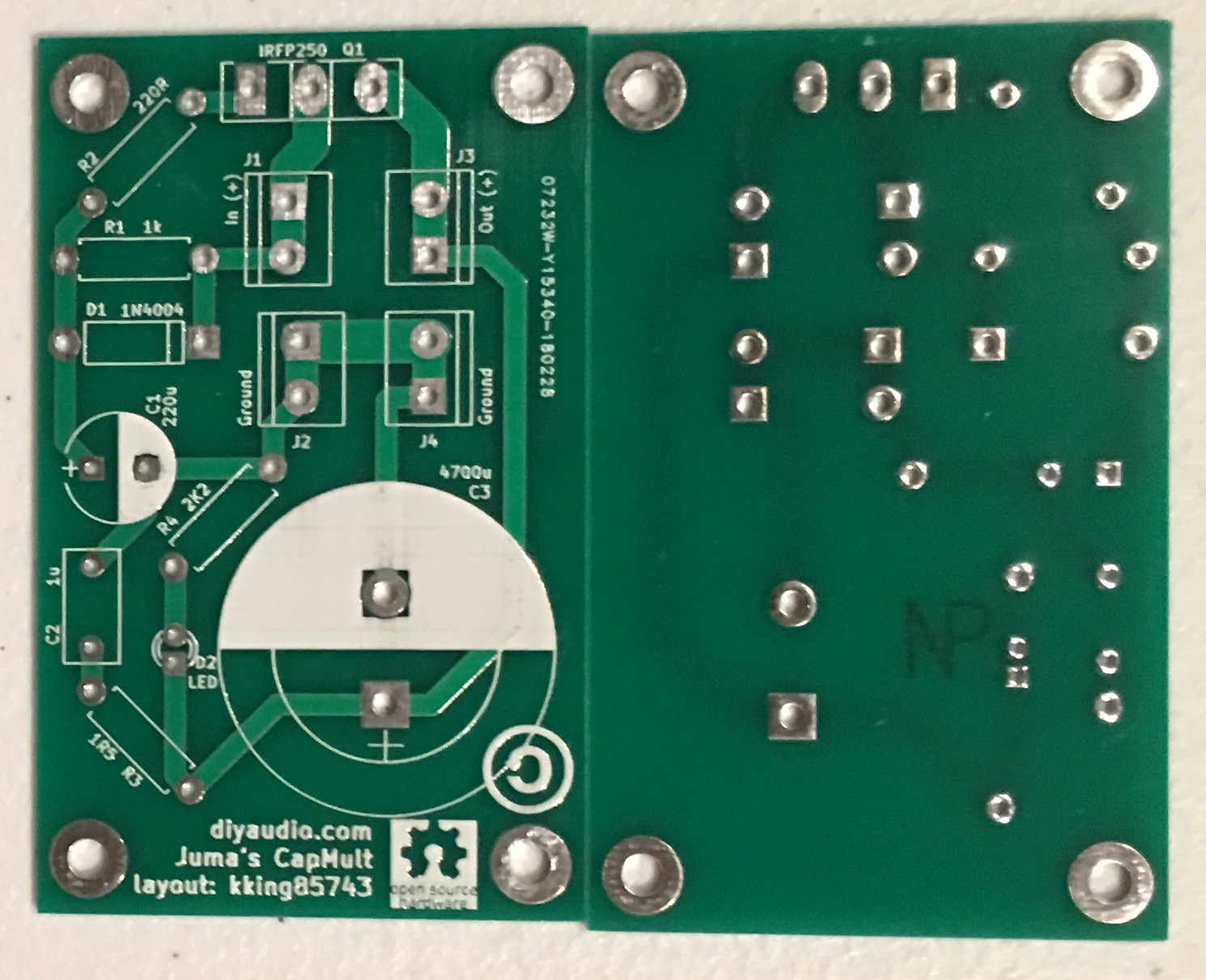

Well, it's finally done. Attached are photos of my boards, but I have some questions…
The AC voltage dropped from 15-12 mV to just at 1mV, as measured by a Fluke 87 V I borrowed from work. Even with the Fluke's leads shorted, the lowest it measured was 0.2mV The 1mV was measured with everything powered up and running, music turned up a little, but not a lot. Is that good enough? 8)

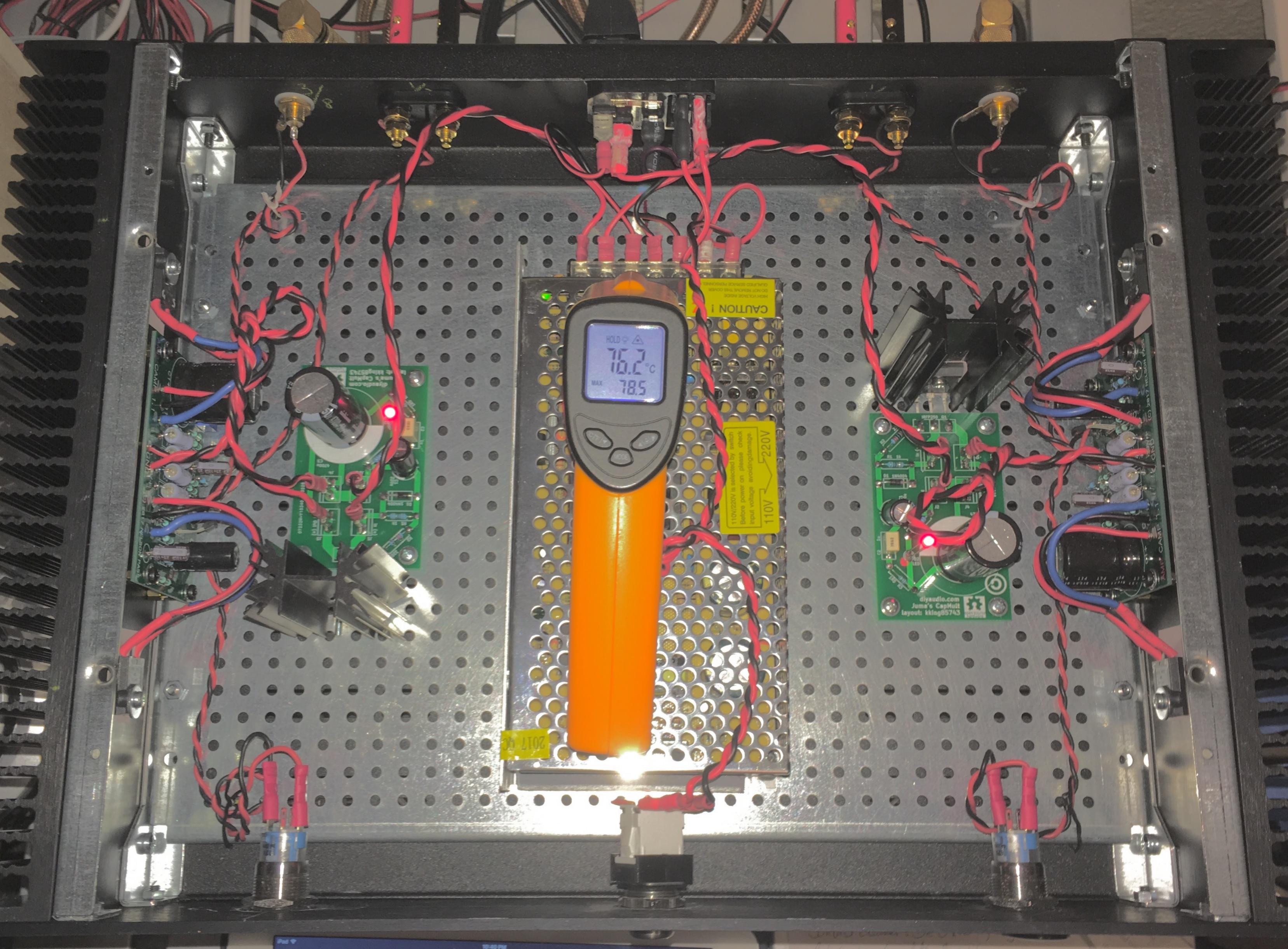

The power supply had sufficient range to get the output power out back up to 24v. The only concern is the heat sinks. They are huge, but still get to 70C in open air and to 79/80C with the lid on. How much of a concern is that? With them passing just 1.5A, I believe they are still well within the de-rate line. They are lined up immediately under the vent slots on the lid for maximum passive cooling.
If I was starting over again, I would scoot the ACAs MOSFETs down enough to bolt the Cap-Mult MOSFET to the monster heatsink. Perhaps I will do so later. The fins only get to 45 at the base and much lower at the tips (2U 300mm deep dissapante case).

You could easily just attach them to the main heatsinks towards the back beside the power amp boards and this allows for shorter cables too - could lift the audio input signal wires well above the re-located CMx to avoid any possible 'noise' transfer
The heat generated by the C-Mx is basically 'VxI' so this is about 4.5v (volts across the fet) x 1.5A (guessing the current thru the ACA) = approx 7watts and on the main heatsink, this won't make much difference but will keep the fet much cooler
You don't really need the big cap on the o/p of the C-Mx as there's a big cap already on the ACA board - just saying ...

Or even bend the legs on IRFp240 90 degrees and mount underhung with thermal contact to the steel bottom panel. It’s probably enough for 5-7w dissipation.
I don’t recall ACA having on board rail smoothing cap, big one is output coupler. So leave the one in the cap Mx board. Mounting on 2U heatsink is adding probably 7w too much heat load as that one is at about the limit of 35w already (~1.5amp x 24v). I have 4U and it has about 75w limit.
+1 in Prasi’s recommendation. In fact, I used exact same heatsink on mine and it works in Class A at 1.35amps ea MOSFET and two per heatsink or about 12w per sink.

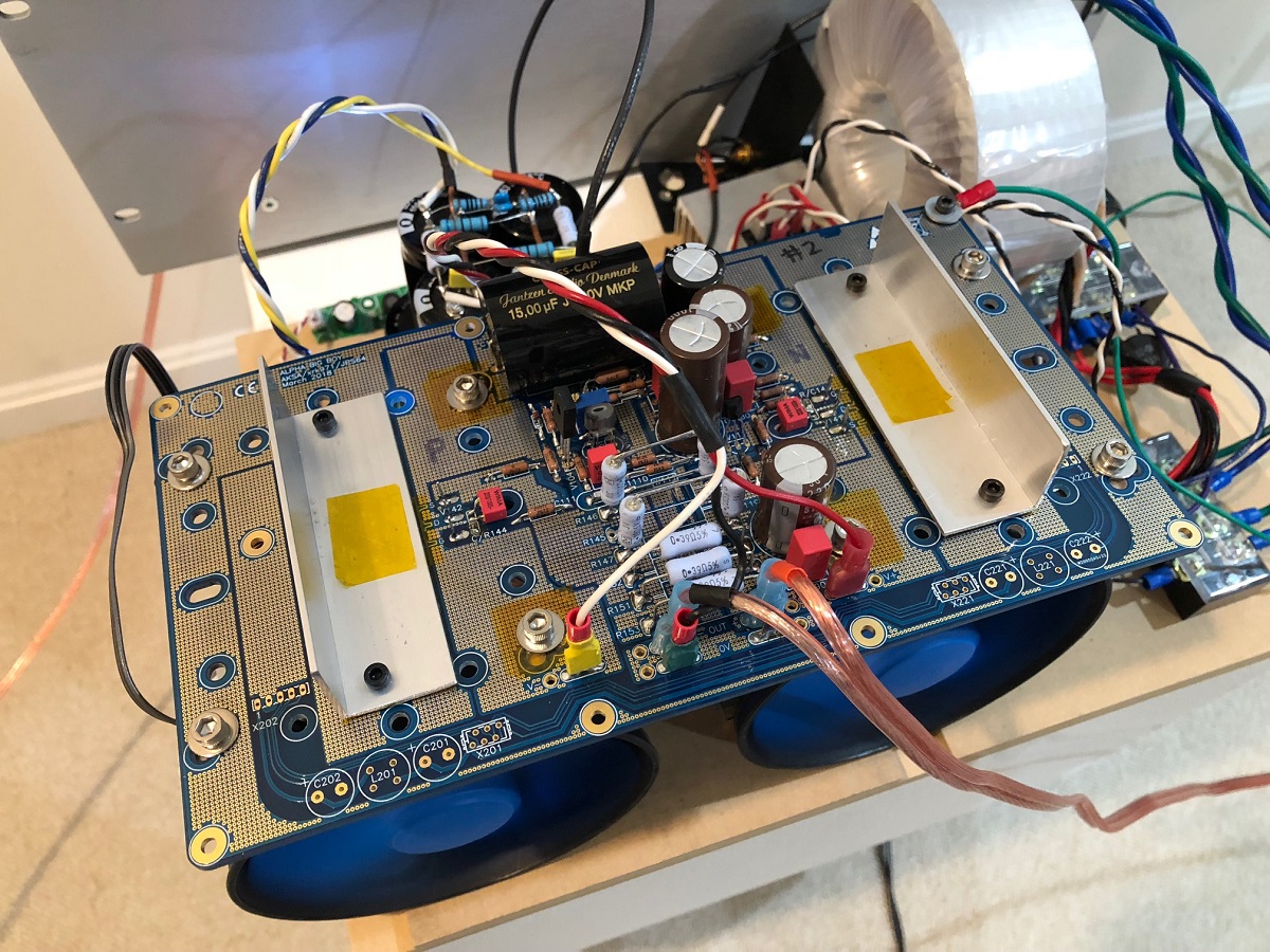

Hi Prasi,
Alpha Big Boy (52w) is running on traditional 400VA linear trafo and CRC-CRC as current is 3amps and rails are +/-35v. It’s running beautifully - zero adjustments and bias is rock stable and DC offset is 0mV to 8mV from cold to hot. Here is channel 2 just fired up. Now need to make another PSU before I can listen in stereo.
672942d1522816977-aksa-lender-mos-hybrid-aleph-alpha-amplifier-alpha-bb-2-build-sound-jpg
No scary heat or temps at all. “feels like a 50w Class AB” amp since temps at MOSFET body are 37C and heatsink fins are 27C. Fans at minimum 10% speed for quiet operation.

To make room on the main heat-sinks, I would have to rearrange (ie re-drill) the holes). For me, this isn't a big issue, as I have the MOSFETs on short wires, so I'd probably move the ACA boards to the baseplate and mount just the heat generators to the heat-sink.
Based on basic heat generated (and current leaving the circuit to go thru the speaker instead of the amplifying device), I'd split the heat sink about 1/6 for the CapMult device, 1/2 for the constant current device and the remaining 1/3 for the amplifying device. When the music is quiet, the amp device will be a little warmer, but the louder you play it, the better off it will be (heat wise). 8)
These devices are already underhung (the individual heat sinks are 2.5" tall!!), but I have plenty of heat capacity, as I got the 300mm deep case, not the stock 200mm deep one. That and I'm only adding about 20% over existing load (which is spread over 50% more heatsink, so I should be fine). Fins are presently running about 43C at the root and noticeably cooler at the tips.

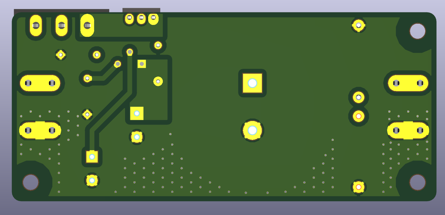

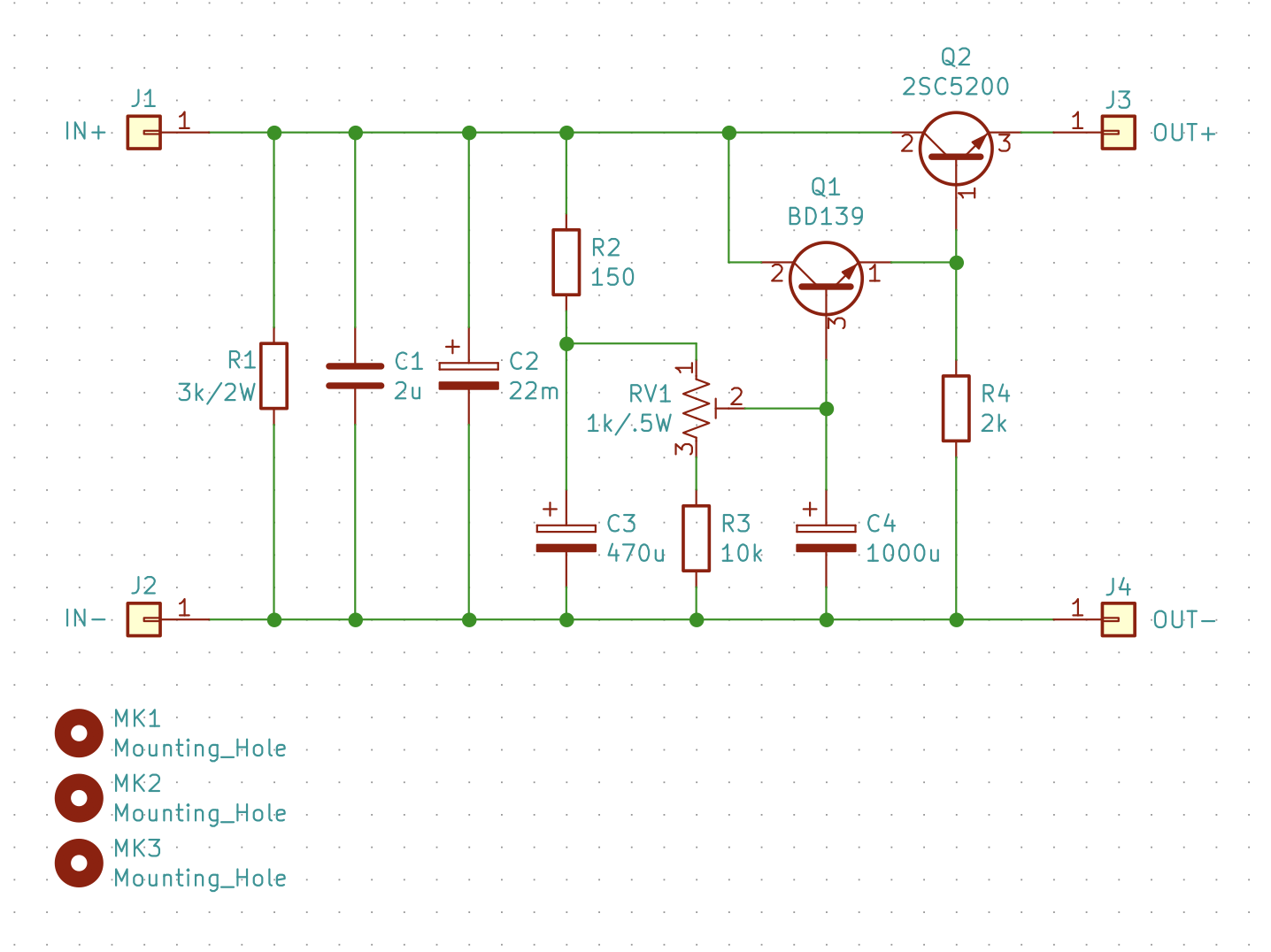

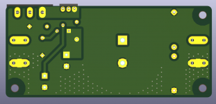

Mark's adjustable BJT cap MX
I am looking to add a cap multiplier after a SMPS for my Mofo build. Unfortunately, the SMPSes I have will only provide about 26v until going into over voltage and I am looking to run the Mofo at 24v. The 4v dropout of the circuit discussed here will not fit my needs.
In looking for something with a lower dropout, I started digging into implementing the circuit proposed by Mark Johnson at http://www.diyaudio.com/forums/soli...asy-capacitance-multiplier-4.html#post4858155. I have also taken into consideration AndrewT’s suggestions at http://www.diyaudio.com/forums/soli...asy-capacitance-multiplier-6.html#post4861961, implementing a 1K, single turn trim pot in series to ground with a 10K resistor for R2/R3 as to not exceed the power handling of the trim pot.
Other than that, I increased the C4 to 1000uF since physically, they are similar size-wise and in simulation it shows a drop in Vpp with the increased value. I also added a bleeder resistor and bypass film cap for C1.

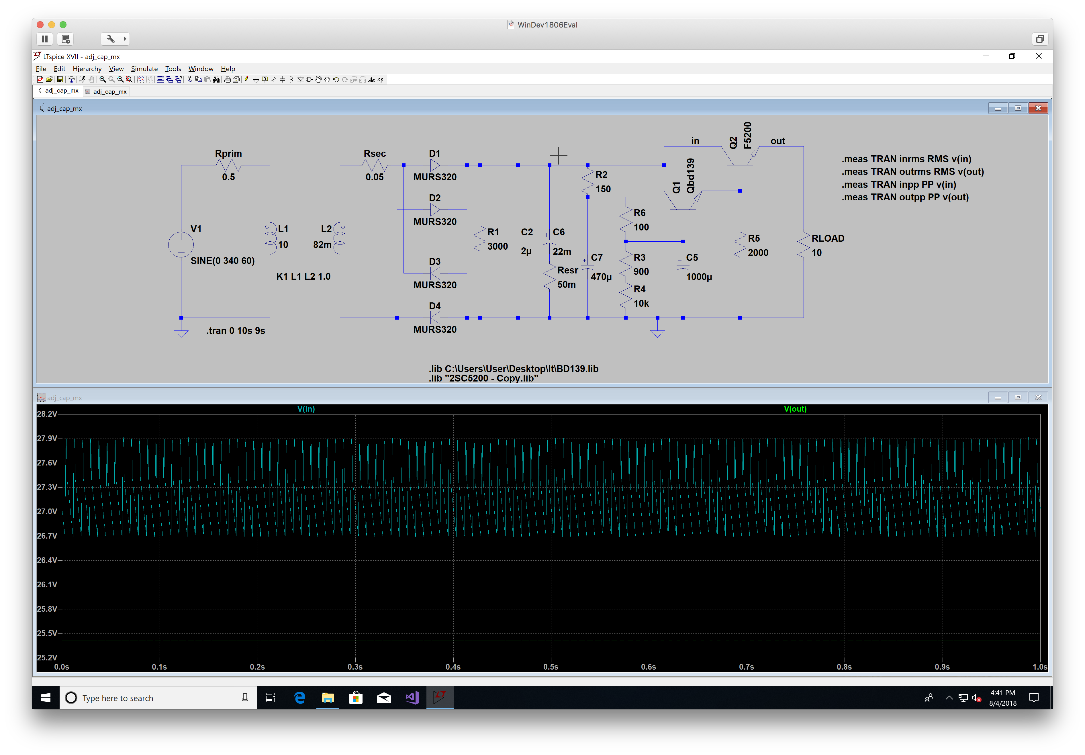

Below are my simulations of the dropout at various resistance ratios for the variable resistor (R6/R3 in the simulation) at about a 2.5A load. This is my first time playing with LTSpice, please let me know if anything seems woefully off!
attachment.php
From this simulation, I got the follow Vrms and Vpp for differing R6/R3 ratios:
inrms: RMS(v(in))=27.1781 FROM 0 TO 1
inpp: PP(v(in))=1.22991 FROM 0 TO 1
with 100/900:
RMS(v(out))=25.4105 FROM 0 TO 1
PP(v(out))=0.00274277 FROM 0 TO 1
with 500/500:
RMS(v(out))=24.3644 FROM 0 TO 1
PP(v(out))=0.00278091 FROM 0 TO 1
with 900/100:
RMS(v(out))=23.342 FROM 0 TO 1
PP(v(out))=0.00276566 FROM 0 TO 1
This shows the dropout voltage changing accordingly, however the Vpp does not seem to differ much. I very well could not be measuring these data points correctly, perhaps Vpp is not the correct measurement for ripple here?
Finally, my implementation is shown below. Let me know if there are any concerns with my schematics, interpretation of Mark’s idea, or flaws in my layout.
Schematic:
attachment.php

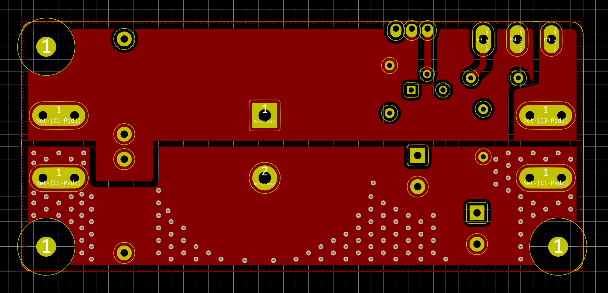

Top Copper:
attachment.php

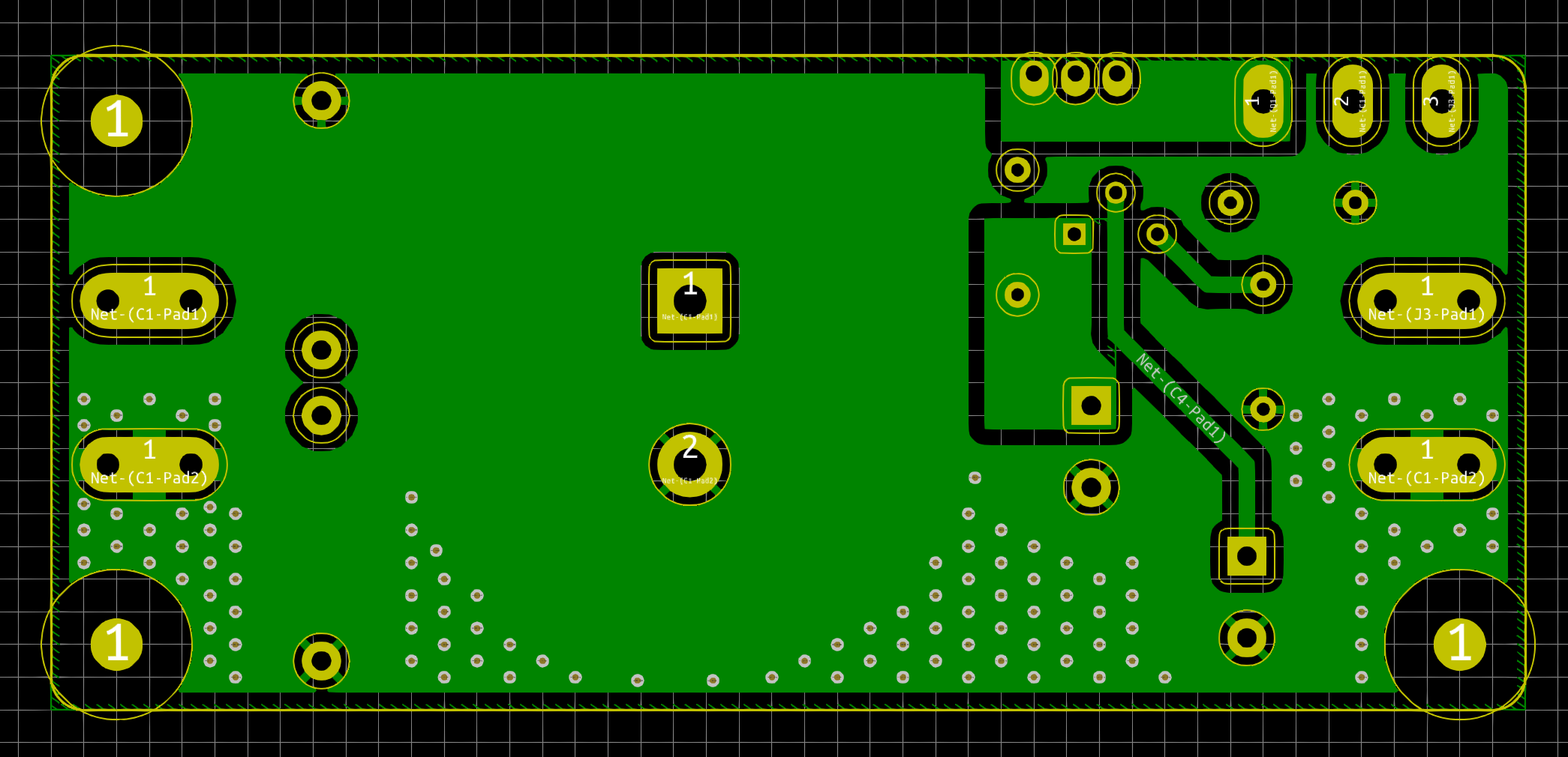

Bottom Copper:
attachment.php

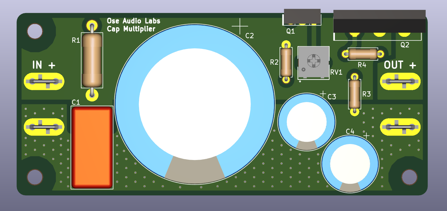

Rendering:
attachment.php
attachment.php
The PCB is 90x40mm with mounting holes at 82x32mm.
DigiKey BOM: Index - My Digi-Key
Thank you all for your review, and Mark Johnson for your circuit. xrk971, let me know if you think this would better sit in its own thread.
