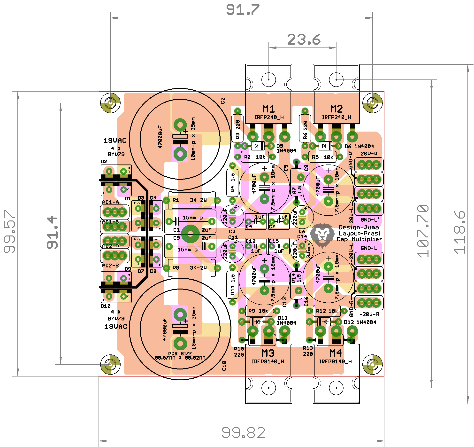

Hello Fab,
Post 280 gives the gerbers.
I have it shared also on pcbway where you could order the PCBs OR download the gerbers along with sch , stuffing guide, link to mouser BoM example (made for DIYA user Juntuin for 24V output), etc.
Here is the link.
W61084ASN2_juma cap multi-R4 EXT DIODES+led+gnd- Share Project - PCBWay
Regarding board house preference, I now prefer pcbway. They are top notch, with excellent customer support.
EasyEDA now no longer supports manufacturing and direct you to JLC pcb. For one of my orders (DLH amp), the silk was not properly printed by JLCpcb.

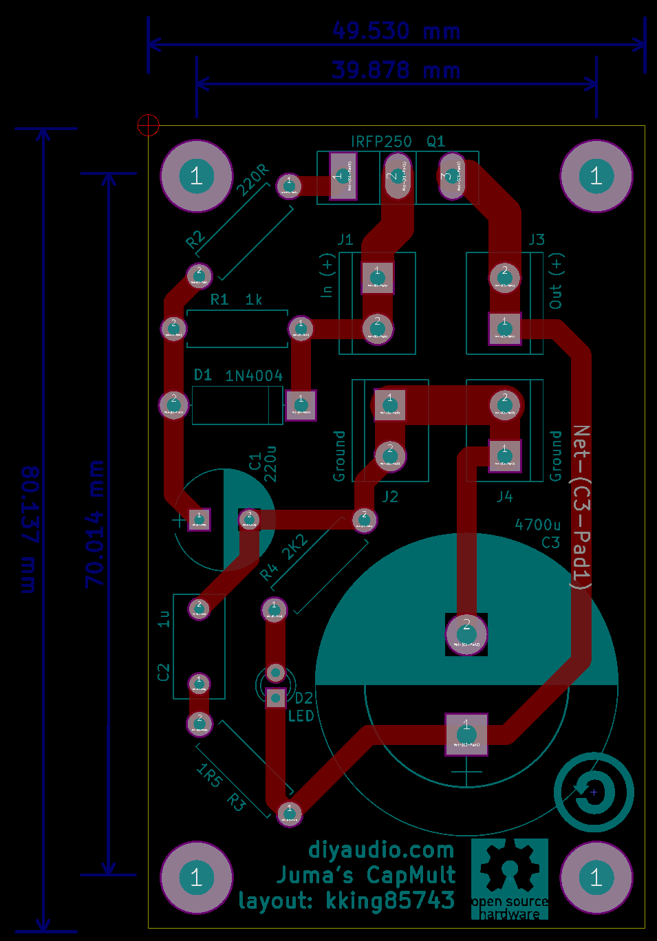

Prasi - Thanks for the help. I tried Eagle, but got frustrated with it quickly. I imagine I'll learn eventually.
@Skylar88 - I tried KiCad, and with a little struggle ended up with a reasonable looking board.
My attempt at the CapMult is nowhere as compact as some here, but it's a single supply solution that fits 2 per 100mm sq boards.
- It has 1.5mm traces for the rails (and kept as short as I could manage).
- The traces for the 4700 are 1mm and the rest are 0.25mm. I have no idea if any of them are sufficient or not.
- The plan was to have bare copper on the bottom, silk screen on the top, and reinforce the power traces by soldering a bit of wire on top of the trace to increase the cross-sectional area (and therefore the power handling).
- I tried to leave a fair bit of space around the MOSFET so it could get a reasonable heat sink on it.
- the holes are just under 40mm across and just under 90mm on the long axis, so they should bolt into the standard 1cm grid.
- the big cap is way bigger than necessary, it has a 30mm diameter footprint, but better safe than sorry. I didn't check to see if the 30mm caps had larger lead spacing... I'll have to look into that.
- Any thoughts on the part layout or trace sizes/widths?
- I also could use some help figuring out how to officially mark the edge of the board (you can see that it's just in the silkscreen).
- Also, did I define the holes correctly?
- What other things can you spot that might need to be fixed before taking the plunge and getting some made?
kking85743,
WHy dont you try sprint, its very easy and within an hour you will be able to make a workable layout.
Regarding your current PCB, please find my below initial comments.
1. Its better to keep together input and its gnd. similarly output and its ground.
2. make traces as thick as possible.
3. You need a proper heatsink for the mosfet, so think and position you mosfet accordingly.
4. keep the components connected to gate as close as possible to gate.
long way to go. but you will eventually get there. Keep it up!.
regards
Prasi
The 5W resistors are across the big 47mF caps are the capacitor discharge device and diode damping load, yes?
The photo shows "MILLS 30" on the lower resistor - perhaps they aren't actually 3kR but maybe 30R and that would sink about 13W
Hi Jameshillj,
You were exactly right!! But even worse, they were 3R!! When I remove them from the board and measured them, they were toasted.
I got into trouble because I ‘assumed’ the label on the bag that said 3K was correct. And we all know what happens when you ‘assume’
Totally my mistake, I should have measured them. I didn’t have any 3K resistors on hand, so I put two 1.5K resistors in series underneath the board.
The Juma E-P capMx works as it should now

Thanks for the input.
Questions arising from your responses:
(1) For small signal, keeping signal and ground close is critical. This is for a 24v power supply, and at 1.5-1.7A, I considered the shortest path for the high-current flow to be a more critical issue. Any thoughts on this trade-off?
(2a) "...as thick as possible." True, I keep forgetting circuit boards are a subtractive process. Will 1mm be a reasonable size for nominal traces? Should my 1.5mm power traces be even larger? Your ground bus up the middle of your dual polarity power supply board does look quite impressive in its width.
(2b) On a related note, at 1.5-1.7A, how wide should a trace be? I know it depends on how thick the copper is, but I don't have any idea how to find out (or specify) this parameter. I considered keeping screening off those traces and laying a wire over it and soldering it down, to increase the cross-sectional area of the trace or soldering on a wire across the bottom from point-to-point to share the current load. Or am I killing it to death? 8)
(3) I thought I left a reasonable amount of space around the MOSFET. How much more would you have left? I presume I'll be using a fairly simple (if heavily finned) heat sink (see note below). I have 15mm of space between the front of the MOSFET and the big cap (I drew a 30mm part to make sure there was some room, but am using a 20mm part, the smaller circle), and "infinite" space on the side where the sink actually bolts (presuming the spade and screw at the top of the board prove to be no issue).
(4) How close is too close? By my measurement, from the input there is 15mm of copper to the diode, and an extra 7.5 to the resistor. On the other side of the pair is 7.5 from resistor to diode, and another 7.5 to the gate resistor, followed by 10mm to the gate. Since the diode is an escape valve for the cap, the actual signal path is 2 resistor lengths plus 47.5mm of copper. Does that really make a noticeable difference? Redesign options include swapping diode and resistor (15mm shorter path), sliding that pair closer to the input, and rotating the gate resistor to horizontal and moving it to be just below the gate, shortening both the R-G copper trace and the R-R copper trace. Overkill?
Additional questions:
- One of my earlier questions was about how big a heat sink was needed, and I never really got a particularly useful answer... I'm using the following figures as my starting point - 8W to dissipate, T.max 60C, T.amb 35C (inside the amp case); so 25C rise for 8W and a TO-247 case. Based on that info, it appears that this ( https://www.digikey.com/product-detail/en/ohmite/RA-T2X-51E/RA-T2X-51E-ND/2416489 ) is sufficient, as it says it will go up 20C while dissipating 8W at a claimed Tr of 3.5C/W, with others showing greater efficiency. It is only about 25mm thick, presuming half/half split, it comes 12.5mm towards cap from back of device, so (allowing for thickness of part) comes about halfway to the big cap (7.5mm away). That gap can be made larger by leaning the device away from the cap.
- Plan B for the heat sink is to move the MOSFET to the top edge of the board and bolt it the base-plate of the amp and hope that the airflow up from the slots of the bottom cover is sufficient to keep things cool. I'm using a 2U Dissipante case with baseplate.
- How much tighter would you pack the parts? I have about 7.5mm between most pads at closest. I've seen some packed in at 5mm between, but how close is too close? I'm as much concerned with solderability as with proximity issues (thermal, overall packing of stuff, etc...)
Any additional thoughts or ideas based on these additional questions?

Thanks fo the info and for sharing
Aside the fact that the pcb size could be bigger, any reason to not include fast transient soft recovery diodes as rectifier - which should have been great, at least for me....
Fab
I would go along with whatever you wish.
Steve.
Since it is for high current power supply I will go for 2oz copper , 2mm thick and gold immersion. Black color also because peoples like that from feed-back I have already received for other pcbs...
Anyway, the big cost drivers are the shipment and duty taxes for small quantity ordering...
Fab

latest updates to the board:
(1) power in/out as close as possible.
(2) all traces are 2mm, except power to/from MOSFET, which are 3.3 and the buss between ground lugs, at 4mm. How thick should they be? How does one specify thickness of copper?
(3) with the MOSFET on the end, it can be bolted to the chassis or left standing with tons of space for any heat sink.
(4) Things are now closer, how much more should I squish things, or is that good enough for now?
Any other thoughts on cooling for the MOSFET?

Hi Vunce,
Glad you could sort the issue.
you made the poor little resistor dissipate almost 250w. RIP.
Did you find out about the transformer. Are you able to solve it?

Greetings Prasi (and anyone else who wants to chime in):
After the latest updates to the board (using KiCad), here are my responses to your initial comments (above), along with some additional questions: (Images of the latest board spin are available on post 430)
(1) power in/out as close as possible. Do they look close enough (10-15mm)? However it makes some other traces a bit longer (specifically the output capacitor). What do you think of the tradeoff between proximity of the power leads compared to the length for some of the other traces?
(2) all traces are 2mm wide, except power to/from MOSFET, which are 3.3 and the buss between ground lugs, at 4mm. How thick should they be? See the info (below) on the current vs temp increase for the different widths. How much heat gain on a trace is "reasonable"?
(3) with the MOSFET moved to the end of the board, it can be bolted to the chassis/heatsink or left standing with tons of space for any heat sink. The mounting should work with the 1cm "standard" grid. See additional thoughts/questions on the thermal aspect of the MOSFET below.
(4) The path to the gate is now shorter. How much more should I squish things, or is that good enough for now? The present path is: power input to resistor, to resistor, to MOSFET pin, for a total distance on board of about 20mm of copper traces and two resistor lengths.
On cooling the MOSFET:
- I'm using the following figures as my starting point - 8W to dissipate, T.max 70C, T.amb 35C (inside the amp case); so 35C rise for 8W and a TO-247 case.
- Based on that info, it appears that this ( https://www.digikey.com/product-detail/en/ohmite/RA-T2X-51E/RA-T2X-51E-ND/2416489 ) should be close, as it says it will go up 40C while dissipating 8W at a claimed Tr of 3.5C/W. There were also other heat sinks available showing greater efficiency.
- Plan B for the heat sink: lay the MOSFET down and bolt it the base-plate of the amp (or to a heat sink, although the space inside my case doesn't support this). In my case, that is to a galvanized steel baseplate and relying on the airflow up from the slots of the bottom cover to be sufficient to keep things cool. I'm using a 2U Dissipante case.
- Any other thoughts on cooling for the MOSFET?
On trace sizes:
From: The CircuitCalculator.com Blog >> PCB Trace Width Calculator (see the web page Comments section for a discussion of the limitations of the calculations due to limits in the paper on which they are based)
Legend:
- Current is in amps, flowing on the trace
- Temp Rise is in degrees C, how much warmer the trace will become at that current
- Width is trace width in mm (on my board, power is 3.3mm and the rest are 2mm)
- 1 oz Copper is the default
MOSFET to/from power connectors
Current Temp Rise Width Temp Rise at same Current for 4mm trace (ground buss)
2.8 2 3.30 1.46
4.2 5 3.31 3.6
5.7 10 3.31 7.3
(still having trouble with tables - in short 5.7A on an inch long 3.3mm trace at 1 oz thickness results in a 10 degree rise in temp, 4.2 amps results in a 5C rise, 2.8A gives a 2C rise, so the expected 1.5-1.7A should be trivial)
output capacitor to/from power connectors
1.95 2 2
2.9 5 1.99
4 10 2
(still having trouble with tables - in short 4A on a 2 inch long 2mm trace at 1 oz thickness results in a 10 degree rise in temp, 2.9 amps results in a 5C rise - no idea what current might flow here - probably only short bursts to support sudden volume increase or hard-hitting bass)
The page indicates that a 10C rise is considered quite reasonable, but I was wondering what others think. The calculations are extrapolated below 10C, as that was the baseline for the data retrieved in the paper cited as the source for the calculations.
Any thoughts on peak/surge currents? My simulations didn't show much change in currents even with on/off switches, so I'm not anticipating much, but don't know what I don't know... Note this is for supplying power to an ACA, so it's a Class A, with limited current swings.
Final thoughts on shape/size:
The overall shape of the board matches my needs, as I have long thin spaces on the baseplate available for the boards (one per channel) and was trying to stay under 100mm for two boards. I am thinking about trying an additional layout that might be able to mount on a 2U heatsink. I'll post here if I decide to give it a shot.
Hello king,
Why all that copper needs to etched away? If you retain more of it, the less etchant it needs. What I learnt here through distinguished members, is its just not the current capability of trace, but also inductance.
regarding cooling and heatsinking, see jameshillj post, allow for 25 deg rise over ambient with ~8W dissipation.
Also , in most cases, the chassis space is at a premium with lot of different modules and PCBs, so I try to keep my designs compact and which is also cheaper to manufacture.
All the best.
