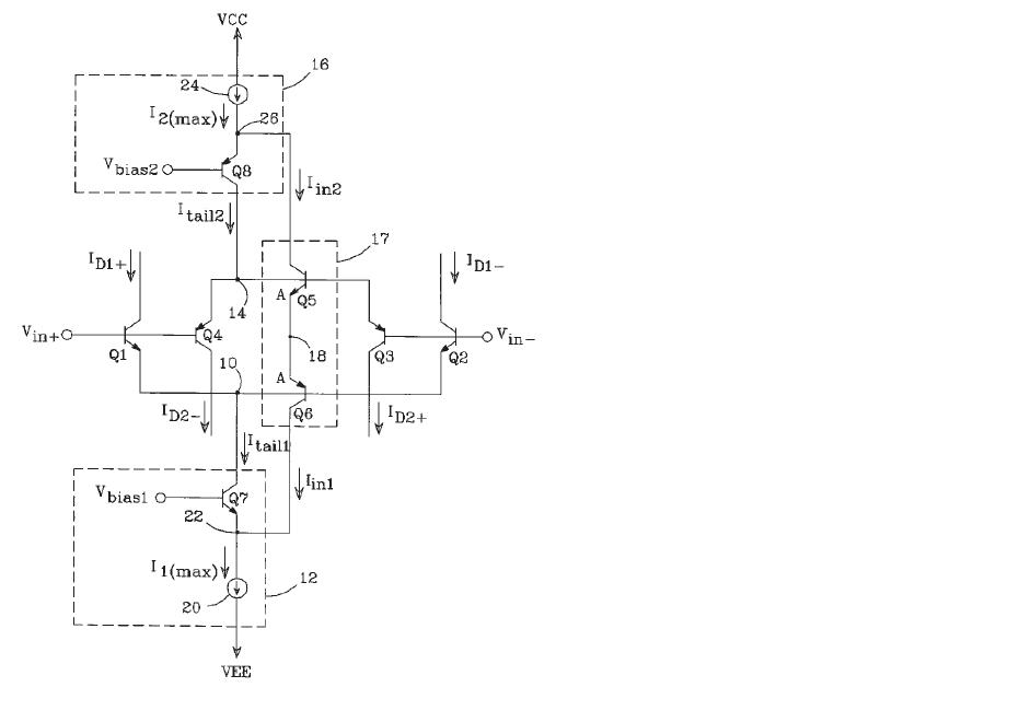

Well, back to business, (hopefully). Scott, you mentioned TANH approaches to linearizing input stages in solid state designs. Any recommendations of this approach that amateurs can use, and that do not generate excessive amounts of higher order distortion in trade for lowering lower order distortion? A few weeks ago, I attempted to get SY to post a page from Gilbert's '98 article on the subject. Unfortunately, SY has been unable to do so, so I am again stuck with info that I cannot put up myself. A picture might be worth 1000 words, but I am stuck with just words at the moment. Sorry about that, everyone. I have little choice.

john curl said:Well, back to business, (hopefully). Scott, you mentioned TANH approaches to linearizing input stages in solid state designs. Any recommendations of this approach that amateurs can use, and that do not generate excessive amounts of higher order distortion in trade for lowering lower order distortion? A few weeks ago, I attempted to get SY to post a page from Gilbert's '98 article on the subject. Unfortunately, SY has been unable to do so, so I am again stuck with info that I cannot put up myself. A picture might be worth 1000 words, but I am stuck with just words at the moment. Sorry about that, everyone. I have little choice.
You can always e-mail it to me, John. I do mind judgments of personal qualities, but I don't mind judgments of technical solutions, as you know.

As Wavebourn said there is more than one way to skin a cat. Here is the AD8099 input linearizer (which does NOT compromise the noise unlike the tanh technique), US6963244. You would like Nathan a lot, he was at the Bongo dinner too . You probably need to read the patent for a full understanding. This was one of two techniques in house and his won.
