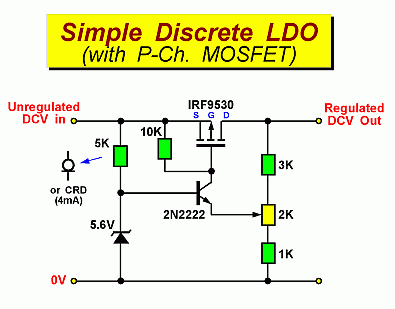

Hello, Pavel,
Yes, it would have been what I would have done if I was John Curl himself... And I know how far your advice is a valuable one !
But John used too little parts (as seen on the bad pics).
I would just advocate a scheme like the attached one, with perhaps
2 low voltage Zener diodes seried (remember John's course about them?) in order to get approximately a 6V... 6.6V reference... Just running experiments here to see if the "Zener zone" noise is easier to remove than the "Avalanche zone" one... And yes, I know that a LM329 would be far easier to use...
Also, a far bigger Mosfet than IRF, and a SERIOUS resistor to ground BYPASS (I just turn to be more obsessed with RFI you are an expert dealing with..). IMO, the room between reservoir caps and series regulation is the right place to fight against the more poweful, and when it is too tired (some 60 dB attenuated at least), common mode coils would help to remove same phase same amplitude unwanted RFI... Right ?
After the series regulation, should be only DC voltage (or the less AC as possible...). And I really love simple schemes...
Inputs from forumers that have experimented with that are welcome...
Jbaudiophile
