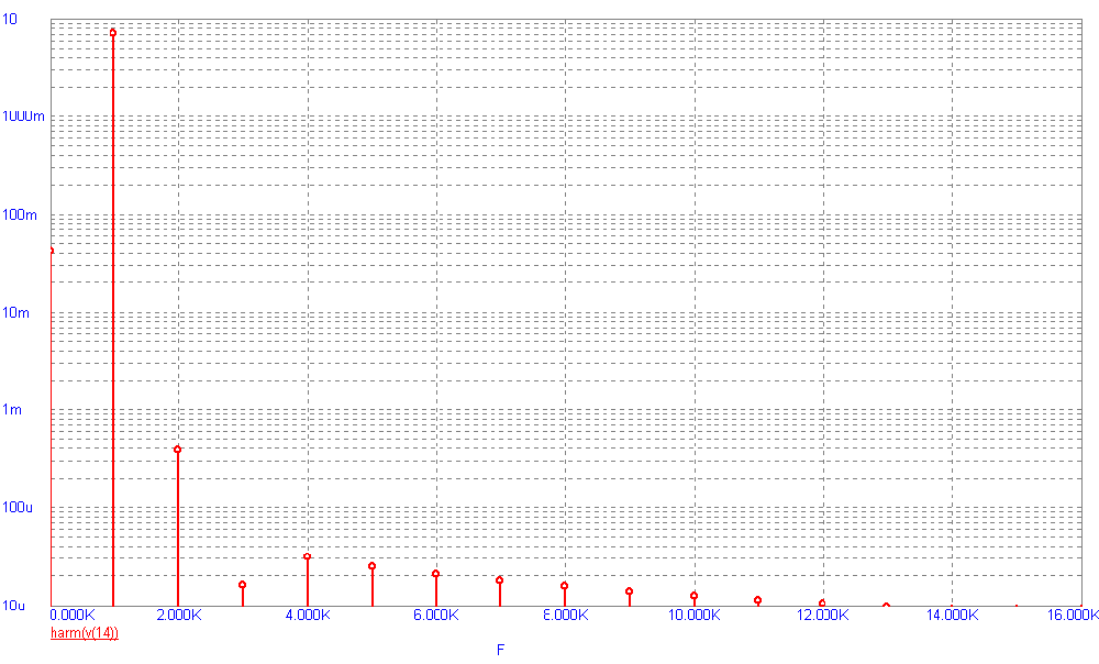

PMA said:How about this one?
Pavel,
WRT your circuit,
It is closed loop, so probably better in it's own thread,
(feel free to start one), but I think it is very good.
The bootstrapped IP collectors is nice approach, I use this
myself often.
Questions:
- What rails are you running
- Would a CCS be better than 30k R's on Q1/2
- How does it measure?
- Is the 10k OP R to limit OLG
Terry
Terry,
I do not feel like starting a new thread. I will briefly reply here.
I have not build that CFB preamp shown, only simulated. It is based on experience with realized power amp:
http://www.pha.inecnet.cz/macura/next.htm
The power amp differs in the end stage, which is a CFP follower. It is a class A non-feedback design and measurements can be seen on the linked page.
Regarding the CFP preamp, I do not plan to build it recently, as I am engaged in active filter speaker project.
1) the rails were expected +/-30V and quiescent current of 50mA.
2) the CCS would probably be better than 30k resistors.
3) according to simulation it would measure very well, but not excellent.
4) the 10k resistor was used to simulate the load.
Pavel
