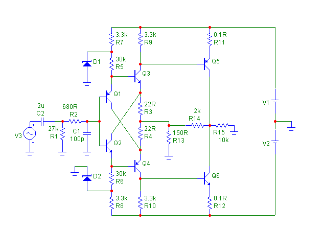

I’m trying to put the ideas gathered here to work (serie reg + CCS + shut reg).
I still use the basic Curl follower running under switchercad. I think this circuit is both less sensitive to the psu and “harder” to the psu than the symmetric folded cascode we are talking about here. Sorry If I’m lagging ideas by Richard and allied…
How can I improve the line regulation provided by the simple shunt reg ? I imagine that higher gm transistors would help (which ones?). At about 100ma the gm of the irf640 and irf9540 are just a bit above 1S. Regulation is quite similar to the one provided by a .85ohm internal resistance voltage source.
I can obtain a slightly more linear regulation in high frequency with a small (about 470nf) in // with the reg. It also helps to eliminate the overshot one can see with square waves (I think that Richard published them a while back). Funny, John says “no cap” and he must have good reasons.
A “massive” approach to passive filtering, 3 cells composed by a 10ohm resistor and a 47000µf 1nH ESL and 3mohm ESR cap (I hope these values are realistic), provides a much higher attenuation in most of the audio frequencies and above, but this attenuation is changing with frequency and there is a severe bump at very high frequency (due to very low esr ?). I know that only the last cell is useful in term of regulation.
The active reg shines in terms of line rejection. I probably obtain one more time meaningless results because real live noise masks the simulated behaviour that lies at impossibly low levels. Anyhow, I think that the curves are interesting. For instance, you have a less acute peak in HF using 3 different caps in the passive way and you can see the interest of multiple cells.
Any help and comment gratefully welcomed.
Philippe (who as difficulties to explain himself in English and whose mail is broken :-/).

I want to refer to Richard's schematics.
Would it not be better to use a voltage reference or LED's (to replace e.g. R5) in combination with a CCS diode like J511 (to replace R1) to bias the MOSFETs ?
I expect at least better PSRR ??
Patrick
As I said in an earlier post, each time I have tried a current source I came back to a resistor, I really don’t know why, but of course replacing a CCS by a resistor implies generally a “perfect” power supply. If you replace R5 with a few leds you need also a resistor in series with the Mosfet gate to avoid peaking at high frequencies, moreover sound get worse, but i can't totally explain this too, maybe someone here?

Patrick did you tried something like this in your output stage:

> Patrick did you tried something like this in your output stage.
Richard,
Have not tried (still trying to get Toshiba MOSFETs), but this is actually very similar to the original output stage of Borbely, which is based on Hitachi MOSFETs. (Since it is his circuit, I am not going to post it here. Please check his website.)
This is the easy and obvious solution. But there is good reason why I would want to bias the MOSFET independently from Stage 2. (Check you private email.) And I think an independent unity-gain MOSFET follower circuit can be put to good use elsewhere. Just see how many people use BUF634 for audio.
So I hope someone can still come up with a better solution than my post #779, which I do not find elegant enough.
