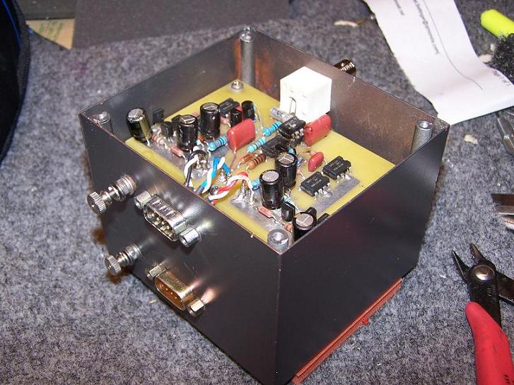

MikeBettinger said:
An excellent solid copper enclosure using 4" X 9" 40mil thick copper sheets that can be purchased in hobby stores (Small Parts inc also sells sheet copper). I use a dremel and their 409 cutting blade to cut the various panel pieces without distorting the edges and then sweat solder the joints using plumbing solder and a propane torch. With a bit of planning you can drill the holes for connectors and pcb mounting hardware in advance. If it wasn't for the need to connect to the outside world you could fill it full of nitrogen...
I recently built a MC amp enclosure that turned out quite nice. I'll post a picture this evening if I remember.
Mike.

I made a vase in elementry school by shaping really thin copper foil, and then electro-plating copper onto it. You can get the copper sulfate in a pet store (used for aquarium fungicide). It took a while to get around 5mm thick, it was ages ago so I don't remember exactly how long it took. If I ever make my own pre-amp I think I'll do something similar.
Cool! I don't think it would be strong enough to mount connectors on, but then again, I haven't tried it, yet...
Here's a picture of my copper box.
Mike
