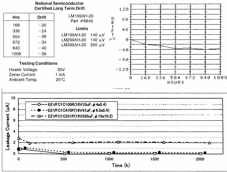

janneman said:I am not aware of ANY reasonably scientific study or measurements that document a genuine burn-in phenomenon, meaning that the transfer function, THD level, whatever you want to use, changes from an initial value to something else during the first few hour, days, weeks, except for mechanical parameters in loudspeakers. The only 'evidence' we have is anecdotal from people saying that they clearly hear the equipment changing after such a period.
Jan, any serious electronics engineer should be very familiar with this "burn-in" phenomenon. Take a datasheet for a precision voltage reference, a precision resistor, a precision crystal oscillator. More often than not these would include some data on what is called a long-term stability. Again, in many cases the most significant change occurs in an initial break-in period of a few hundred hours. As for electrolytic capacitors, even for a cheapest one the manufacturer would note in the datasheet that the parameters shown would be valid ONLY after a certain time with a rated voltage applied.
I enclose a couple of graphs - from LM399 and Panasonic FC capacitors datasheets just to illustrate the point. As you may see, the leakage current may need 100-500 hours to stabilize and so does the reference voltage.
Alex
