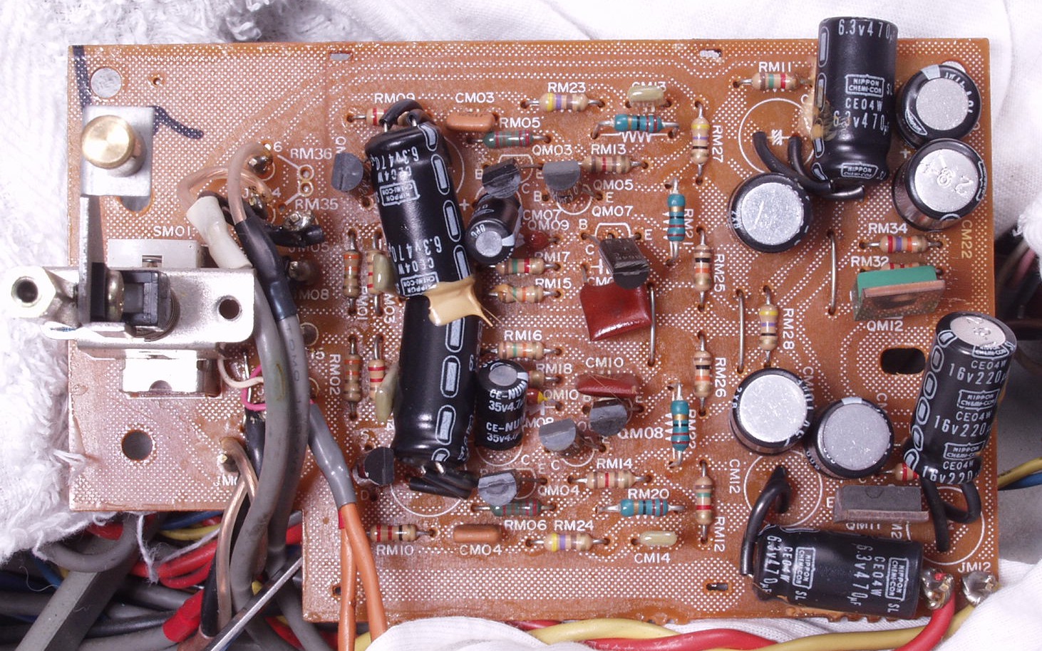

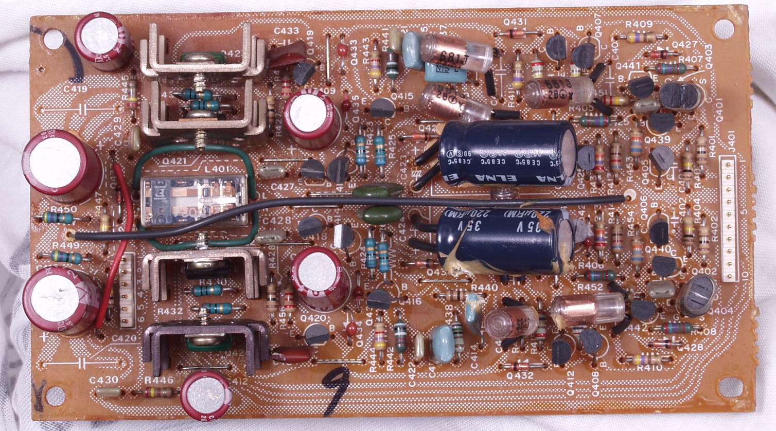

Hi Mike, John,
I'll root around a bit. In the meantime I'll try to post some pics of the phono board itself.
This design would be from the very late 70's when Marantz produced it's best equipment (in my personal opinion). I think it may have been discontinued in 1980. It's notable that the phono board from the 3650 was also used in the top of the line SC-9 also.
I own both. Bad switch contacts on both pieces!
-Chris
-Chris
Phono Eq
MC Amp
I am linking to these at http://amp8.com/tr-amp/marantz/pre_amp/sc-9.htm beware the page is over 20meg.

Now there's a blast from the past... Anyone with there hands in the equipment at the time will feel right at home.
Ya gotta love the phenolic pcb, polystyrene caps with what looks like copper foil. I remember the dark blue and the maroon electrolytics as being very good sounding as electros go. Wire wrap terminations to the boards, carbon film resistors with a few metal films where needed.
I'd love to hear it in my system, my guess is it wouldn't do to bad. Then I'd take the same circuit, give it a decent layout and modern power supply and listen again.
I'm curious as to what the preamp sold for when new. Most likely a very small fraction of stereophile middle of the road stuff these days.
I remember the style of switches seen on the board as being terrible. I got real good at diamantling them and rebuilding them. White plastic pencil erasers so as not to damage the platings and GC high freq contact grease...
Mike.
Mike.

Hi Mike,
Those preamps passed virtually unknown by most. I can't remember the price, but I'm super glad I have them. I honestly have not heard better - yet. I am trying to replace them without too much luck so far.
I cracked one switch in half on my SC-9. First attempt at repair failed. So I'll dive in again when I have the energy. I think you would be surprised listening to them. Other people over at my house have tried many preamps against these and left wondering why they were not better known. Mind you, there was a backlash against Superscope at the time.
-Chris
-Chris

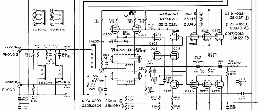

I've tried to come up with a schematic for the SC-9 with no luck. I'm curious as to whether there was something special going on circuit wise or if the execution says something about why it was special. I went to TheVintageknob.org and they had pictures of a couple others in the series. Maybe when you get a chance you or James can post an overall picture of the insides. I tend to be drawn to the oddball stuff. Do you have a schematic?
Thanks, Mike.

Hi Mike,
These preamps (SC-9 and 3650) are combinations of diamond transistor arrangements for buffers and differential J Fet type signal amplifiers. I am very impressed with this preamplifer design.
So far, nothing I have heard comes close. It's really not there in the signal path. It causes the least damage to the signal of any preamp I have heard. The phono stage is very quiet and the highs have no harshness. What more can I say?
-Chris
Edit: The SC-9 is basically a 3650. The volume control is different and the SC-9 adds a headphone amp. The rest is the same.
-Chris
