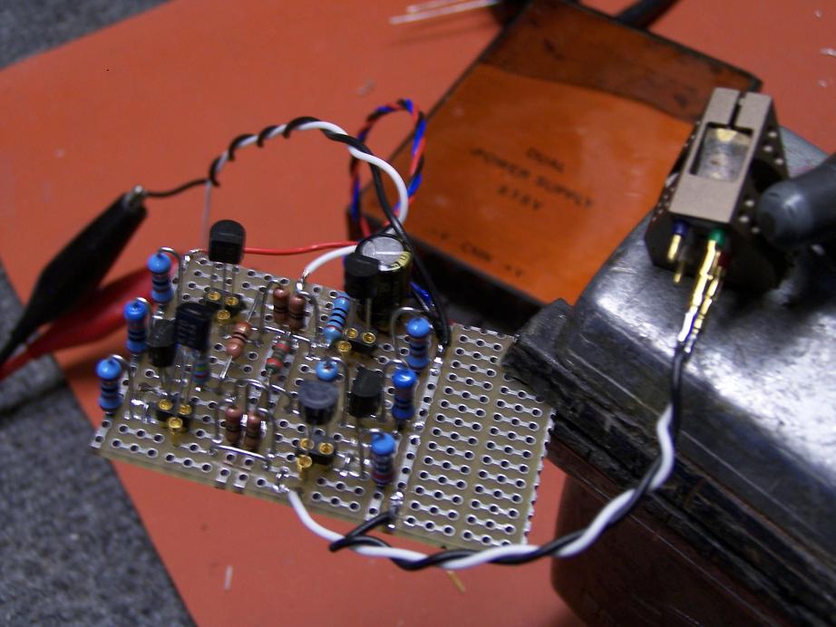

All of the fet input stages I have used have mimiced the commonly used approaches. I'm stepping into new territory with a FET input MC circuit. I'm trying to keep it basic and learn, but still worry what I'll be subjecting my cartridge to. Up until today I assumed that a Fet with a Vp 0f .5 v would respond from 0 to Vp. I guess now that that is not so. I never gave it much thought
The bias you are talking about is accomplished by inserting a source resistor and the Idss raises the source above ground effectively biasing the gate?
Does matching the Idss of a symetrical K and J pair in and input stage actually produce equal bias at the N and P sources? Does one need to control this bias accurately between the upper and lower half?
In my line amp I have the +/- sources in series and floating with no ground reference. I'm assuming this won't work in a MC amp. Am I wrong? I'm assuming that I will need to bias each half to the opposite supply. Would ground work, something like an offset pot with the wiper grounded? Am I worrying about nothing?
Hopefully the questions are not to basic. It's new ground for me.
Mike.

Mike, with a comp diff fet pair, the pairs find their own equilibrium, even if the Idss is not matched between the complementary pairs. However this is not a good approach, because it is possible to forward bias one pair, in order to turn off the other (high Idss) pair, and this could be a problem. The resistor(s) between them gives some turn off voltage drop headroom, and keeps both pairs from accidental forward conduction at Iq.
Trust me, in 1971, when I was first experimenting with this topology, I didn't know if it would work at all. In those days, I first used a current source instead of a resistor, just to make sure.
john curl said:Mike, with a comp diff fet pair, the pairs find their own equilibrium, even if the Idss is not matched between the complementary pairs. However this is not a good approach, because it is possible to forward bias one pair, in order to turn off the other (high Idss) pair, and this could be a problem. The resistor(s) between them gives some turn off voltage drop headroom, and keeps both pairs from accidental forward conduction at Iq.
Hi John,
This is one of the things I am curious about and my experiments today verify your comments. I did not get to the point where I matched the fets but with a random choice I found one of the series pair dominated the Id (I guess in hindsite, obviously).
With 10ohm source resistors the voltage on the positive sources was 58mv, the negative was -80mv. With the two jumpered both sources were at -20mv, which points to the need for the resistors as you stated. No need for a ground referenced offset adjustment if the fets are matched in the same ballpark.
I have more questions, but I'm tired and it'll wait until I can place them in a coherent form.
Thanks for your comments. I feel like I'm going back to basics just to make sure I really understand how these work.
Mike.
