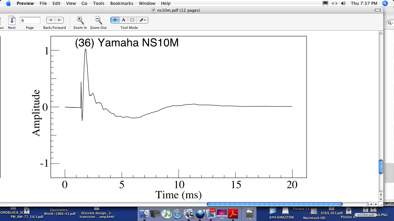

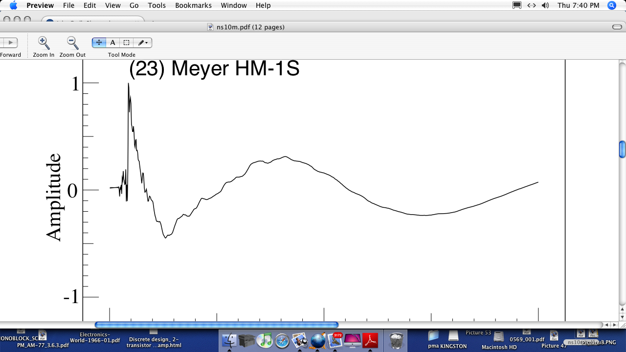

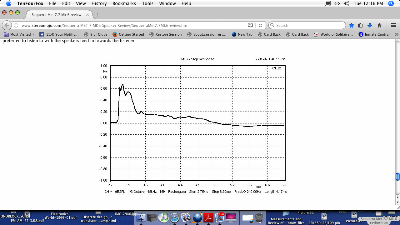

Now for time measurements: Here are three that show that the Yamaha, which is better than many, is not nearly as accurate as the Met 7 or even the Meyer.

Okay, why don't they use Met-7 to mix records, given that they are so accurate as you describe?

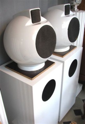

Yes !You might 'quibble' about speaker directivity, but my listening experience tells me that even overall frequency response is not nearly as important as TIME RESPONSE.
And I believe the first designer who had the idea to time align his speakers was Mr Leon,, Founder of Elipson.
More than 50 years ago.
Now, with the active filters, DSP based, we can optimize the group delay without to worry about the enclosures design.

The bottom scale isn't visible for the Meyer. You can't tell much, and the Yamaha seems to have less overhang than the Meyer does. Is the pulse at time zero? If so, the Yamaha is doing very well, not withstanding the fact that I wouldn't want them for speakers to listen to.
Just for comparison, would you have pictures that show each speaker? It would be interesting to see the beast with it's response.

great at one parameter is not as good as great at many parameters of importance. I want it ALL.
