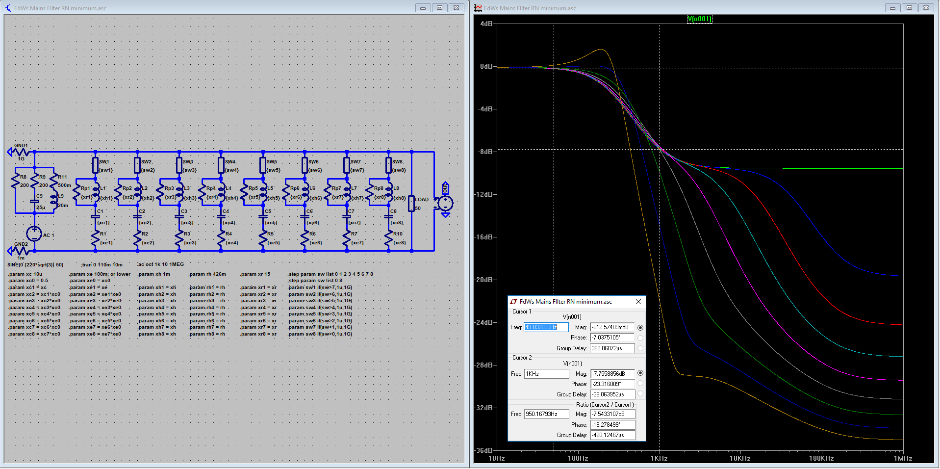

Mains filter simulation results
The first C is 10uF, each following C is halved
All inductors are 1mH
The green line is no filter, each following line adds one network (right[smallest C] to left[largest C])
The 10uF C (or even the 5uF C) are still a bit large to my taste.
Attached is also the simulation source, have fun :)
